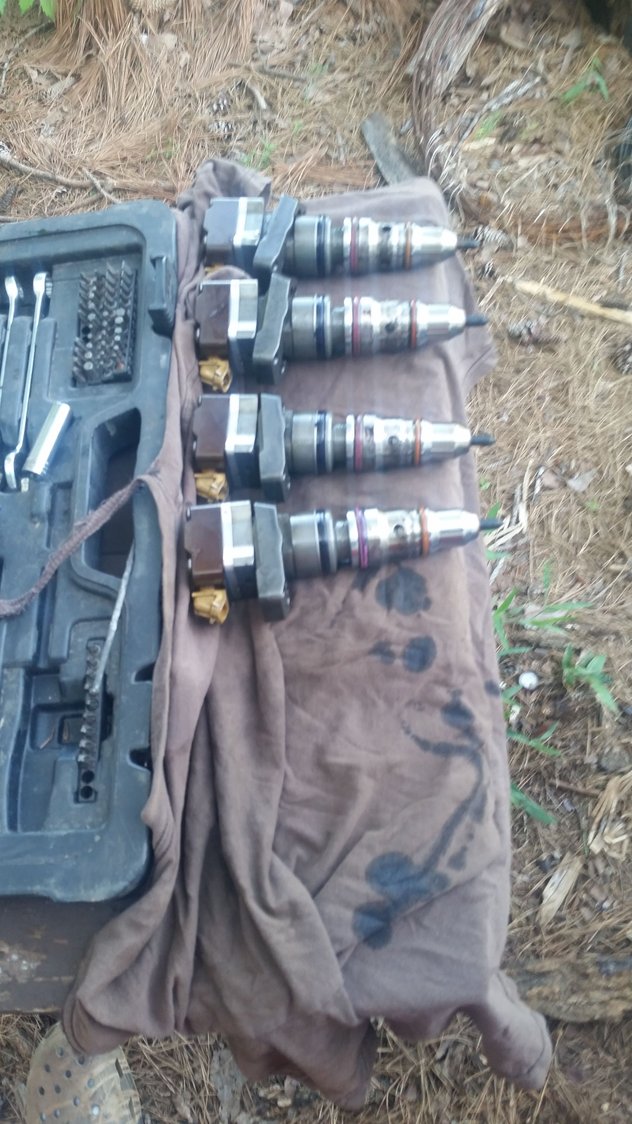

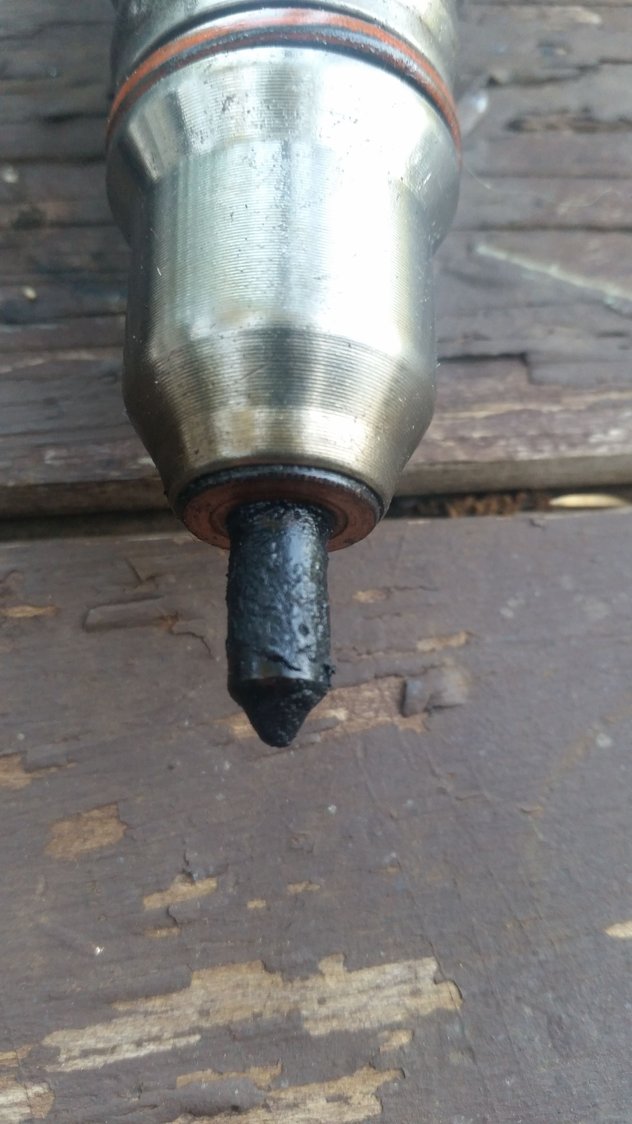

Well... Got one bank of injectors out. The o rings look ok but the tips are really really caked up with black crap... I'm planning on taking a steel brush and steel wool with pb blaster to get it off.. Anyone know of a better way?

DO NOT USE A STEEL BRUSH!!!! You will ruin the tips, use a piece of hard wood if you really think you need to clean them. Something small you can scrap the tips with, but if you can see the nozzle holes there is really nothing you can do on the outside to clean them....

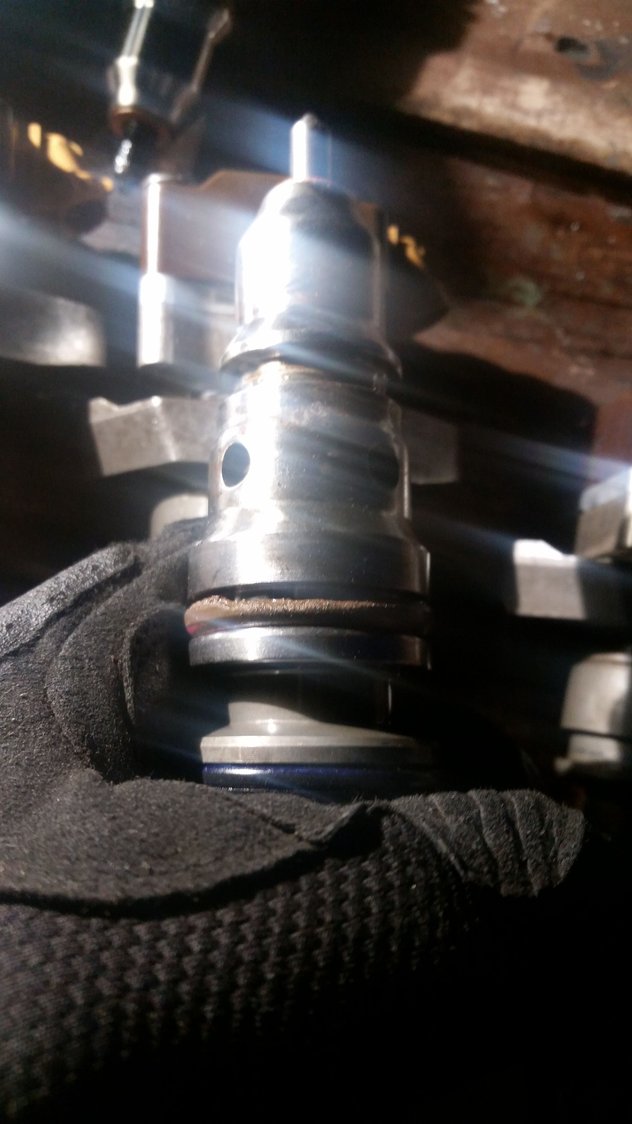

I ended up using a plastic bristled brush to clean them. Worked just fine and didn't leave any gouges that I could see. Here is a pic of what they looked like when I pulled them... What could cause this? Or is this normal?? I can't remember what the ones out of Charlee looked like when I pulled them

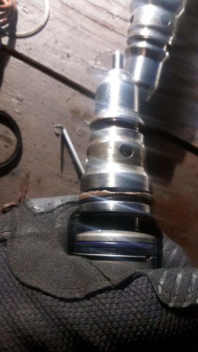

And here is what I believe to be the source of the oil in my fuel bowl....
Four injectors had pink o rings that looked just about like this.
Byron was right... the second time pulling injectors is way easier!

Theres the oil in fuel problem, as for what makes the injector tips look like that I think its because theres excessive timing or low compression, but not 100% on that answer.
