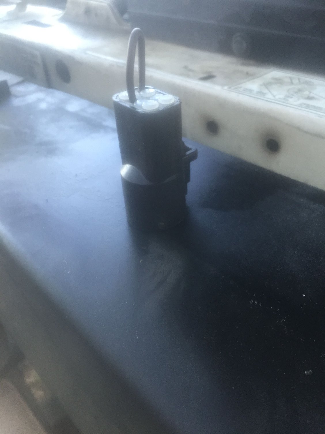

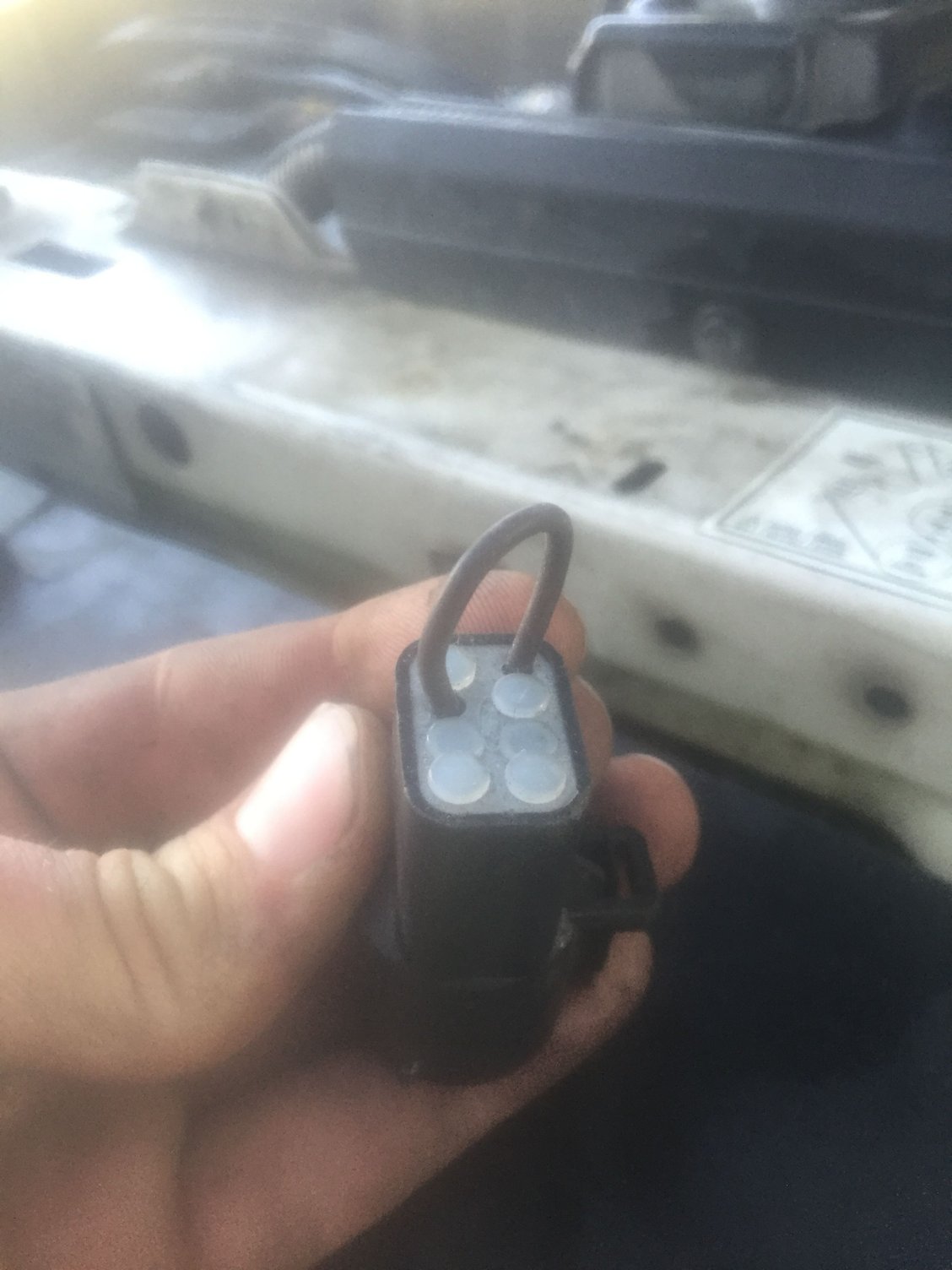

Hey guys finally able to work on brownie. Mud nats down in Jacksonville and well issues kept me busy all weekend. So I got all the gauges off and into the spare parts shelf, and the ts6 chip, grill guard, rear bumper, and headache rack up on Craigslist and eBay.
I came across this plug in one of the map pockets... Any ideas what it's for?

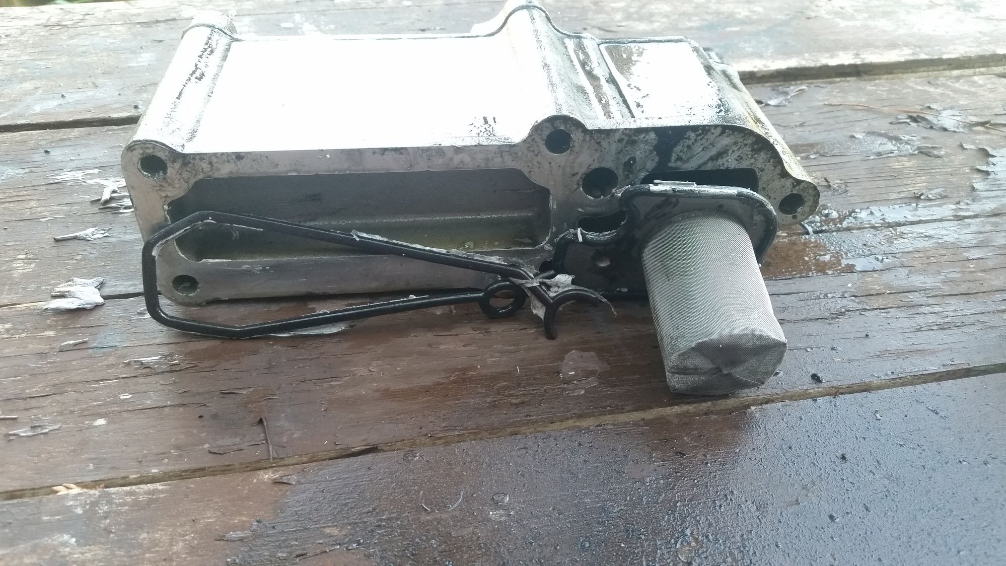

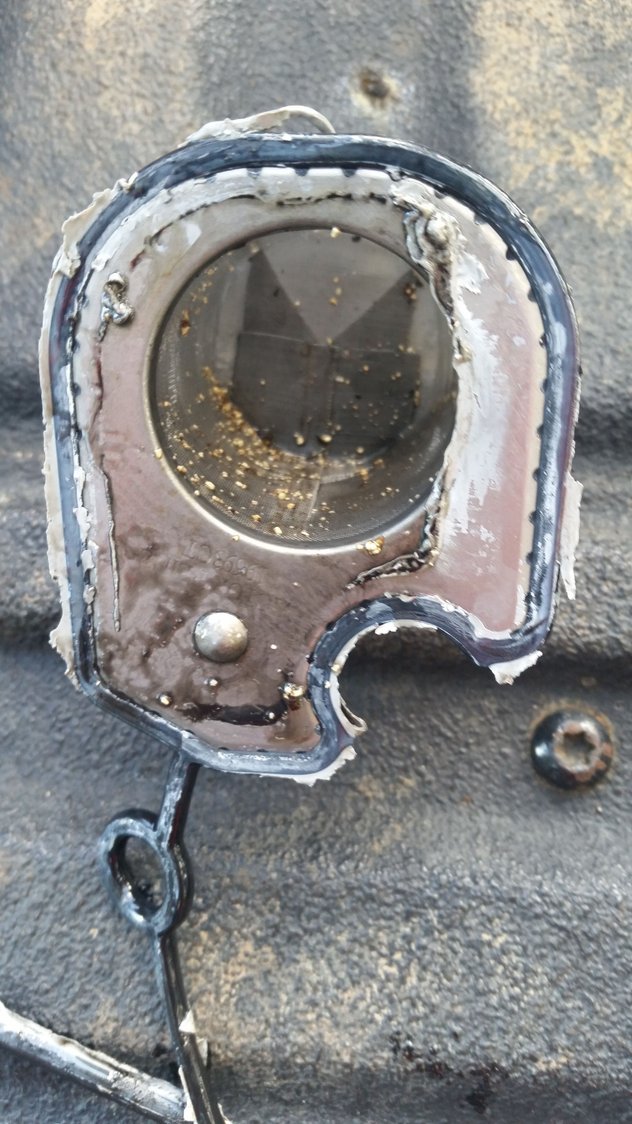

took the hpop res off to see what o ring to buy and I find this...gravel???? Anyone ever seen this strainer looking thing? Looks to be a part of the o ring itself

That gasket was ment for the superduty trucks

I bought that Riffraff hpop res extension and it came with one of those screens.

I wonder why the thing was leaking though. The o ring appears to be in good shape, and there was silicone in there too. I hope a fresh one does the trick!!
So now I have to figure out how to wash that reservoir out.

I read that you want to make sure you get the proper hpop res gasket for the proper year. Some come without a strainer, but it looks like yours did. Mine, being a 95, didn't come with the strainer. If I put that gasket with the strainer on, apparently it would crack the timing cover! I don't know how gravel would get in there though....

Someone has been in there before. That gasket shouldn't have goop on it. Also I don't think that the obs's should have the strainer in them

This is a freshly rebuilt block (rings, bearings, the whole 9 yards) 15k ago, shiny new starter, oil cooler, HPOP, fuel pump... the list goes on. The kid I bought it from had a lot of money/parts thrown at it by questionable mechanics, and I will bet you they put the strainer o ring on thinking it would work better than non strained. All I can say is I'm glad they did it because it would really suck if those rocks had gotten through to the injectors.
