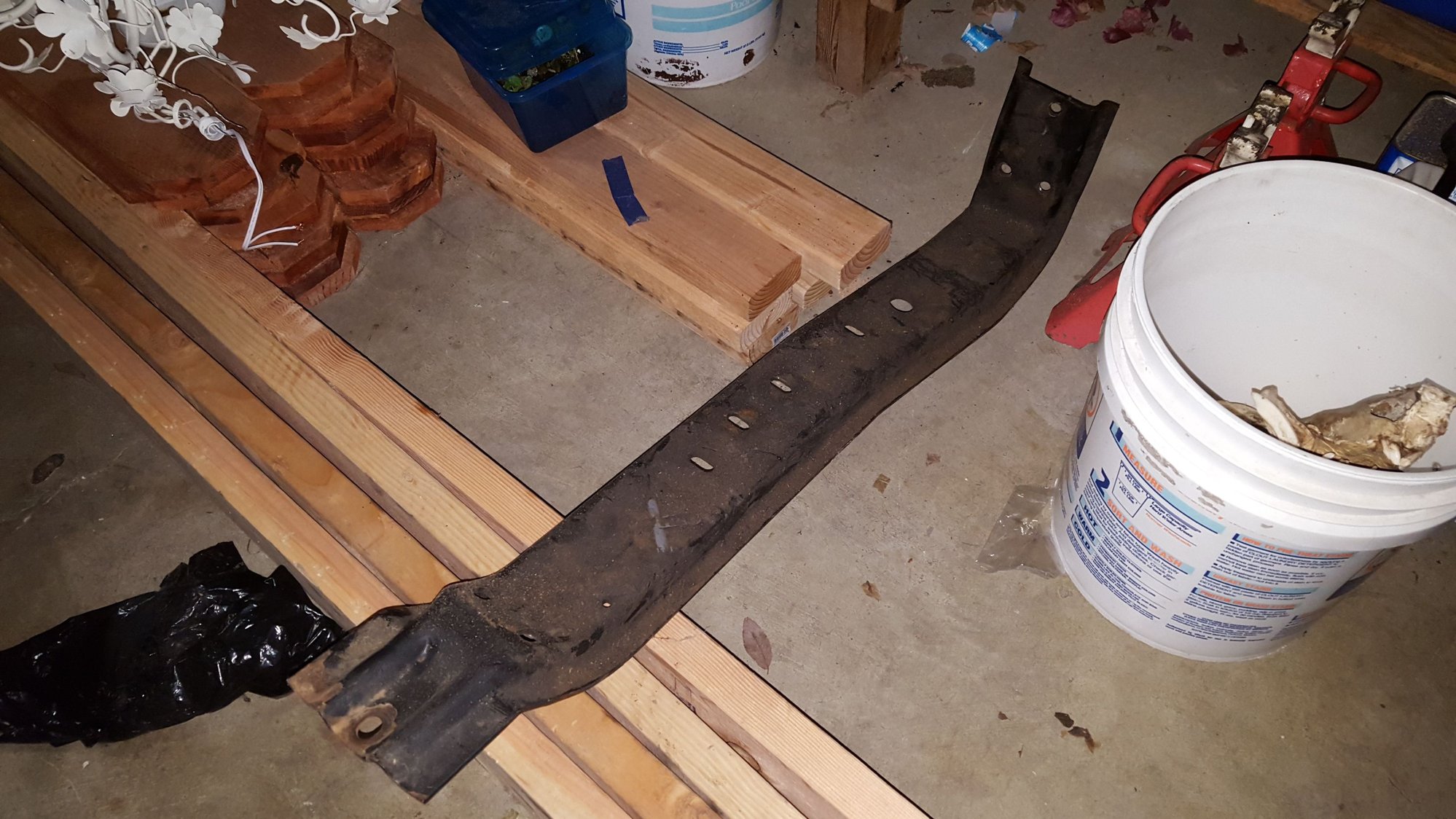

So thank you in advance, but I need the knowledge of you guys at this moment. I purchase my truck with the truck partially converted to 4x4 all ready(front 4x4 ttb installed). The PO also had the m5r2 and bw1356 transmission. That needed to be installed. Which had different housings then I needed. I then sold those to get a new matching set with what I needed.
I was wanting to install everything this coming week and realised that the crossmember looks to be wrong. I know that the crossmem Berlin needs a drop in it to allow the front driveline. The one from the factory for the 4x2 is straight across. The one that came with the truck , for the conversion, has a drop but looks like it's for the zf transmission.
Is this the correct one? Or will I have to get a differs one (and shatter m hopes of install anytime soon? ) again thanks for all the help

No one? If this is the wrong one, would I be able to use the 4x2 crossmember till I get a 4x4? Or just c notch my existing crossmember?

If no one chimes in I can look at my truck after work and let you know. If it is the wrong one though, you may be able to swap trans and trans case bit not put in the front driveshaft. Do you already have the correct shafts for the swap?

I have only seen that x-member with the turned-up end on E4OD trucks.

Have you tried bolting it up? The manual crossmember for the 5 spds (not sure about the non od trannys) are the same or are compatible with one another. And x2 on the hump, I don't think I've seen that on manuals but that doesn't mean that it won't just bolt in and work, or work with minor modification.

I have the transmission 4x4 m5r2, transfer case, and both correct driveshafts. I have a 4x2 m5r2 and the crossmember is flat across, I was under the assumption that there was a drop on the driver side that allowed for the front drive shaft

If you're not lifted it's probably not an issue either way...I had to hack my crossmember when going from mazda trans to zf5, prob from a slight difference in trans length and/or zf sits lower. I cut a "U" about halfway through the x member, then welded gussets/support under.
Either way, if you have a welder you can just wing it. If you're not lifted, it likely won't be an issue. If it is an issue, it won't be by much.
Could also check jys or craigslist for a partout.

I'm lifted 4in. So I need either a new crossmember or hack a channel in mine

Well i got a new crossmember on its way to me. And with that being said. I have no faith in anything I got from the previous owner for this swap.
