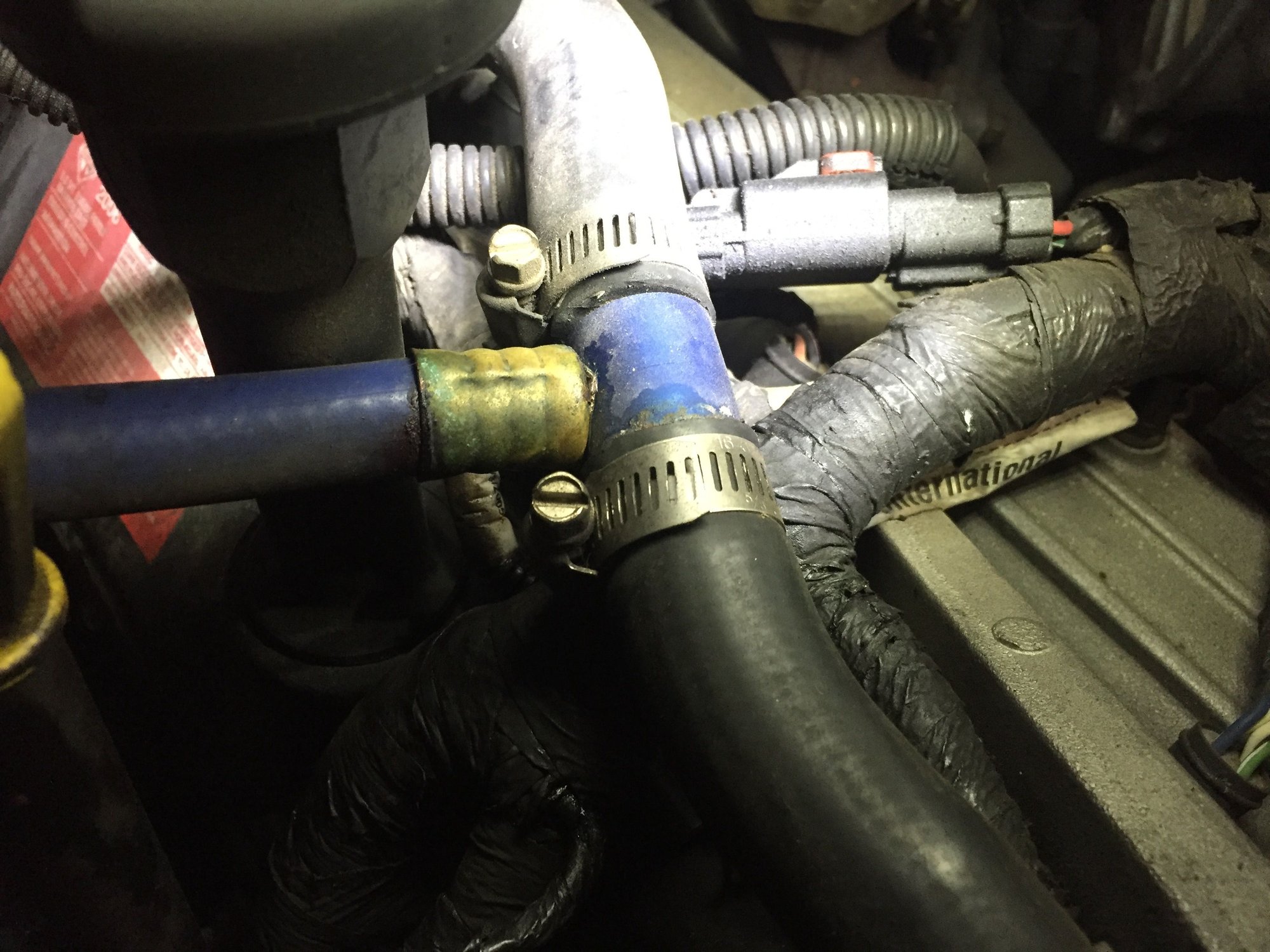

I have a few thought on this. Pretty quickly after getting my truck I realized a coolant filter was a good idea. Like many here I installed a Sinister bypass set up. It was June 2011 @136k miles. Flushed with chemicals and switched from Ford Gold coolant to CAT EC-1 May 2012 @ 144k miles. It had some rust and dark sand in it but no "gooey" stuff. I got steam out of the tail pipe in June 2012 @ just 150mi later. EGR cooler was cracked, replaced it put an oil cooler and some other stuff on it. Went back with the CAT coolant. Changed the coolant filter several times, it did have some sand in it but never was near clogging. Fast foreward to August 2014 @ 163k miles, top radiator tank leaking at the crimp. Replaced it with a new Mishimoto radiator and a new coolant filter. A couple weeks ago @ 177k miles, I smell coolant. It was coming from the top of the engine and I figured the EGR cooler hose had sprung a leak but nope, it was the T fitting for the coolant filter.

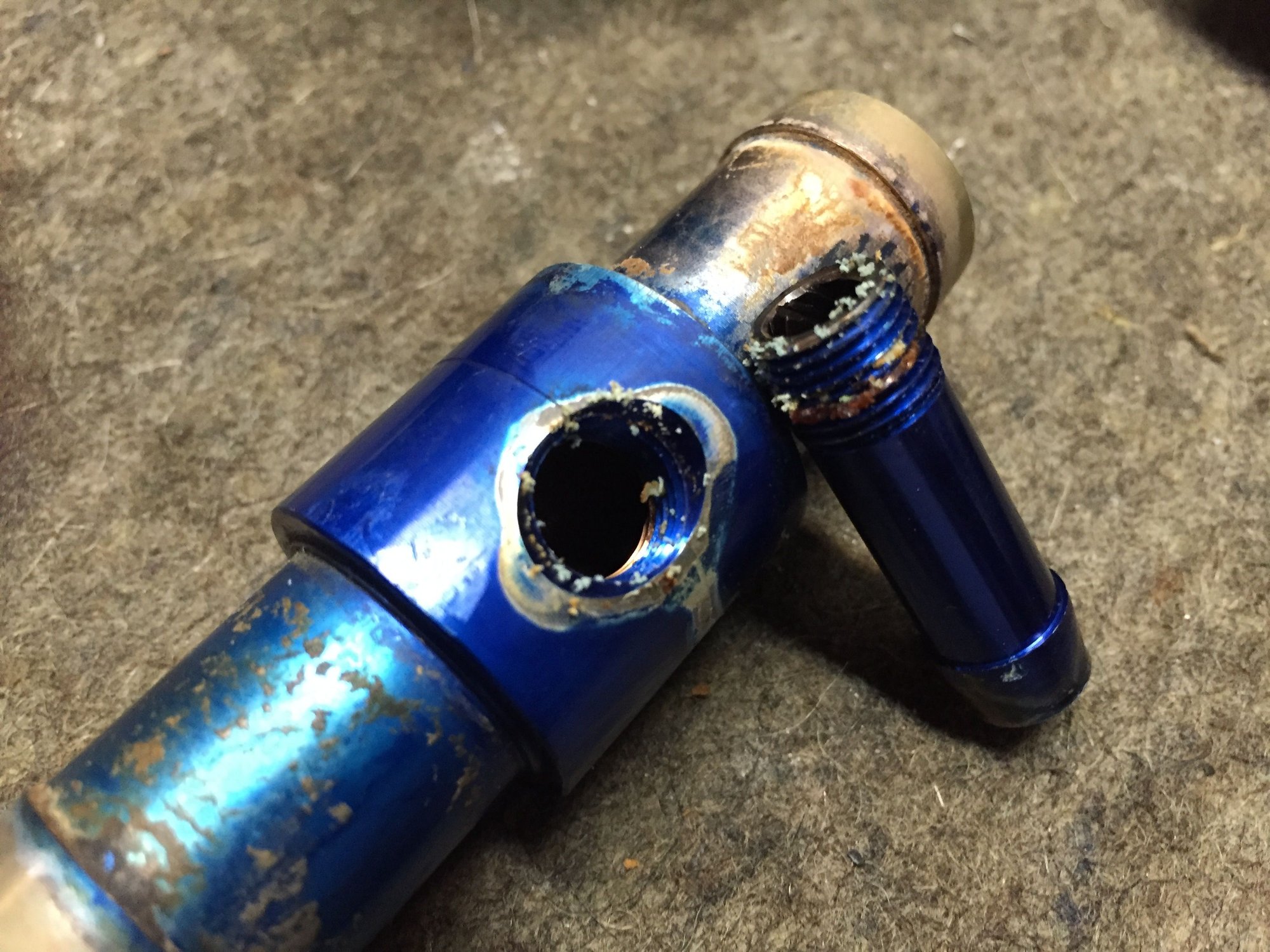

After cutting the line and pulling the fitting out I thought is was cracked when I saw this.
Turns out, the thread sealer had failed where the small pipe screws into the larger one. I thought I was going to throw it away but it turns out it's fixable.

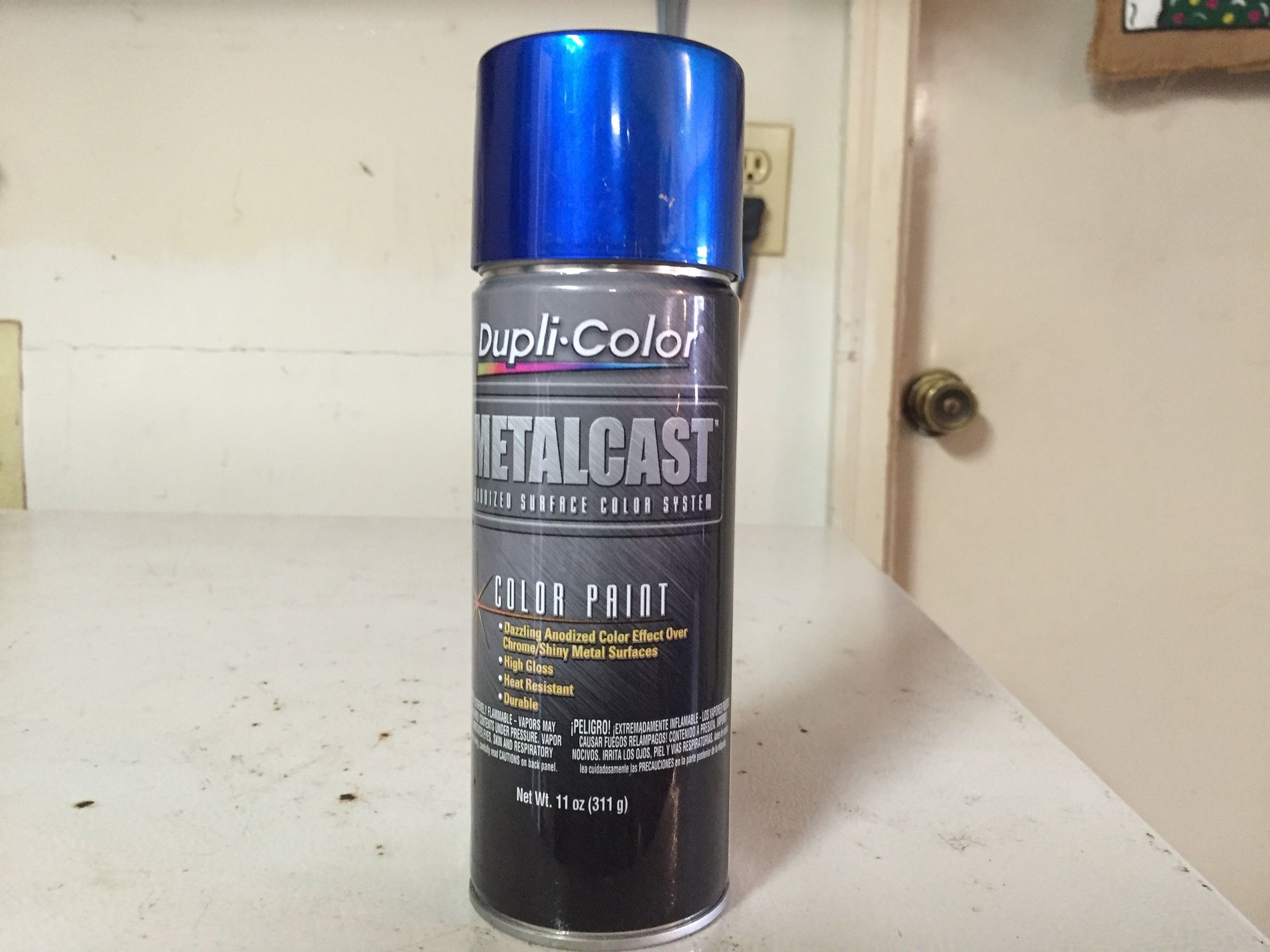

Notice these pieces aren't anodized, just painted aluminum. I sorta dressed it up with this stuff. Came out pretty well and I've used it on a couple of other parts also. Looks good if you get a shine on the part before painting.

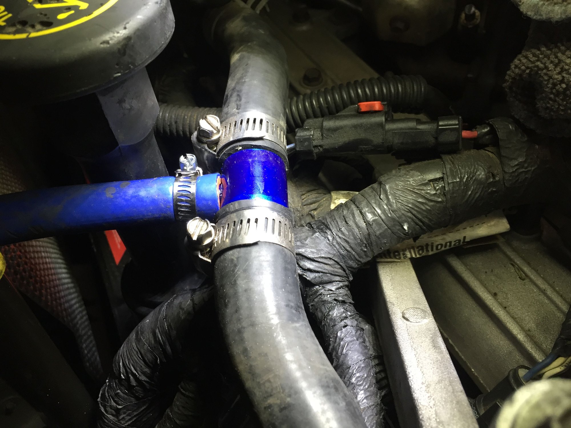

Back in place and sealed up.
Ok, kinda interesting I guess but what's the point? Every time I have a chance I've suggested using a coolant filter and I still think it's not going to hurt anything but as you can see, it adds parts and potential leaks under your hood. I think the Sinister unit is pretty good quality and I'm not mad about the leak, it's been on there a while. The biggest issue for me was this.
