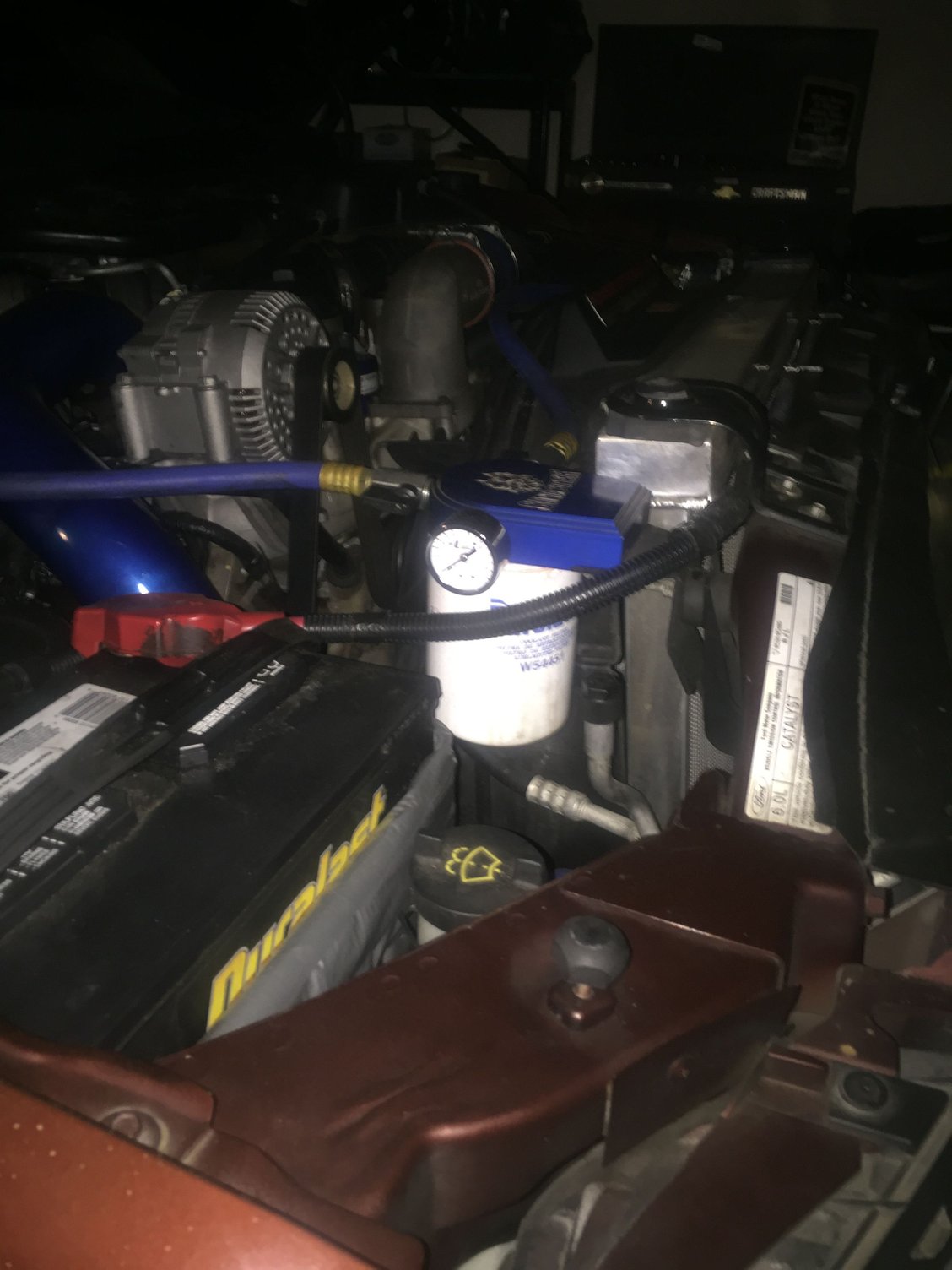

I could have summed up better by saying- this is just my experience with one truck. Any of these kits that connect like this do remove some trash from your system but don't think it's perfectly clean. Does it really matter if there's 2 teaspoons of trash in the system or 3? I've proven to myself that's the situation on my truck. In the end, quality can vary but they all use the same filters and will do a similar job.
In support of using a filter I'd say Getting good flow through the filter is key. Some guys have built their own kits using larger hoses and even drilling out fittings to improve flow and making connections in different areas.
It could also be argued (I now think) that a good flush and regular maintenance could eliminate the need for for the added complications of a filter altogether. In the end though, it's your truck and you should do what makes sense for you.
I've decided to leave mine since its allready there, it looks kinda cool, it's not hurting anything and I recently installed a gauge to monitor coolant pressure so it now has two purposes
P.s. You can see a little bit of that blue tinted clear coat paint on the CAC tube in this pic also. It looks pretty good if you do good prep. There a couple different colors also.
