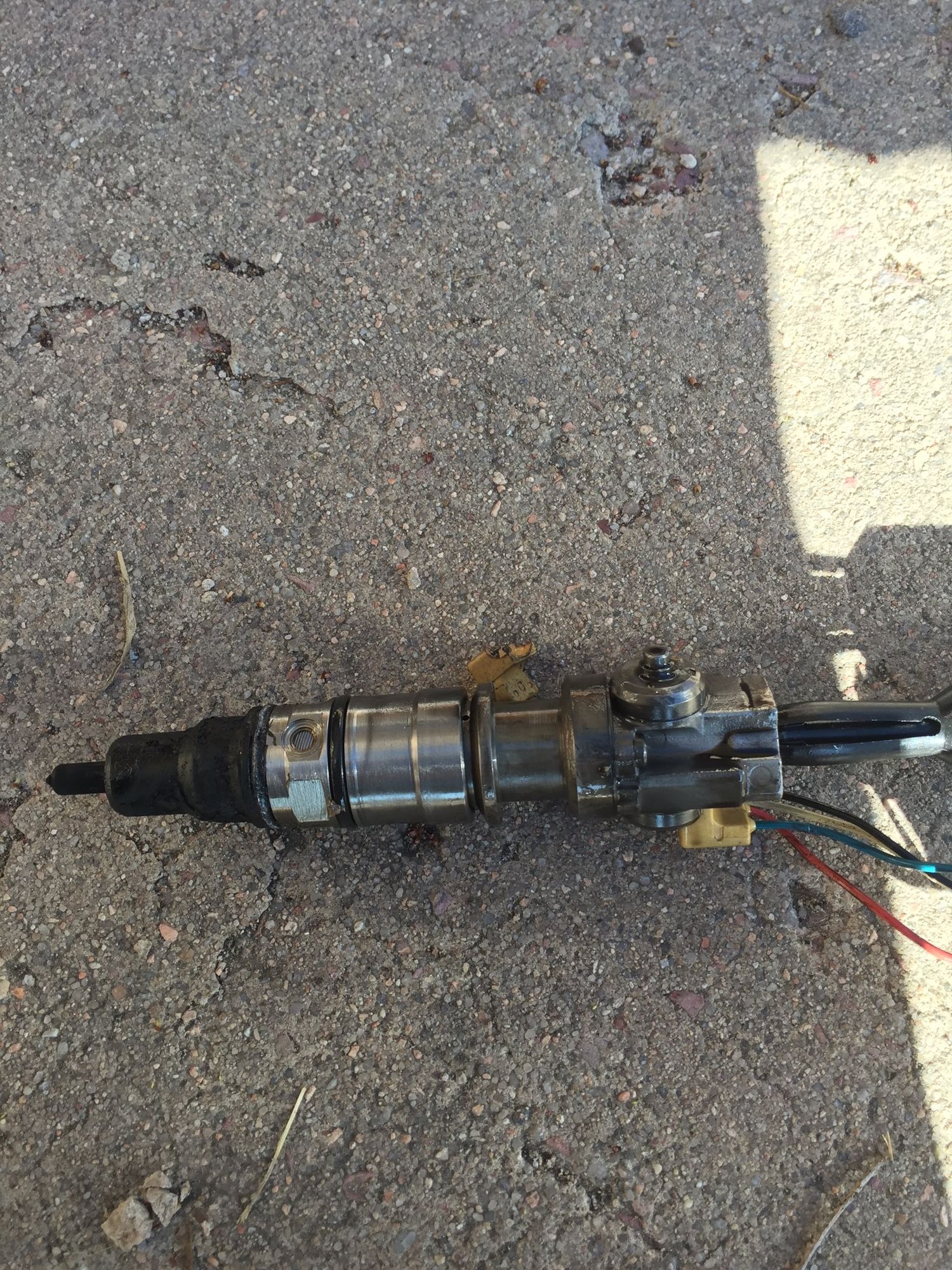

Well it's out! Thanks to everyone for your help. It looks like a missing brass washer caused all the problems.

Do you mean the sealing copper washer that goes over the injector tip, fitting between the injector and cup in the head?
You really need to check and see if it's stuck to the cup.
Was this injector ever replaced?
Old Mar 16, 2016 | 10:05 PM
jmacr12's Avatar
jmacr12
Joined: Feb 2006
Posts: 64
From: Colorado Springs
Right, that the first thing I checked.

If you can't find it then it burned up
There was one there at one time
