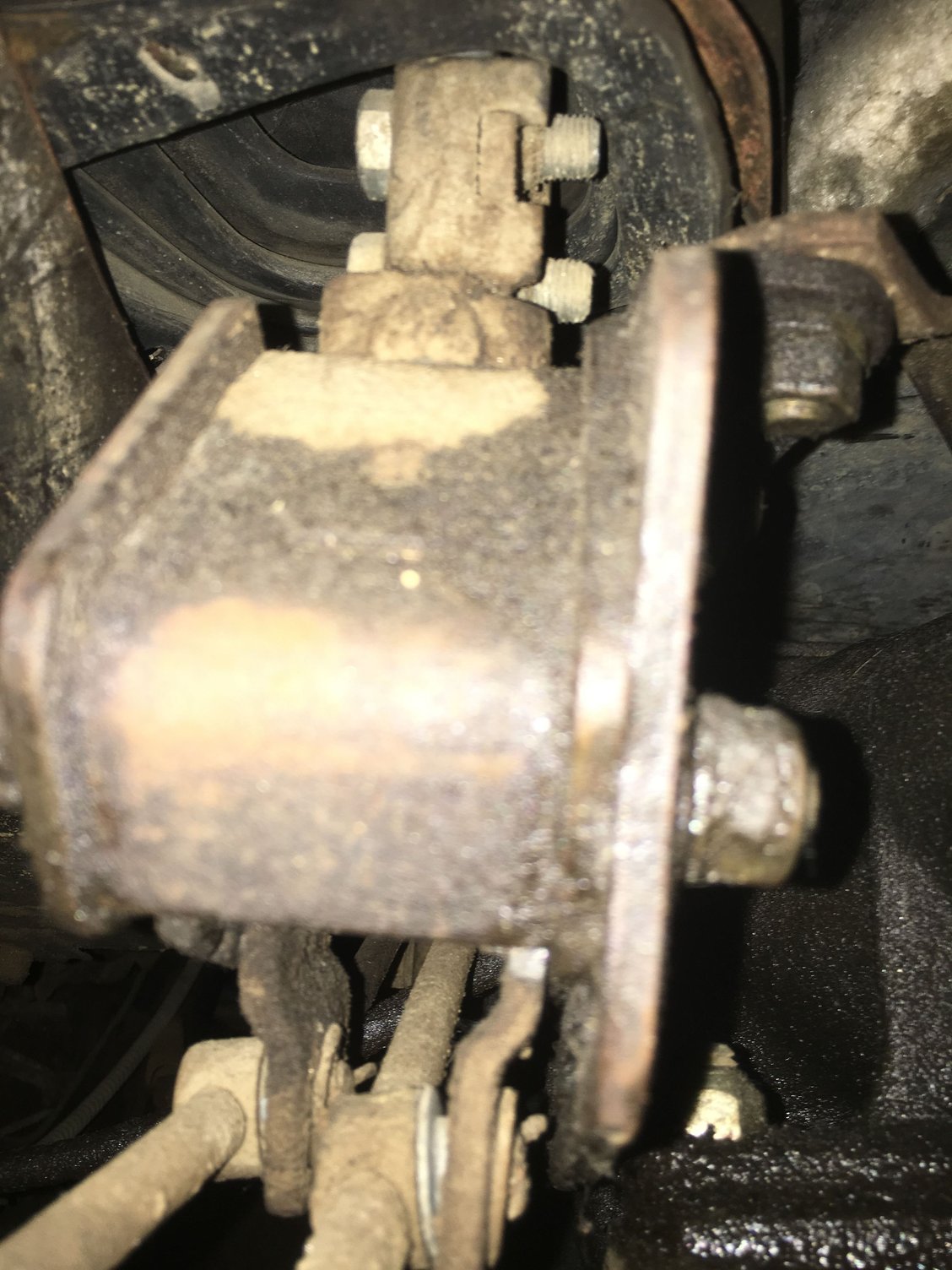

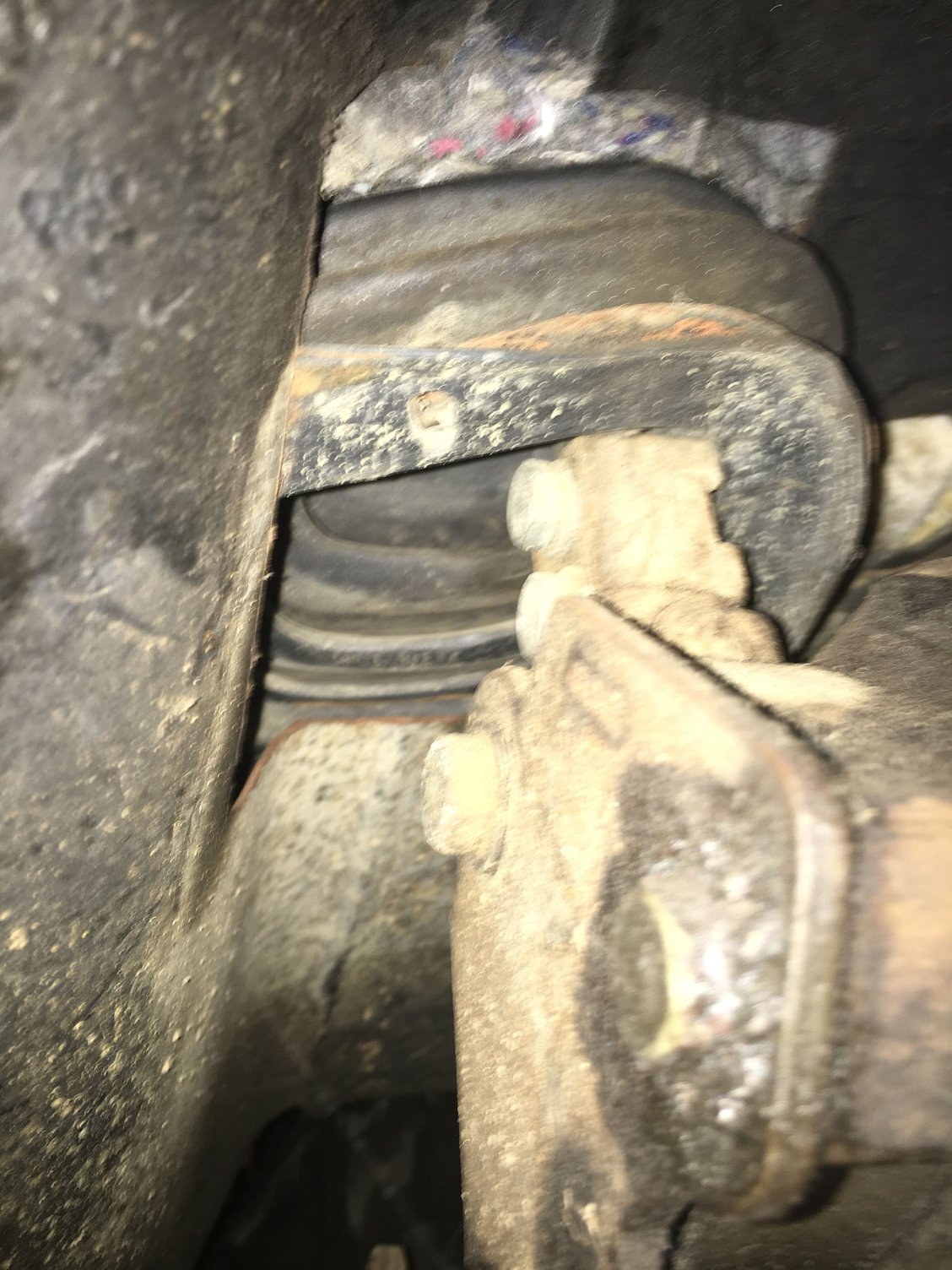

I have a 65 Ford F100 with a 3 speed column shift, I bought the truck and someone had transferred the column to a floor shifter. From what I can tell is that the shift linkages have been flipped backwards and set up the floor shift, and believe it or not there is no "H" pattern it's straight forward and back. So, my question is, what is the most likely thing to fail on a column shifter? From the break downs I see there is numerous parts, just hoping that there are some common culprits.

No h pattern? Which transmission is that? I think the common failure points on the column shifters are all the bushings.

Hi all, well I'm gonna bring this thread back to life. I still have the floor shifter and I have also been able to use it, but at times it will not allow me to come out of first. It will stay in gear and won't come out until I move the shifter around and at times put some pressure on it to come out of gear. I know it has fluid in the transmission, I'm hoping that it is the linkage that is sloppy. You can see by the pictures I posted at the beginning that the last pic it shows some sloppy connections. I'm hoping that it is the linkage and not the transmission but I'm open to listen to troubleshooting for either one.
