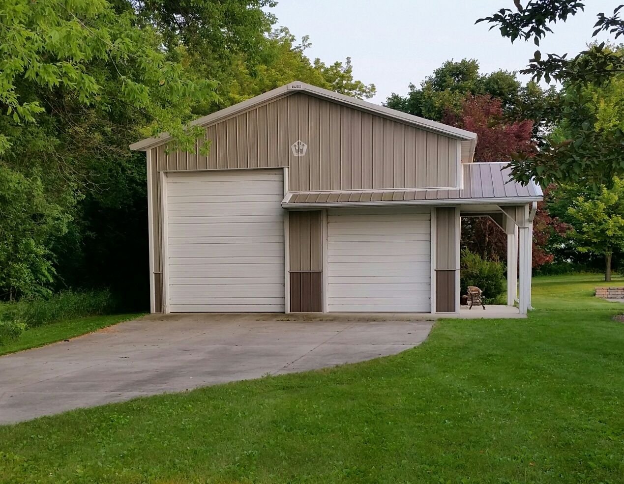

Well that's a nice garage! You just wanted to post a pic of your cool over the top garage with a crown on the front of it.

Scott, thanks for the comments, just what I was looking for. When I started looking for a lift, before I bought the one I have, i did a lot of reading but there is a lot of opinions out there about different lifts. I'm just looking to see what other on the board have. I trust the guys here to offer honest opinions. I know about the national certifications and would only entertain approved lifts.
Ben, the lift is probably going to stay. The prospective buyer seems to like it as much as I do but it's more important to me right now to sell the building than to keep the lift. I just want buy a lift that is as good as the one I have. I have the lift in my current building because we still use it. It will take some time to move it from one building to the other. I need my forklift to take it out and then I have figure out how to get the forklift to the new place to put the lift back up. I didn't really think it would become such a valuable negotiation issue when selling the building. The prospective buyer actually just walked into my shop one night and noticed it. I had "For Sale" sign in front of the shop. I didn't know in advance that he was coming. Now I wish I had pulled it out.
The old shop has 16' ceilings and so does the new one. The previous owner stored a RV in the shed, that's reason for the large door. I do plan to run my business out of the shed. The lift will be used to work on family and friends cars, not for the business.
