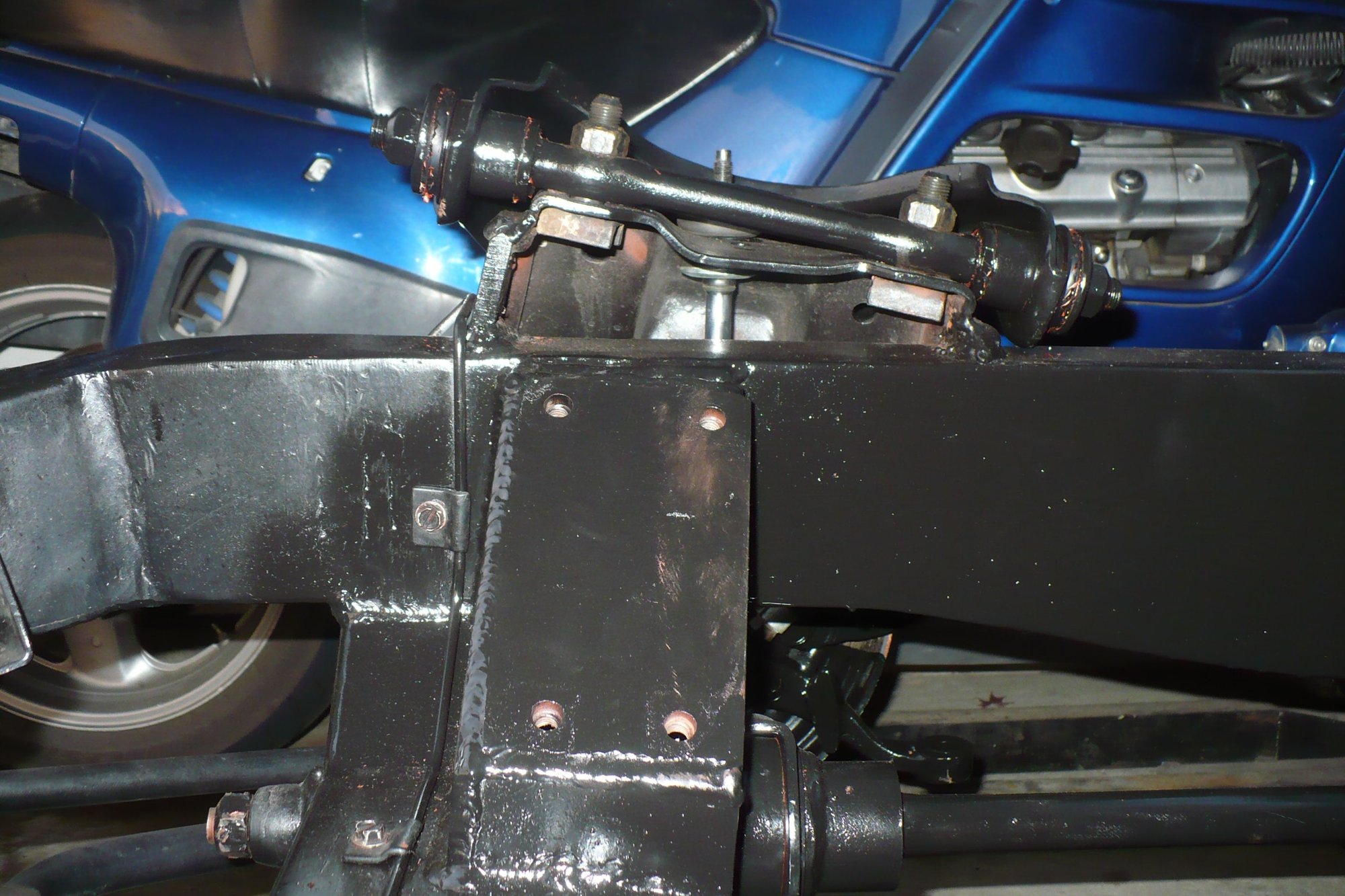

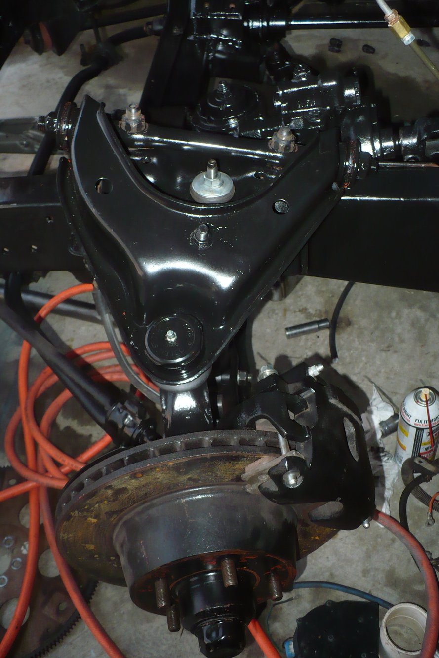

Do you have the steering box? I just rebuilt all the ball joints and bushings on mine. About $300 for all Moog parts, including an upgrade to 11/32 tie rod ends, plus about $130 for a rebuilt steering box. Removing the bushing in the lower control arm is tricky but I found a good tutorial on utube. The upper ball joint takes a special tool - see below. I checked at my local tire shop and the old timer said he hadn't seen one of these in a long time and would have loaned me his socket except he couldn't find the socket.
Also, looks to me like the upper control arm inner mount is not right. It should angle upward toward the front and yours looks level.

Just to show how many ways there are to build these. Mine is a cordoba IFS. Very similar to the Volare but the torsion bars (not to be confused with the sway bar) are parallel and behind the front subrame as opposed to criss-crossing infront of the subframe. The cordoba set up makes routing the headers more difficult. I mention the angle of the upper control arm mounting bracket because I know it is supposed to be angled up toward the front but I did not measure this angle on the donor car for my parts and had to guess at it. Now after the fact I'm kind of curious how much off my setup is from the oem angle.
