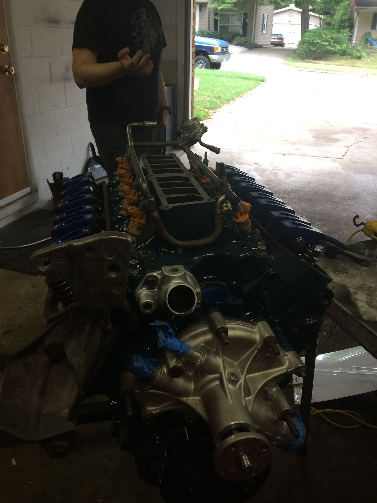

So the Eagle rotating assembly finally came in, and now I have a short block. With my KB flat tops, they perscribe a piston to head clearance of 0.040" to achieve optimal quench. With a dial gauge and magnetic stand, I determined my pistons were in the hole 5-15 thousandths, so I went with a 30 thousandths compressed thickness head gasket, which puts me at 35-45 quench.
Timing vover, fuel pump, cam and lifters went on quick. NOTE: this 89' truck block was a flat tappet cam, but all the shop needed to do was tap the holes for the dog bone retainer in the bosses that were already there.
When I went to put on the 2nd head, I noticed the #4 exhaust wasn't seating completely, which was the cylinder where I threw the rod on the last build. With the head bolted on with gasket, I put my thumb over the spark plug hole and cranked it over by hand; zero compression. MY guess is when the rod broke loose, it smacked the valve. So I'm having the new valve overnighted to the shop and they will replace it and the valve guide, which I hope they tell me is all the head needs.
IN the mean time, my buddy offered to help pull the tranny, which is out, and I verified my pinnout, and added a jumper for the 2nd o2 signal to close out the wiring.
I should have the head back this week and have her in this weekend.
Block from the truck: bored 0.040" over, line honed, Eagle crank/rods, KB piston, King bearings, balanced and installed by the trusted local engine shop
He even tapped and threaded a stud into the main ARP stud for the oil pickup; was a nice touch. Courtesy coat of paint.
Long block. I'm going to the stoock upper-lower and 19#/hr injectors, with stock MAF TB and MAF housing hoping to be streetable after break in
