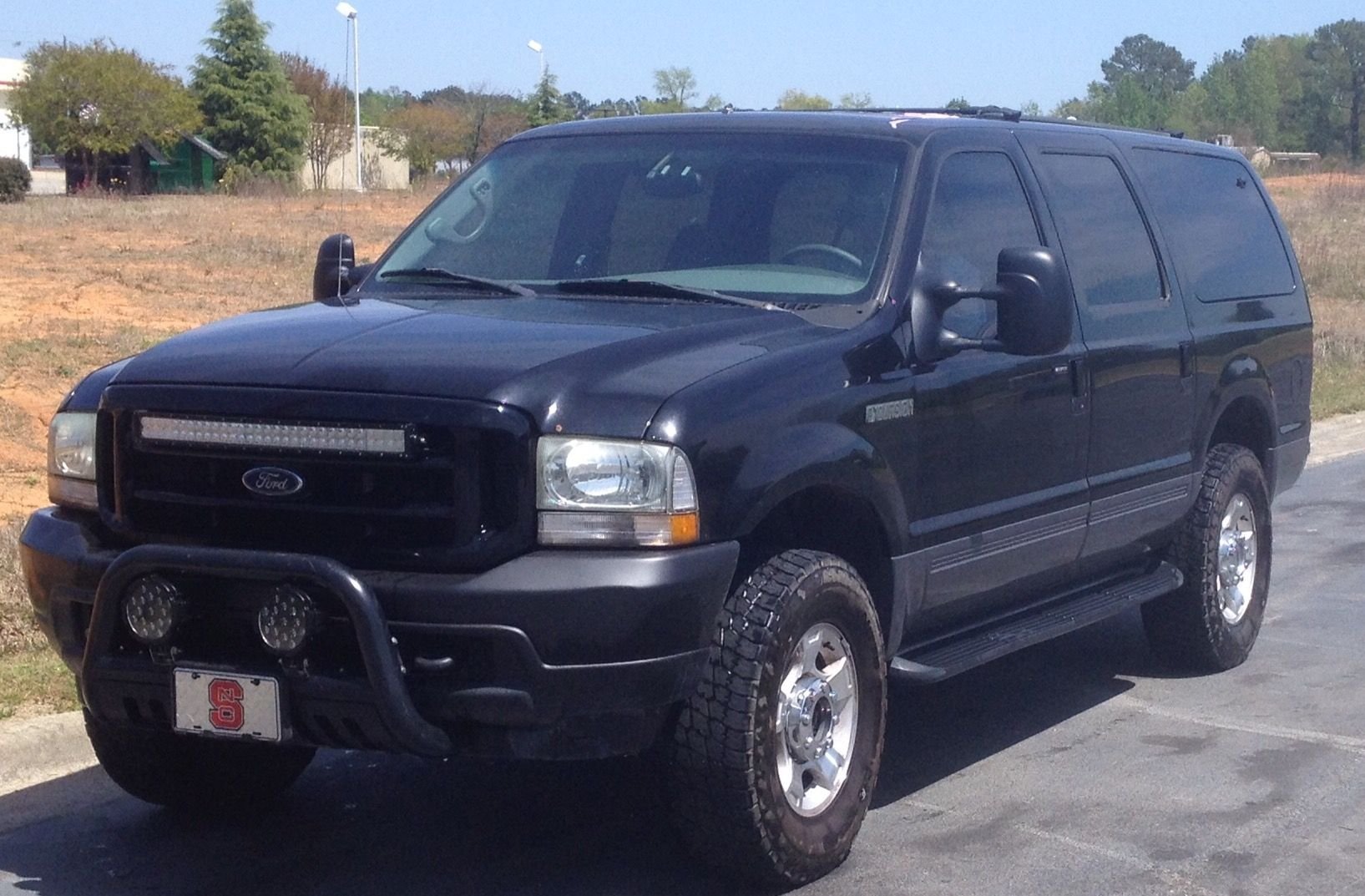

2012 Ford SD 18x8 rims using 2" alum hub centric spacers. Jus recently bbo

2012 Ford SD 18x8 rims using 2" alum hub centric spacers. Just recently put some aftermarket wheels

Those wheels look good on the Ex Rscott!

I liked them to but had to get rid of the spacers. To me those rims looked real good with a wider tire like the 12.50s. I had 11.50s on these
