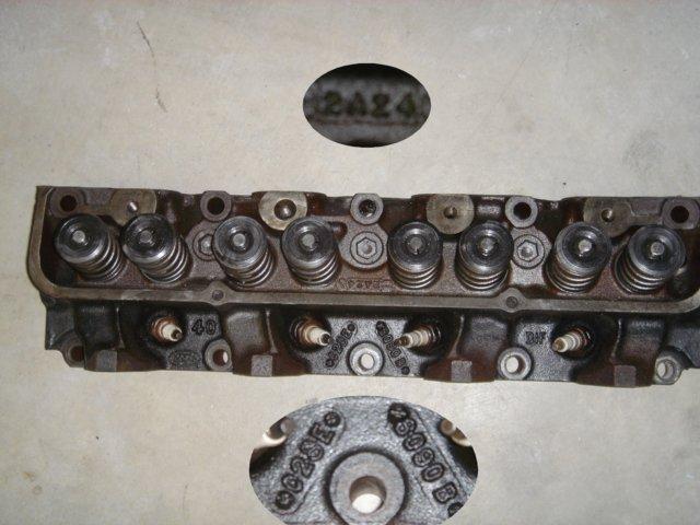

Block casting numbers are on the right side, with date code under the starter. Picture here:
Ford 352, 390, 406, 427 and 428 Engine Blocks
Head numbers are between the center plugs like so:
http://www.oocities.org/tpls63/trips/m_head2.jpg
Don't be surprised to find this is a 352, probably the most commone FE in '65 and there abouts. Most 390s were 4bbl motors in those days, with, if this is correct, the 390 2bbl being a Lincoln Mercury offering. 390 2bbls became much more common in '66 and later.

I have found the following markings to look up on the links:
Passenger side head: C6A 5 8090R between the center two plugs, and L8 531 R by the first plug.
Drivers side head: C6AE-R.
Under the fuel pump: 7A26.
Passenger side block: C6ME A
Thanks again for the site info.

Best I can tell (and that isn't very good) those would be standard heads. Like most FE heads, they are plenty good as long as they are in good condition. Engines of that era did not have hardened valve seats, and despite lead in the gas, a burned valve was not uncommon. (our '66 had a burned one a 41,000 miles)
How to Choose Ford FE Engine Factory Cylinder Heads
A compression test will tell the tale on valve condition.
Your date code would be January 26, 1967, which is consistant with a 1966 revision casting number like C6ME. Maybe you lucked out and the short block is a 410. I think C6ME points to either a 390 or 410 as the 352 had left the building at Mercury was dead for '68.
