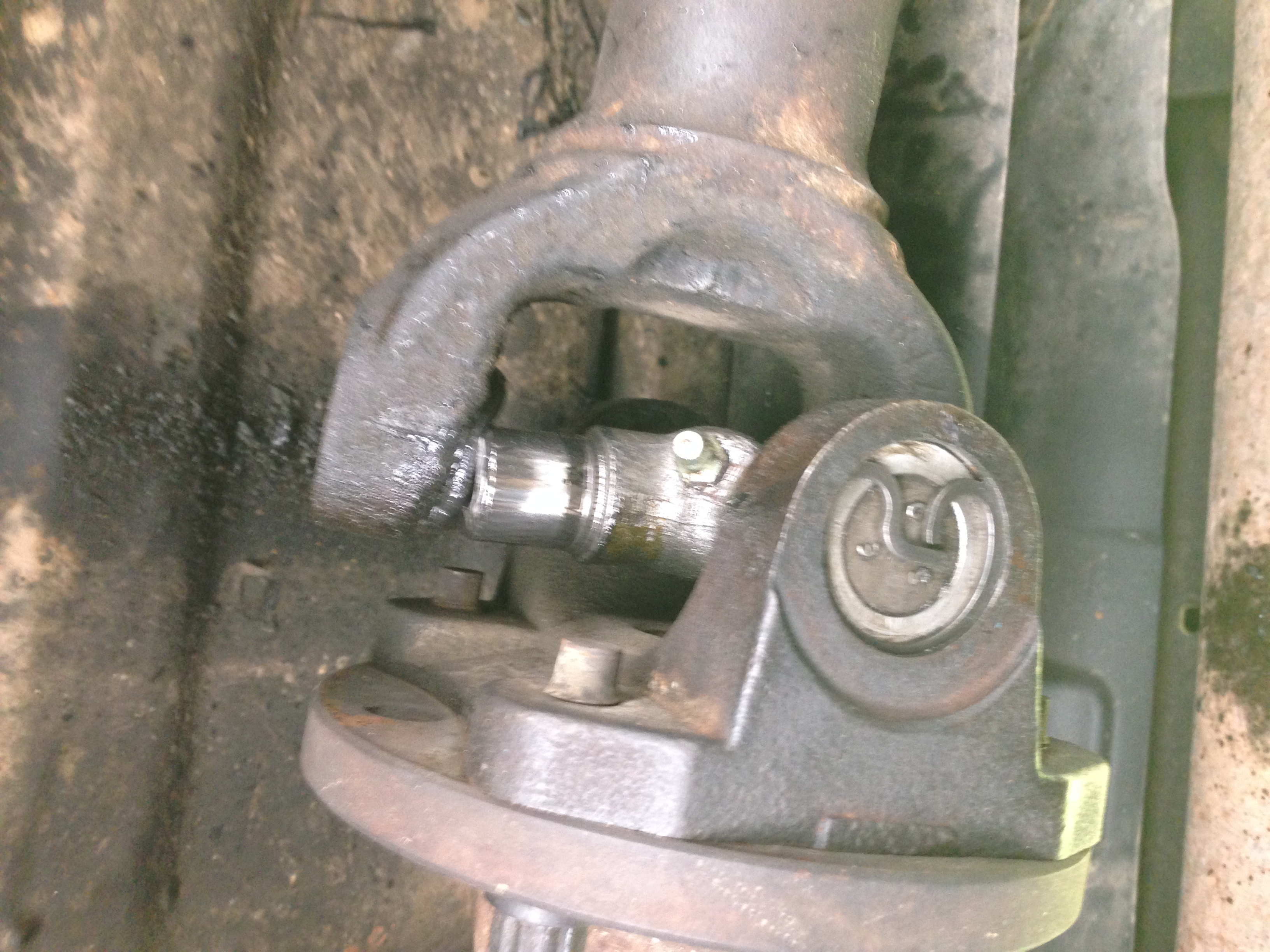

U Joint came apart at 75+mph. Ripped the transmission to pieces and cracked the back of the engine up pretty good. Previous owner installed a 5.4L transmission in it and didn't change the tailshaft housing, he changed the slip yoke and spaced the u joint over with washers. I never feel a vibration until it was waaayyy too late.
I had the same exact thing happen to me. Cracked my bell housing 3/4 of the way around. I claimed it on my insurance. They bought me a new ford transmission, transfer case, front and rear driveshaft and replaced my rear main seal on the engine. All work done at my local ford dealership.

I didn't get a picture of the transmission when they took it out. Happened to me at 70 mph pulling my work trailer. Didn't even know I cracked the housing till I got home. On the side of the road I removed the rear drive shaft locked it 4x4 drove on the front axle to the nearest shop. Had the ujoint replace and drove 250+ miles home. Had a vibration the whole way back and kept thinking it was a bent driveshaft. Got the truck up on the lift and saw the transmission and called the insurance company.
To me, that looks like a new joint was installed incorrectly. The one snap ring wasn't installed all the way, and let the cap fall out...
It was definitely one hell of a shocker when it happened. I've had the rear ujoint on the rear driveshaft go out many times. I Can tell when it's on it's way out. But the front, there was no warning whatsoever. Just bam!!! And I nailed the brakes. I'm amazed my front driveshaft and front axle have held up to the abuse of driving a truck with a trailer in front wheel drive so many times. Every time the rear drive shaft ujoint has gone out it was while pulling a trailer.
ive been thinking about welding up a saftey loop for that front shaft on the transmission side.
