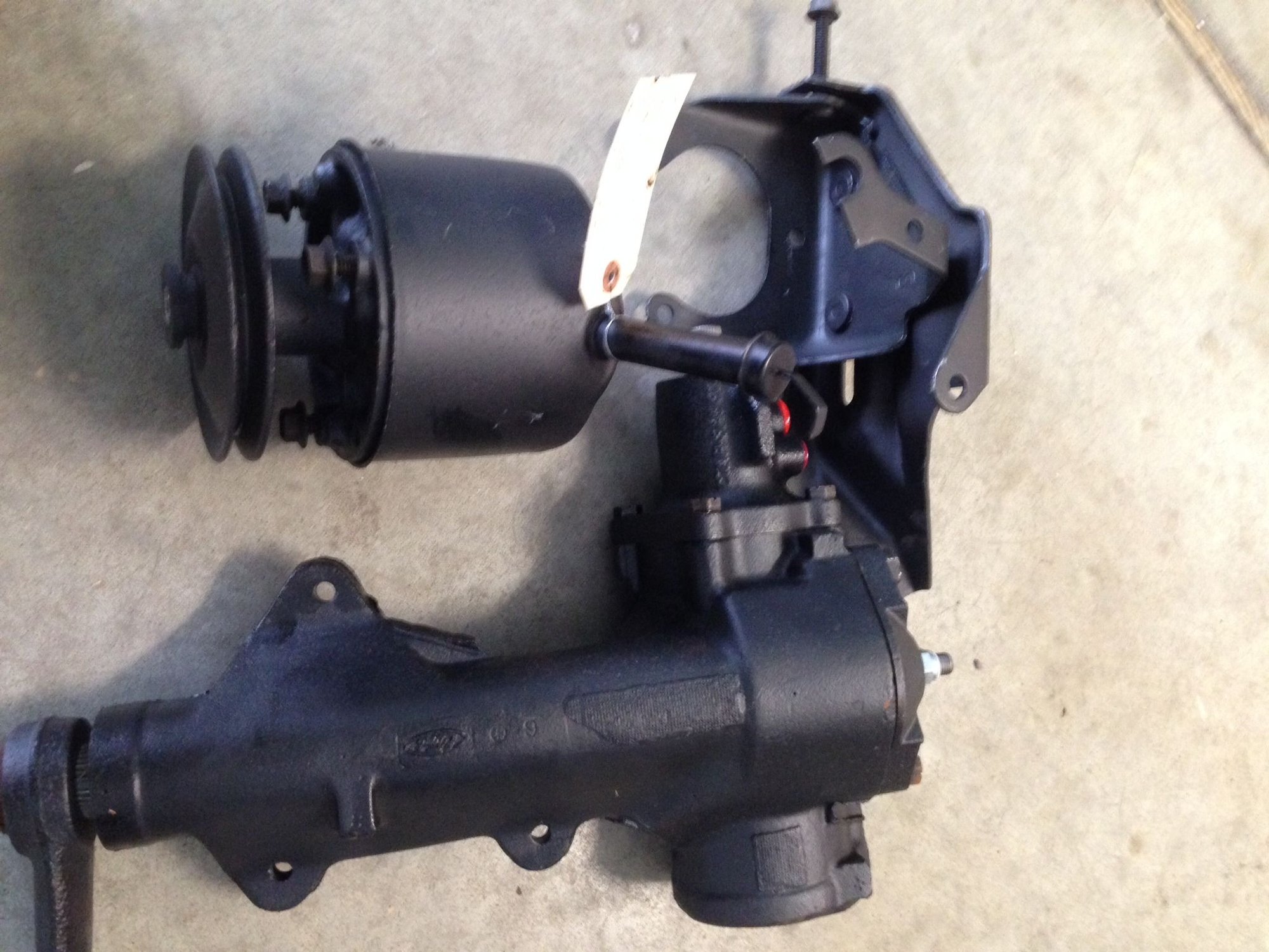

I probably have what you need, all rebuilt and dyno tested gearbox pump and some brackets, I was originally going to put it on my 66 but I decided to put a cv front suspension under it. You will need the lines but everything else is there
If your interested contact me
