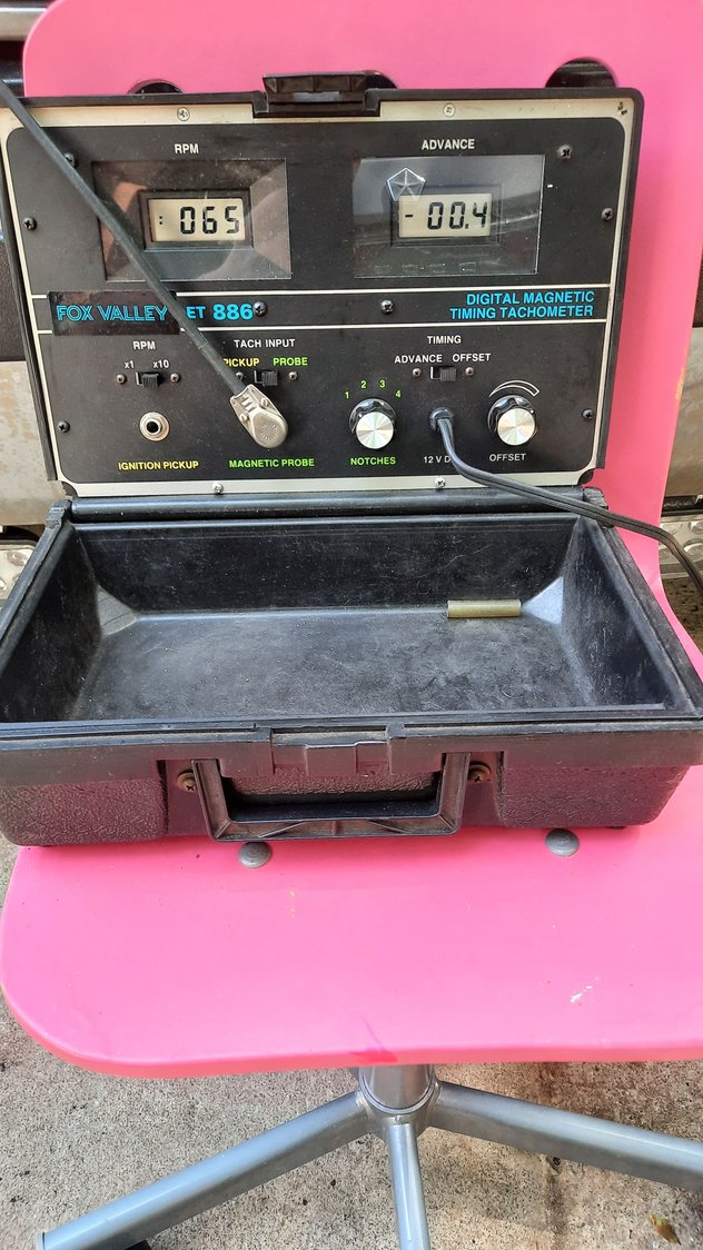

I realize im super late to the party. I just replaced my IP and Injectors. I undsrstand what "BTDC" and "ATDC" stand for. But does that mean to the left and right of the 12:00 mark on the IP housing? Also, are the 8* and 9* that you are speaking of mean degrees? I was instructed to start at 1/16" to the retarded side of the 12:00 timing mark and that gets me to where there is no smoke and fires off evenly. My IP obviously leans to the passenger side. If i set it at 8* or 9*, assuming those are degrees, it would really lean to the passenger side and look really off. Is that ok? Do others have to lean their IP pretty hard? Im a little confused as to why they put the noon timing mark on new IP's and not the 10:00. Unless the 10:00 was done after the timing was done in the factory. It runs smooth but still feels like there is a misfire or a dead cylinder even after everything ive done. I also just purchased a Fox Valley ET 886 machine for 35.00. Works great. Just need to know how to set it and what i am looking for. I.E: do i set it for advance or offset? If so how much do i set it at? I think i may have an unresolved exhaust leak that is causing it to not have enough backpressure. I did split the 2 to 1 taillipe and refabricate it into dual straights. It also has a ram air intake instead of a turbo. I couldnt justify spending 1300.00+ for something that could cause a run away motor and only adds single digits to torque and speed. Didnt seem worth it to me especially after my factory heads pressure tested good after 3 decades and over 1 million miles. Any help would be great. Im still searching for a users manual for the fox valley but no dice yet. Thank you for any help someone may provide on this issue.

Ive asked people so far and no one can tell me what it stands for. What does the * stand for? Is that degrees? I bought a timing machine but not sure where to set it at because i dont know what the symbols y'all are using stand for. If that is degrees, then that would put my ip at a serious angle on the mounting housing.
