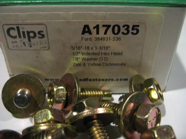

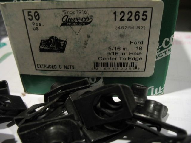

The bolts are Auveco part #A17035....5/16-18 x 1 1/16" yellow zinc with a captive washer. They come in a box of 25. I used 1 1/2 boxes because I used them to mount the fenders as well as the hood catch and some other parts, so you will only need one box if you're just doing the grille, rock guard and valance. The "tubular" U-nuts are part #12265...5/16 - 18 & 9/16 from hole center to edge. They come in a box of 50 and I have half of them left. I can send them to you for mailing cost if you would like, unless you're getting both items for the same shipping cost. You will need some 5/16" flat washers which you can find in your local hardware store. You will need some 5/16" "stover" locknuts which you can find if you have a local bolt house. I bought a bulk bag...so I can send you those as well and include them with the tube nuts for the same cost of shipping. I have a bunch of 'em, so glad to help you out if you don't have a local source
. You may also need just a few 5/16 flange nuts. I use these where it's hard to get a "back up" wrench, such as the top of the valance where it mounts into the holes in the radiator support. These will tighten...once snug...without a backup wrench. You can find the bolts through "clipsandfasteners.com" or just search for them on google or ebay. Let me know if you need any additional help.
