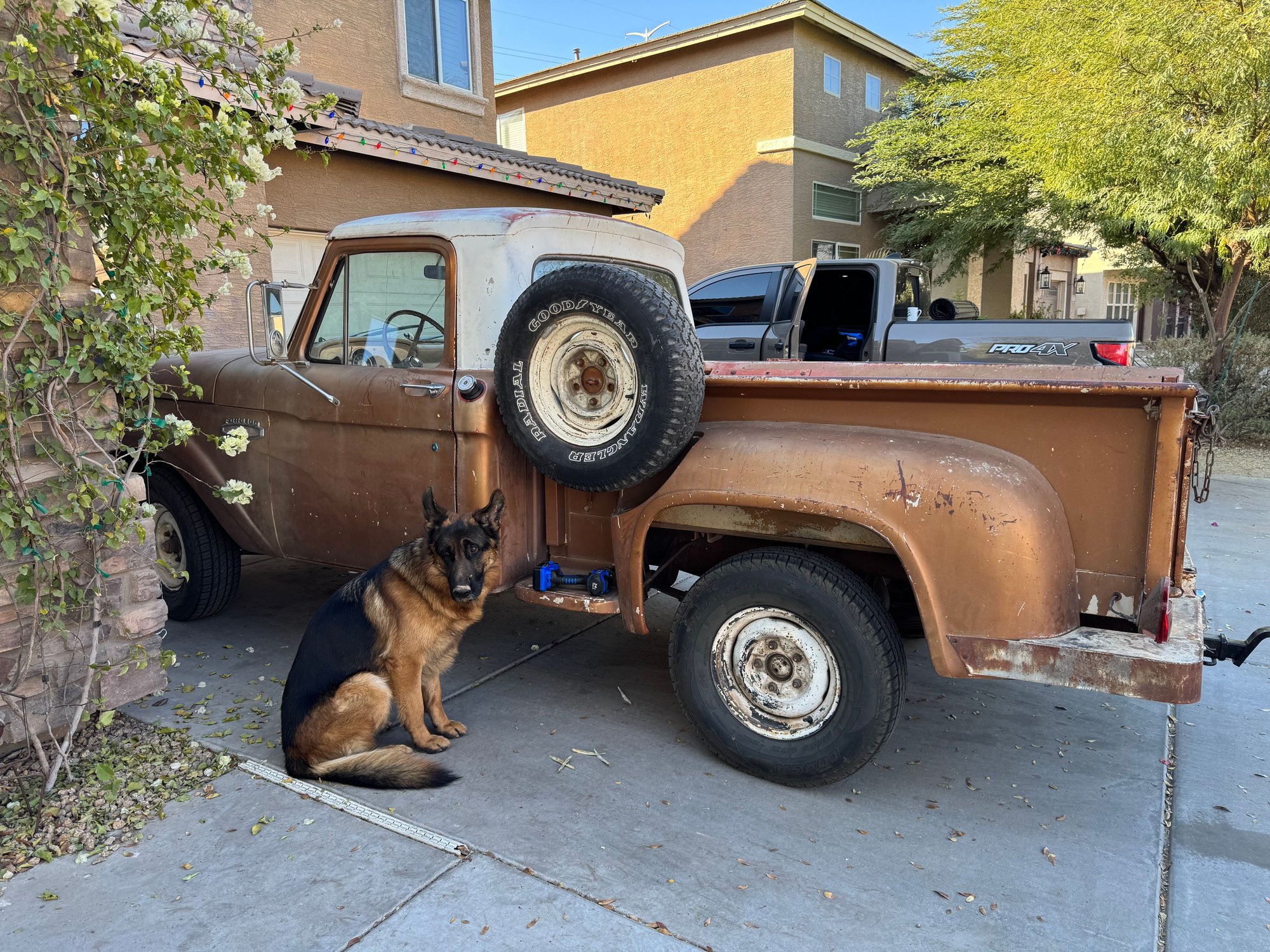

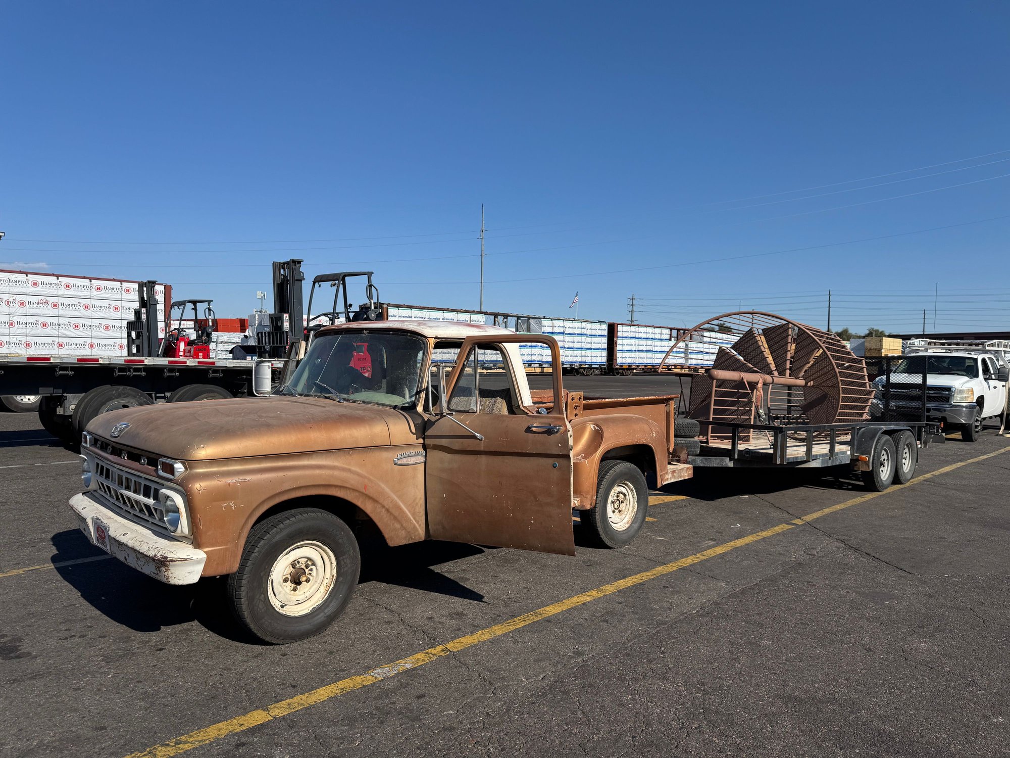

1965 f100 240 motor
thank you. I also resuscitated a 1965 f100 with its original 240 motor, 63k miles on it. it was a farm truck and sat abandoned in the dirt for 30 years. Motor block has a plate on it from Ford dealership saying motor was rebuilt. Truck is now completely new mechanically. I have been driving it daily for about 43 highway miles per day to work, all freeway. I have been using the 10w40 waltmart brand since it came back to life. Will start using 10w30 as explained here. No issues so far with the current 10w40 here in Phoenix AZ.
Thank you all
