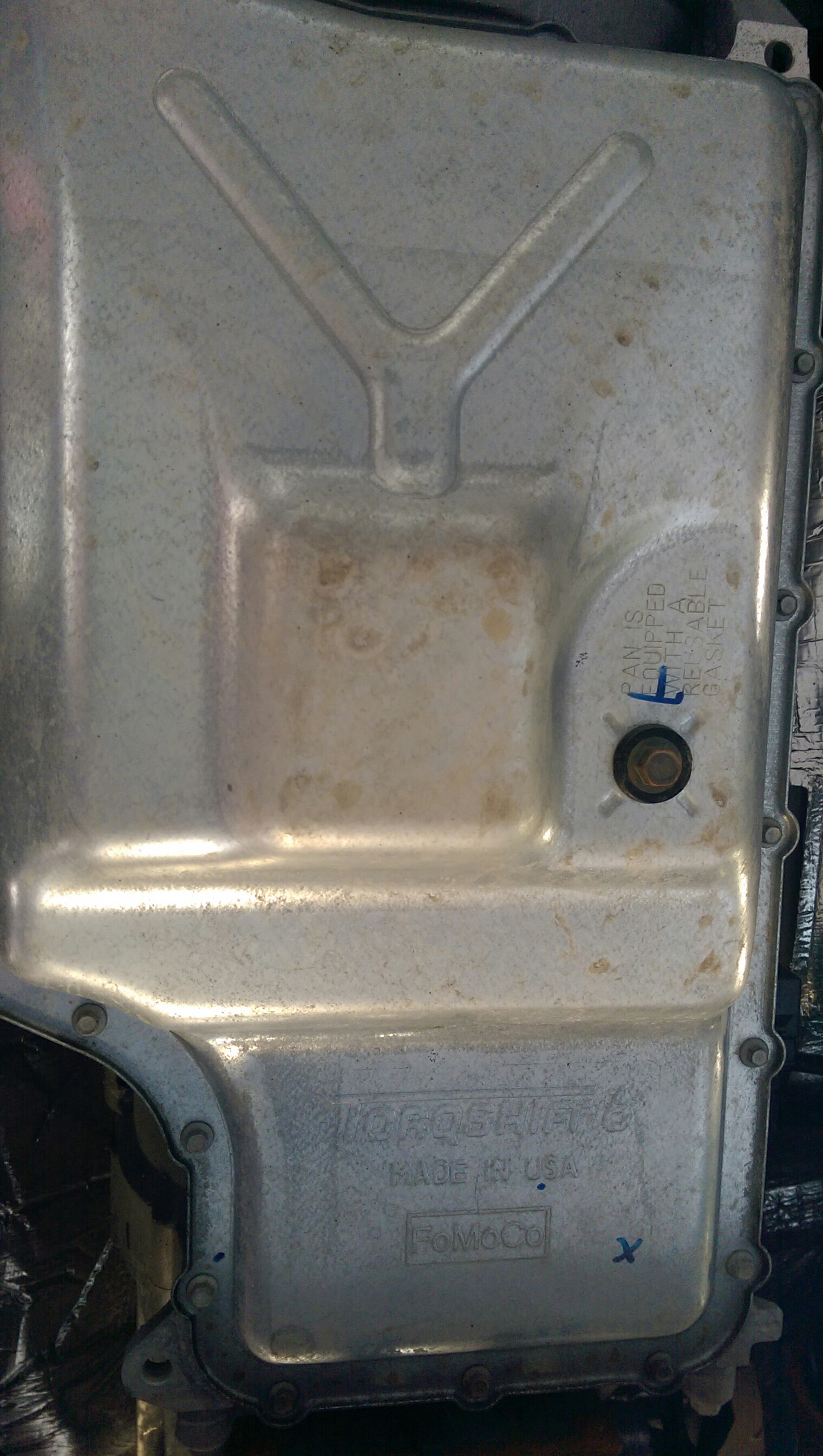

I just crawled under my 2016 (10-15 build) and sue enough...
Keith

Originally Posted by ZooDad
Attachment 136321
Keith
Indeed it does...

well, since we are conversing about whether we should change tranny fluid at or before 150k AND whether we should flush, filter change etc - let me pose a question....
Why did our tranny pan come with a drain plug if we weren’t allowed to do the partial changes ?

The plug is gone on my 2019 model
