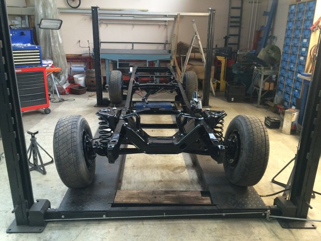

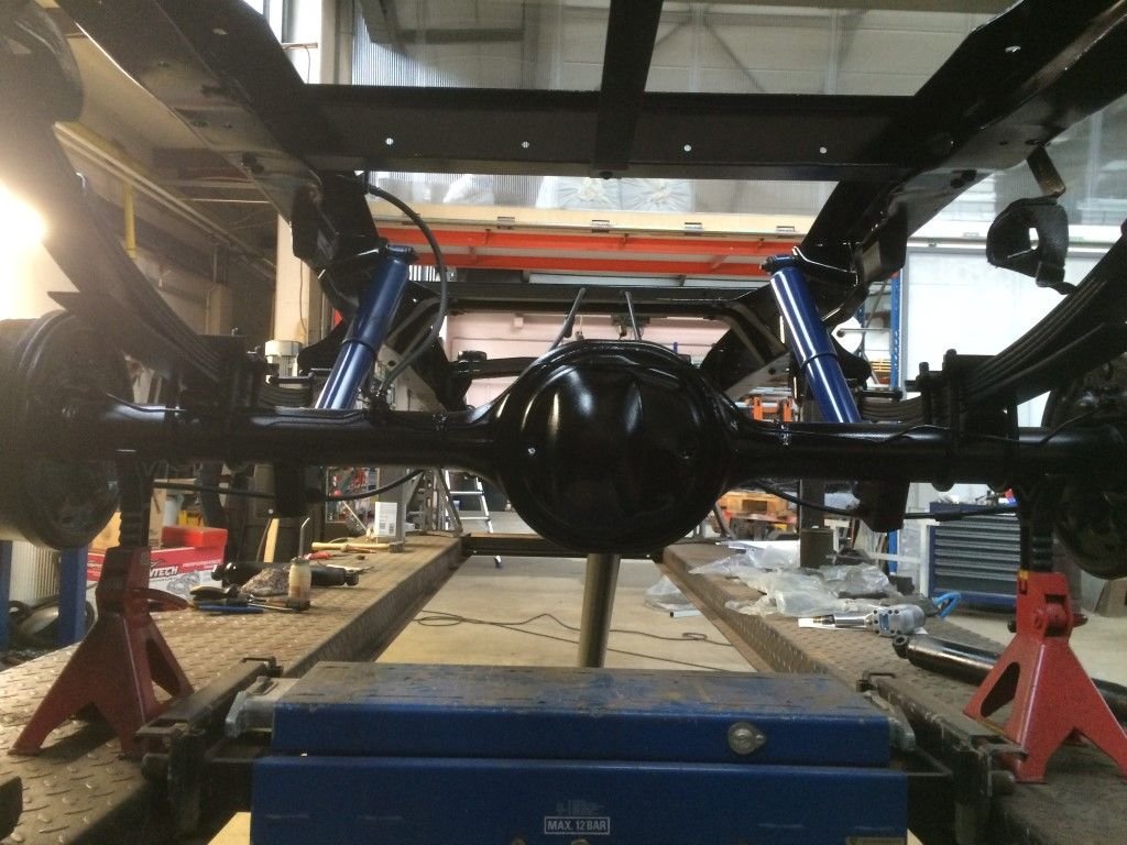

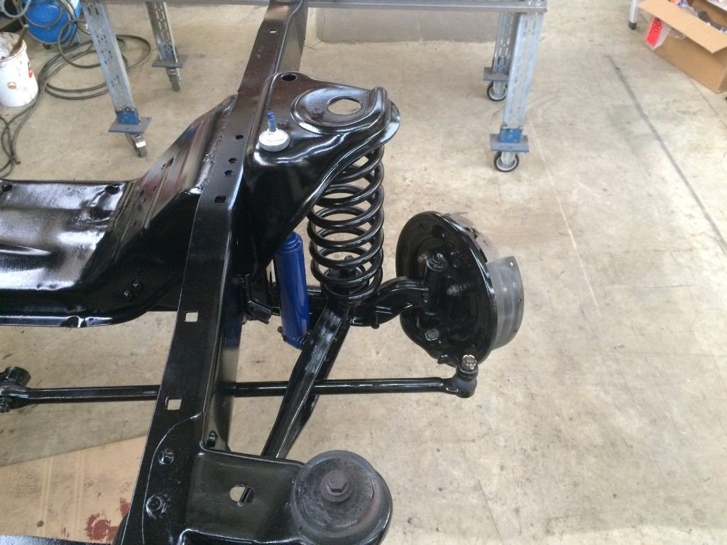

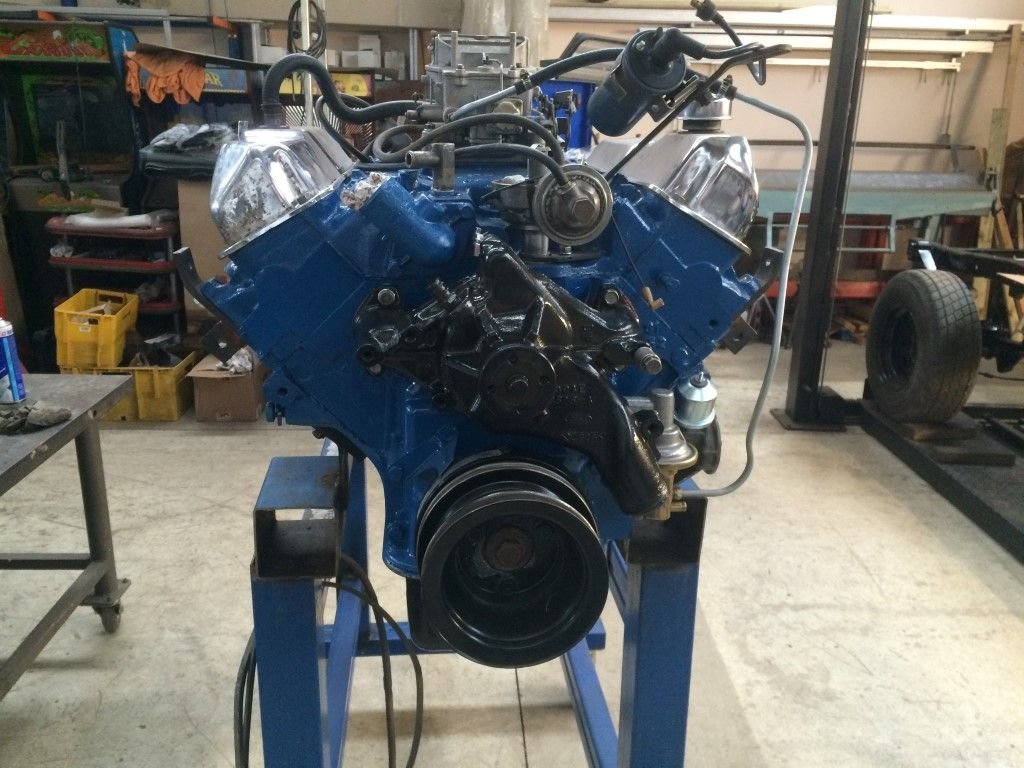

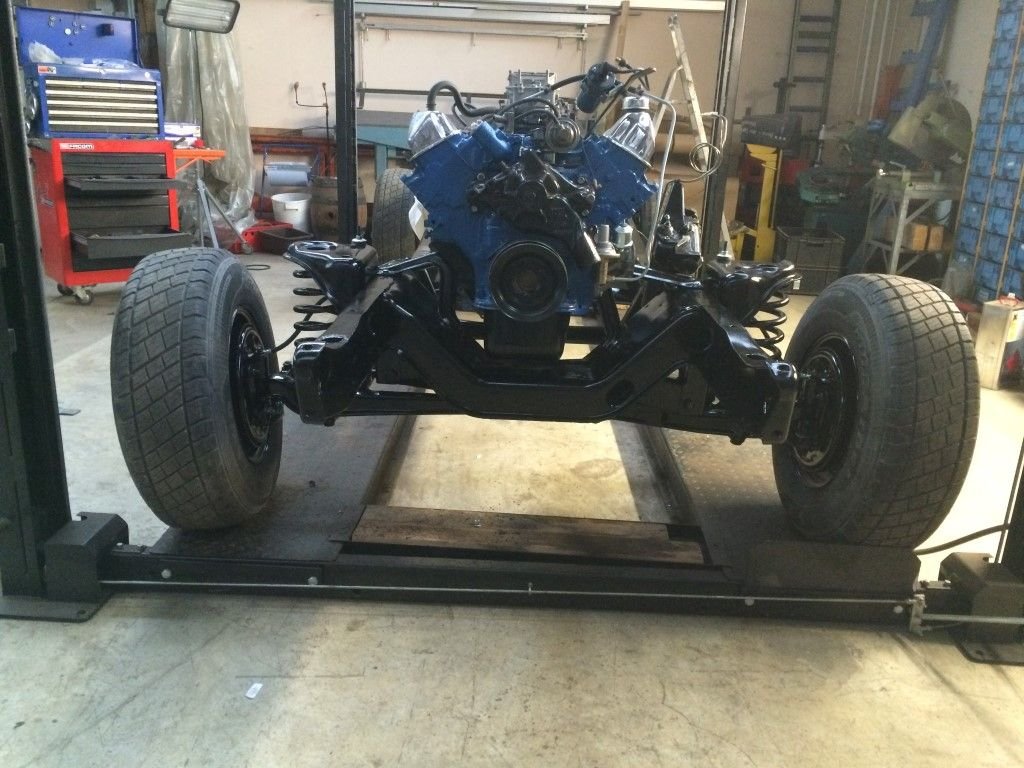

a few pictures of my recent work here.
The rear axle iss finished
frontaxle also...

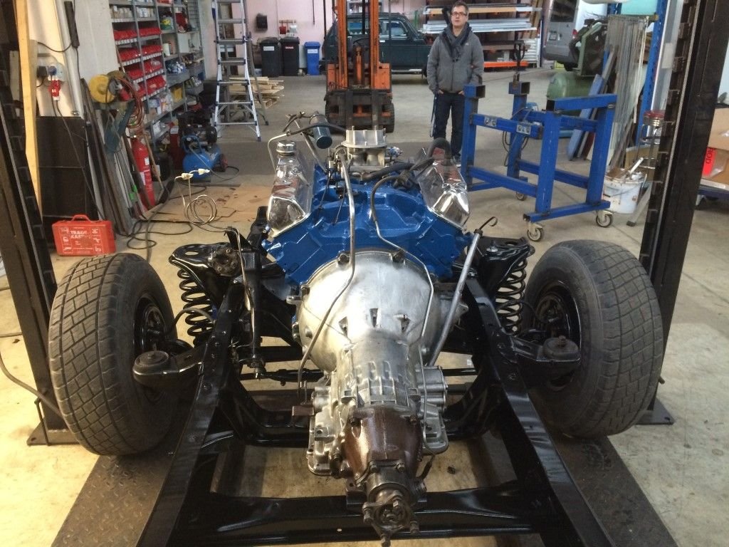

Next step: the motor and transmission must go back to his old place:

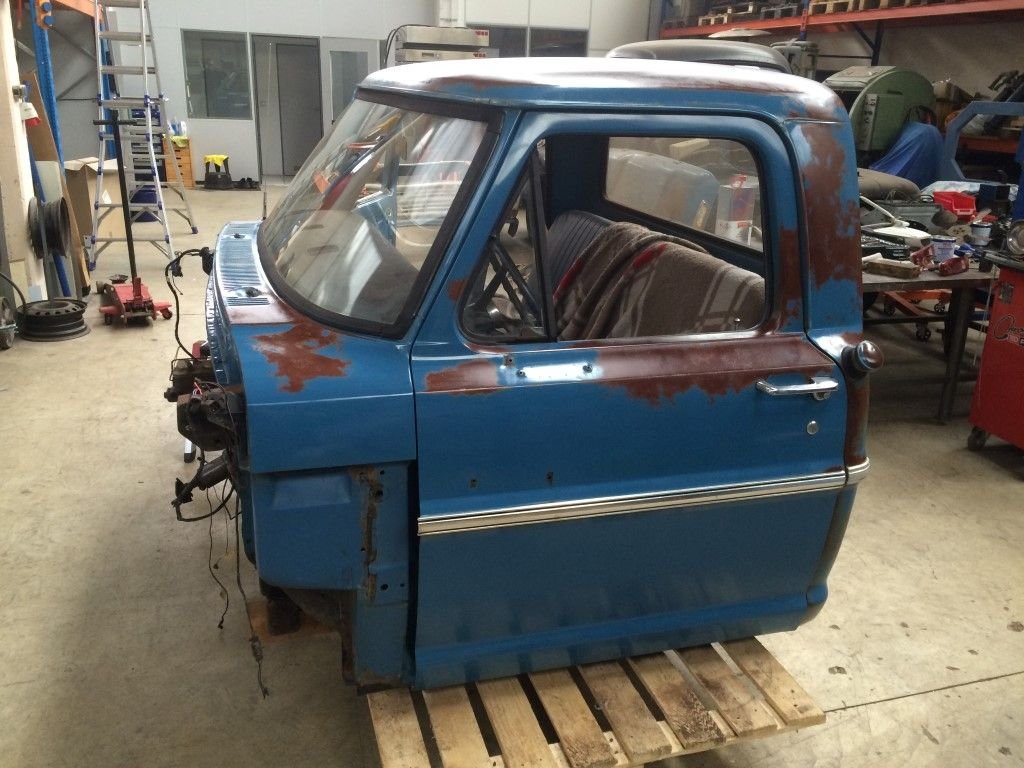

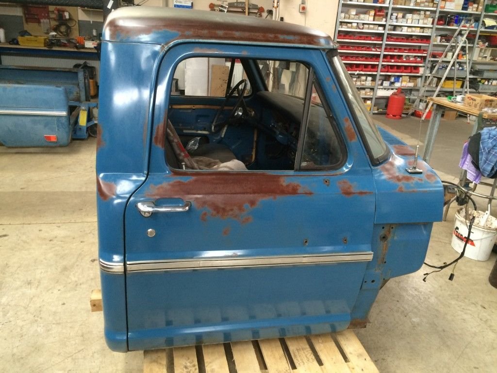

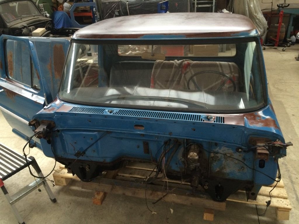

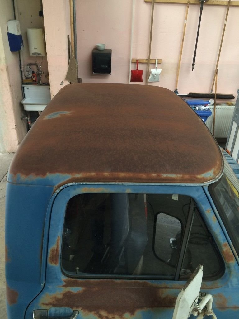

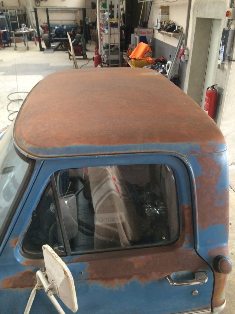

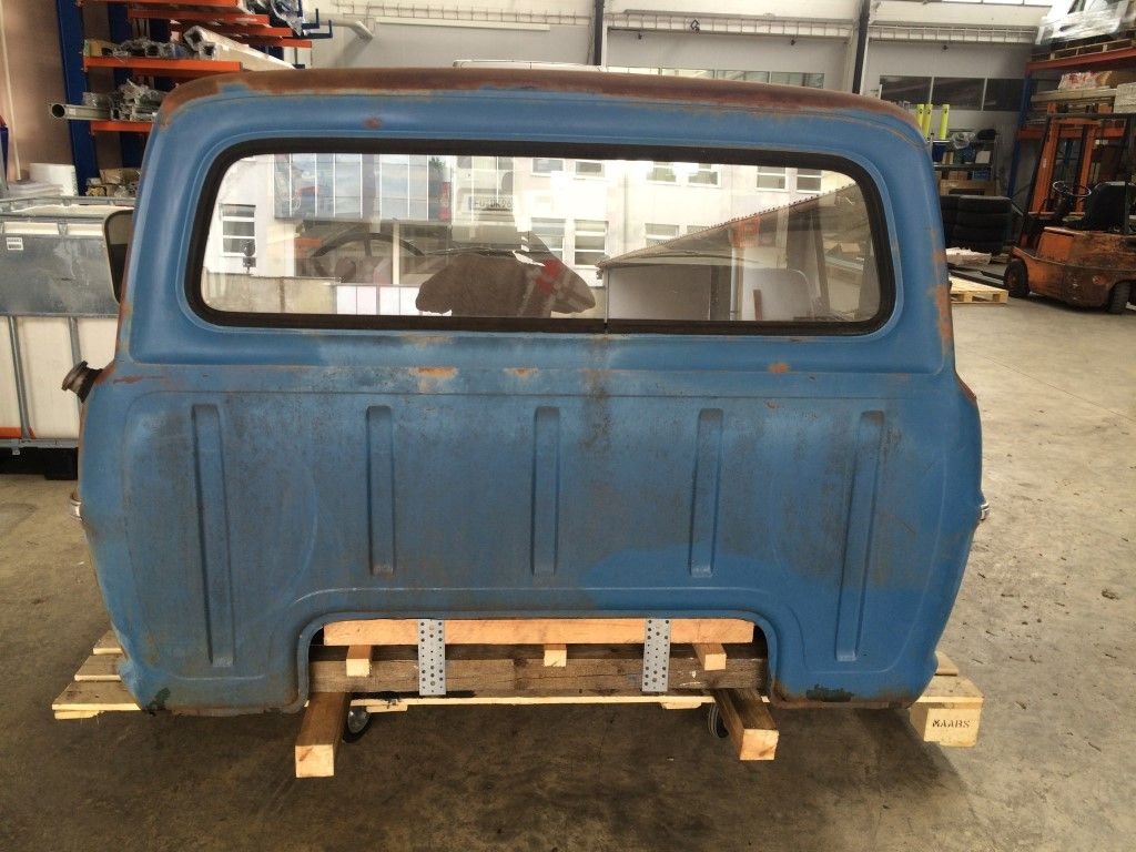

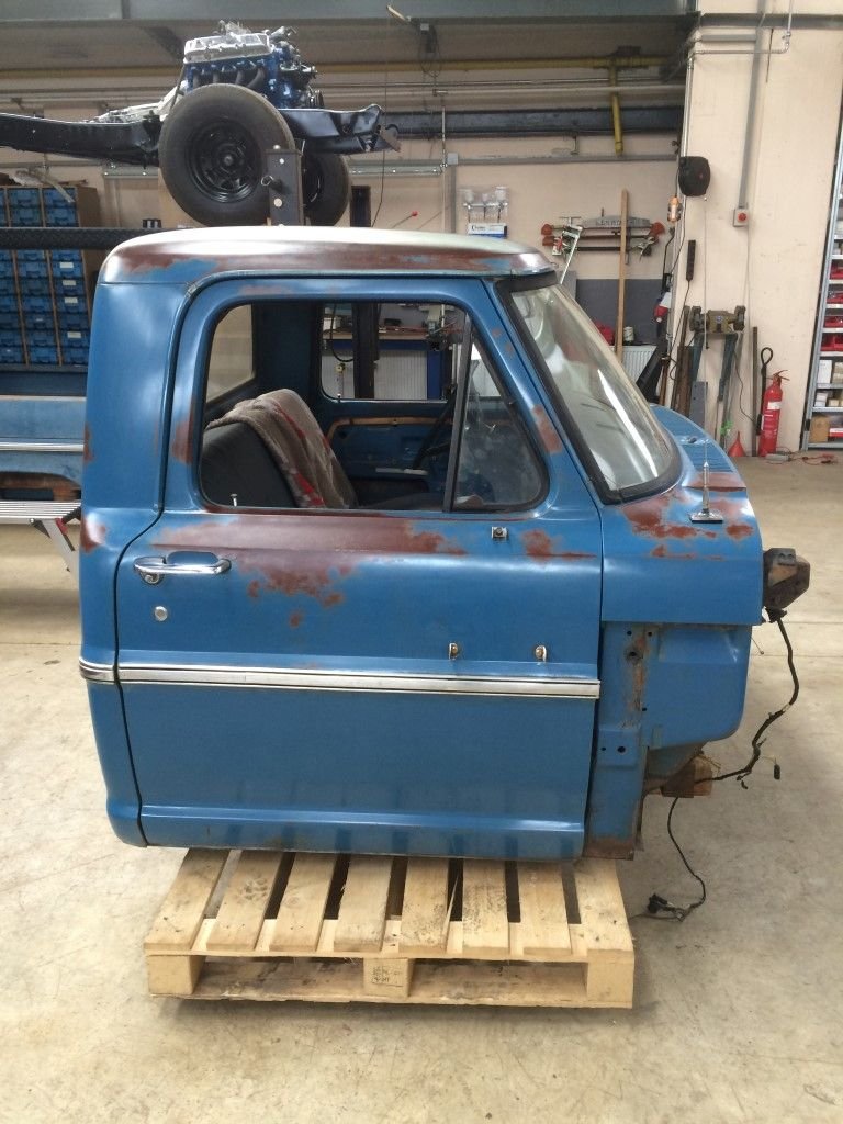

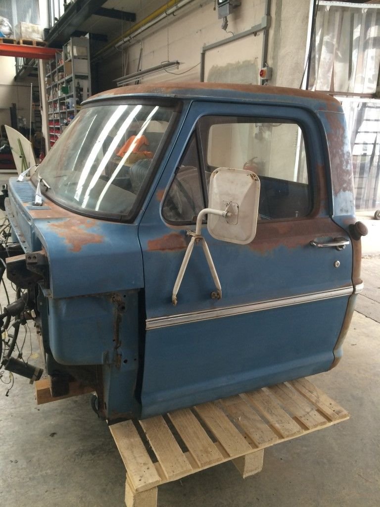

Now i cleaned the cab.
Before:
After a lot of hours....

Lookin good! What clear did you use, and how did you prep for it?

Nice job! Maybe it was the pics, but it looked like your rear brake shoes were wrong. Looks like one side had 2 primary shoes and the other had 2 secondary.
It´s called Owatrol. Sorry... there are only german informations here. It´s a kind of oil, which is normally used for wood protection. But they're doing a special mixing for metal conservation.
I apply it with a sponge and rubbed it after 20 min with a cloth. At the pictures it looks very shiny but it´s not so.
Holy moly.... your right I did not see myself. The PO has made this job Now I have to look like it is right.
Thank you that you have brought to my attention
