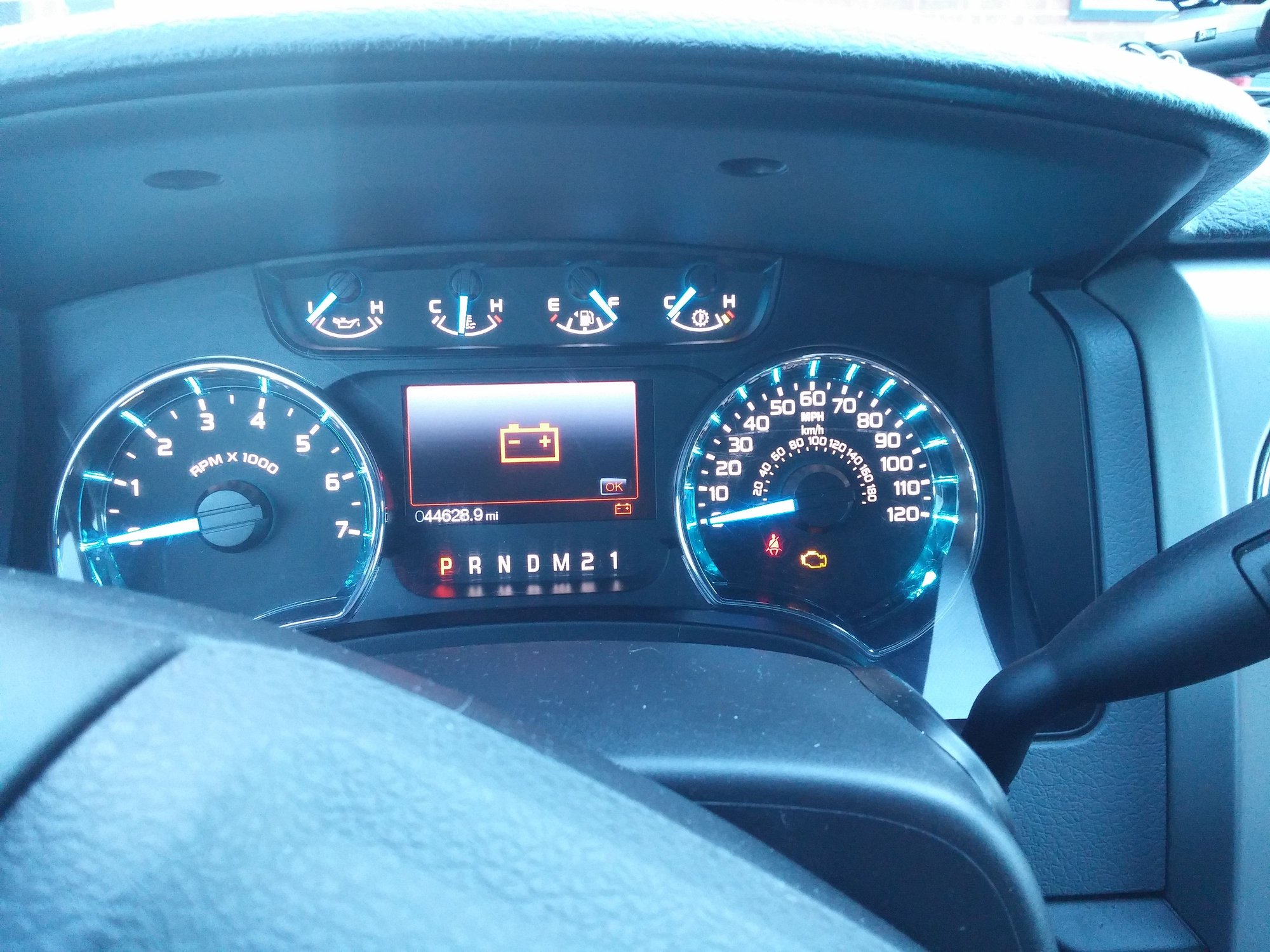

Low battery warning
So I am receiving this notification when I turn my switch on to just have my radio on. I don't have a reason to believe that the battery is bad as I just bought the truck from a dealer last Thursday. Searches come up it is a known glitch in the safety feature that cannot be disabled and is happening with good batteries. Any ideas please?

From the dash pics, it looks like you are a 2011&up which is subject to ford's battery management system.
For more info check out this link:
https://www.ford-trucks.com/forums/1...ally-dead.html
In short, if they hooked up jumper cables to get the truck started the truck may have not had time to "learn" that the battery isn't dead.
The easy fix at home is to make sure that you hook the battery charger up to the chassis ground rather than the battery cable so that the PCM stays "in the loop".
Whether your battery is dead or not, it would probably make sense to do this in your case so that the computer can see that the battery has been charged. if you have a charger/maintainer, I'd hook it up and leave it sit over night.

Ok an update... The old battery voltage was low so by design I was getting this message. So they gave me a brand new battery. Before I drove off I test it again, and I get the same message on the new battery. Perturbs me a little.
So the tech pulls up his support stuff, because he has never seen it before, and as it turns out, that same message appears if you have just replaced or recharged or battery too. The fix is , the new battery has to sit undisturbed for at least 8 hours for the system to report the correct charge on the battery.
If this does not fix the issue, it is likely some bad computer module of some sort. Something to take the better part of a day to trace and fix.

for what it's worth, it needs to sit completely undisturbed with the key out of the ignition for 8 continuous hours for the process to complete.
if you open a door in that 8 hour period, the timer resets. if the key is left in the ignition, it disrupts the cycle as well (and drains your battery too)
charging the battery with the ground wire attached to the chassis ground also eliminates the need to go through this re-learning process.
they are supposed to be able to go in through the diagnostics software and tell the computer that the battery is new too.

Ok a final update on this issue...
Let it sit overnight (at least 8 hours) and it seems to have fixed the issue. Makes me very happy!
