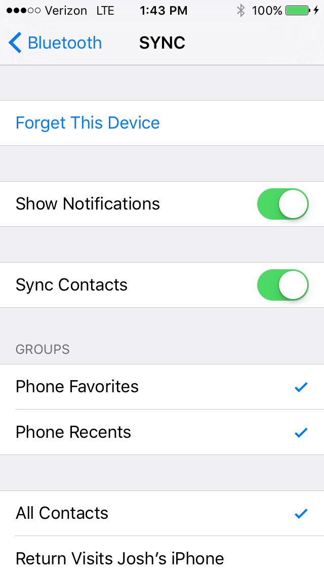

Hi EFD162,
Did you check the settings on your iPhone?
Go to SETTINGS, BLUETOOTH, select the blue "i" next to SYNC, and make sure SHOW NOTIFICATIONS is turned on.

I have the same phone . I turned notifications on in phone setting and I now get texts.

Ok, thanks for the input. The phone settings is allowing notifications . So is "i" in the sync Bluetooth menu. I will now try to plug in via usb. Hopefully that will solve it. If not, next step is the Apple Store or wait for a sync update fix .

FWIW I am version iPhone 5 9.2.1 on Verizon.
And again for emphasis make sure Show Notifications is On.
