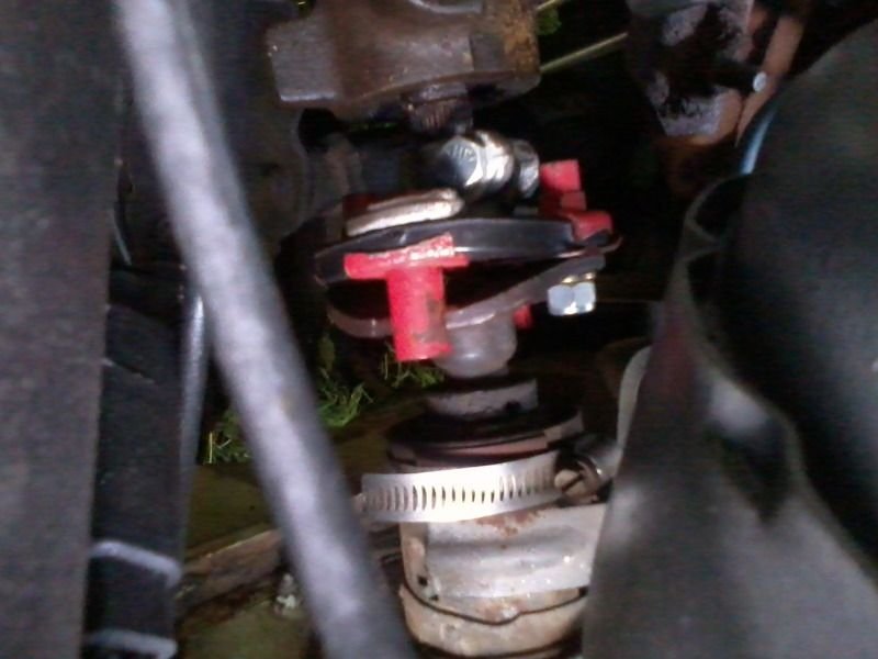

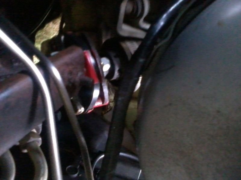

I got a polyurethane one that's old but still in good shape. Not sure where I bought it. It was noticeably better vs a fresh OEM rag joint. For hardware I cobbled together good condition parts from 2 other columns from a junk yard to make one good rag joint/steering coupler.

Originally Posted by RTT
Thanks Snacky................I read that is not east to do, drilling out the old posts etc... Sounds like you did a good job. I will try to find out more about the Lars 202 first . If Lars does not have big posts I may try your method or weld a piece of pipe over the small post on my new small posts. I do appreciate the reply............
sure!
https://shop.broncograveyard.com/images/ragjoint.jpg
Not sure if this is it... the kit looks exactly the same. Here are some pictures after i completed the upgrade which may give you some ideas.
Pretty sure someone like Jegs or Summit carry a ujoint that could be easily adapted without welding anything. Need go back and read more of the thread but not sure if you are considering a oem ford tilt column but if you are working on the rag joint and want tilt now is a good time to get it. I think tilt starts as a factory option beginning in 79? 79 Floor shifter column with tilt and power steering is very rare now adays
I didn't realize I wanted tilt until after I restored a floor shifting column from a 68 f250 and it doesn't have the greatest clearance with the bench seat upgrade using oem 72 slider brackets and a 88 full bench seat with center armrest and headrests
