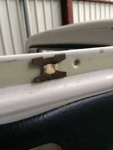

Hi guys,
In order to replace the locks on my 1970 F250, I needed to remove the aluminium trim which is covering the screws for the metal door insert. Removing it went smoothly, but how do I replace it ? There must be an easy answer I guess.....
The picture shows it still attached to the door, it's the trim with the black center.
Thanks on forehand !
Martin

Thanks guys,
These are still in the panel, hope this clears things up. Reversing my action didn't work unfortunately....

Originally Posted by martinkik
Thanks guys,
Martin

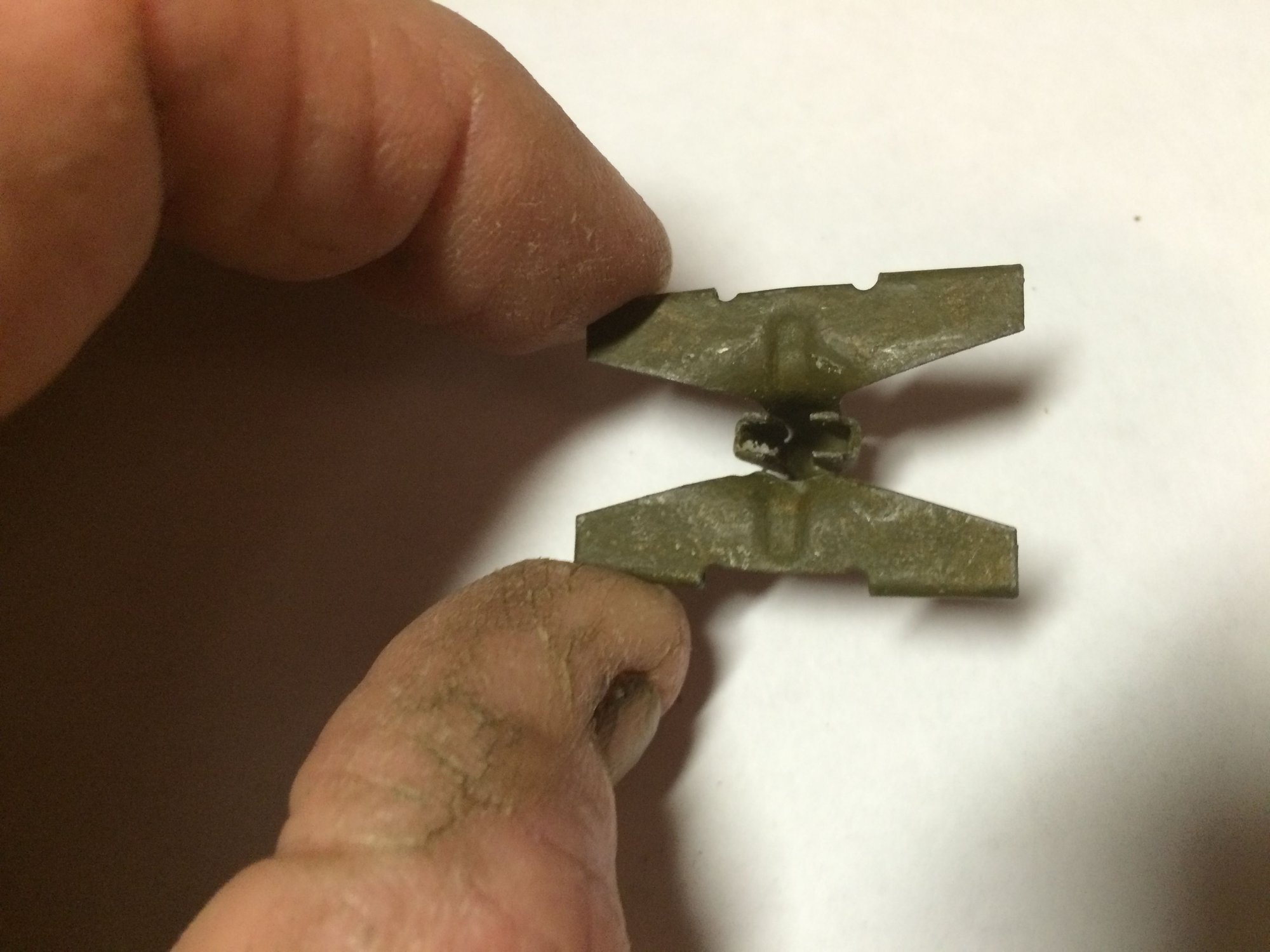

martinkik: the way the clip is in your picture they lock in front and back, if you will take a pair of needle nose pliers and squeeze between the v shape sides they will pull right out. Here is a side picture were you should be able to see the locks, and a top picture with the foam out of it. On the top picture you can see the **** sticking up, that is what you want to squeeze together.

Wow, this is really helpful !
