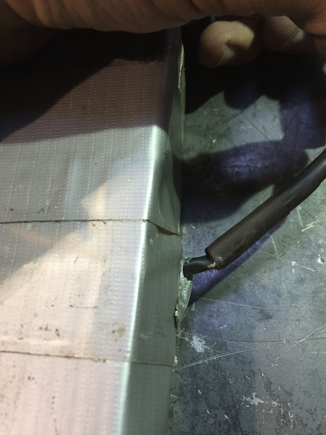

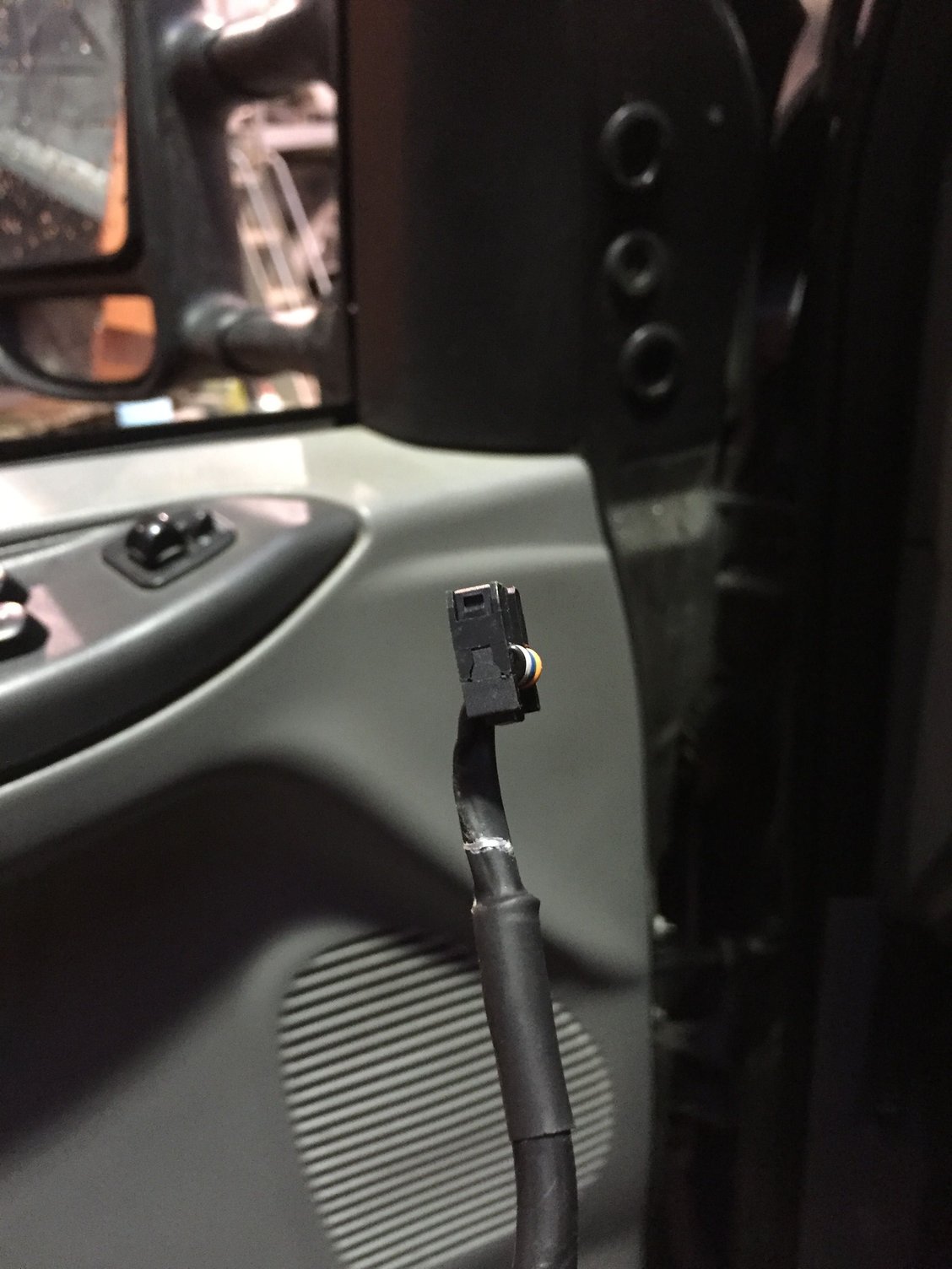

Well I've had problems with my DP cutting out here and there since j got it. I love the chip. The power it delivers. And the simplicity of the system. So rather then ditching the chip I've been slowing trying to resolve the issue.
1) checked all connections at PCM between chip and wires, and wire and switch. All good. No improvement.
2) ditchted the HID lights. slight improvement.
3) today I got my new rotart switch and 4ft cord for my tuner. And put them in. (Because I read somebody else had a cord that was kinked and bent causing them problems ) it seems to be more responsive , and smooth when I switch my settings.
Also the old cord I had ferrite beads on it, 4 of them. The new cord seemingly has some sort of power surge protectors built in on each end. So I didn't place the ferrite mess on it. Will keep y'all updated on how things go. And will post pics of my old cord and some concerning areas that looked kiinked and bent

Hard to tell in pics. But you can see a flat spot and bent where it exited the PCM
