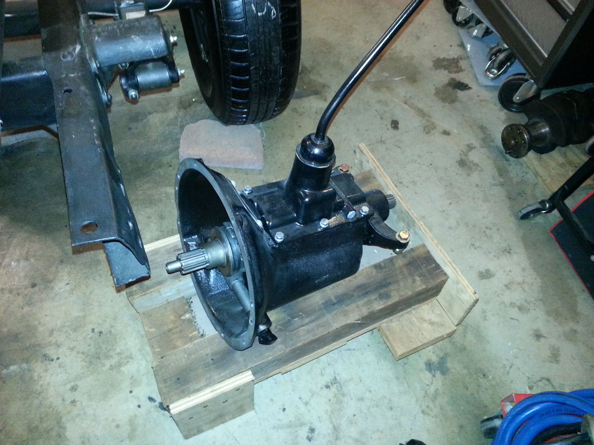

I just got by Flathead 8BA back from the machine shop which I will be mating with a 3 Speed 78-7006 (case). The fly wheel on this 8BA had 6 evenly spaced bolt holes. I never thought to check to see if it was a Merc crank. Somehow I ended up with a pressure plate to match this flywheel but not sure if its rebuild-able and cant seem to find any online for sale. I do have another flywheel for the long style pressure plate. I measured (13inch) and weighed (32lbs) both flywheels and the only difference is the bolt hole pattern. I'm thinking of using long style flywheel since there seems to be plenty long style PP online. Is there any reason why I can't use the long style flywheel if the crank is a Merc?
