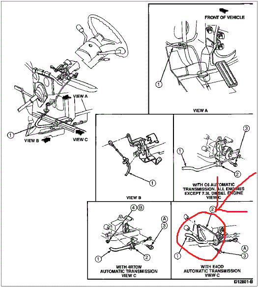

On my E4OD I have a bracket that holds my shifter cable. This bracket has 2 bolts and is up and to the front of the MLPS.
Does anyone have the bolt and thread size for the 2 bolts? I am missing those and need to get replacements.

Yes, those bolts. Do you know the size?

no,sorry.if i did i would of posted the size.just helping by showing others what ya need since i had pic handy.good luck.
wild guess though;
something like a 7/16 diameter bolt.course thread iirc and probably around 3/4 length.im probably off on all three accounts lmao.might be 1/2 bolt actually and maybe an inch long.a couple runs inside a hardware store id have things narrowed down.probably metric bolts anyway too? not much help.

Part number for the bolts is 56137s100 and the size is 3/8-16 x 0.62"
