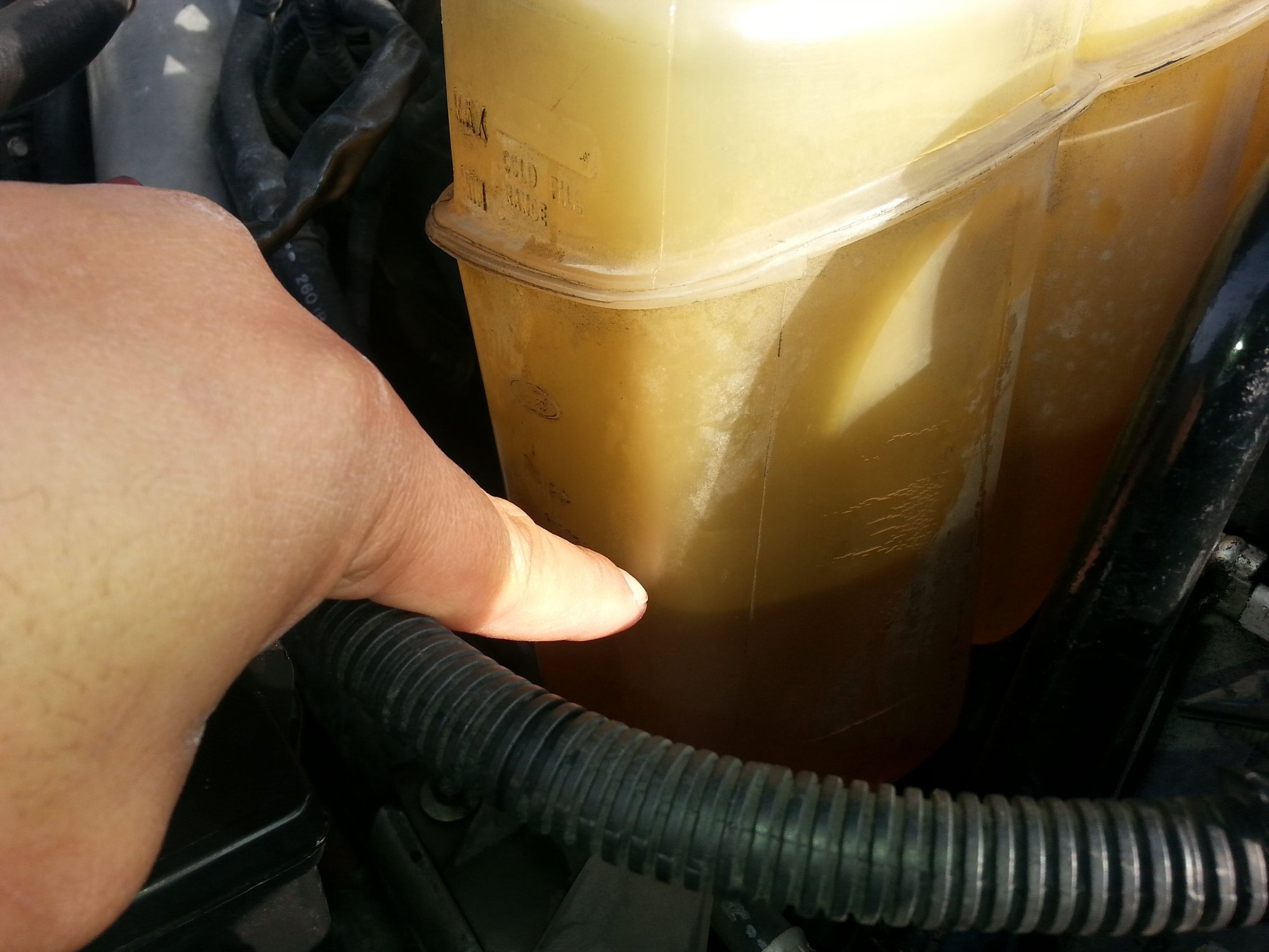

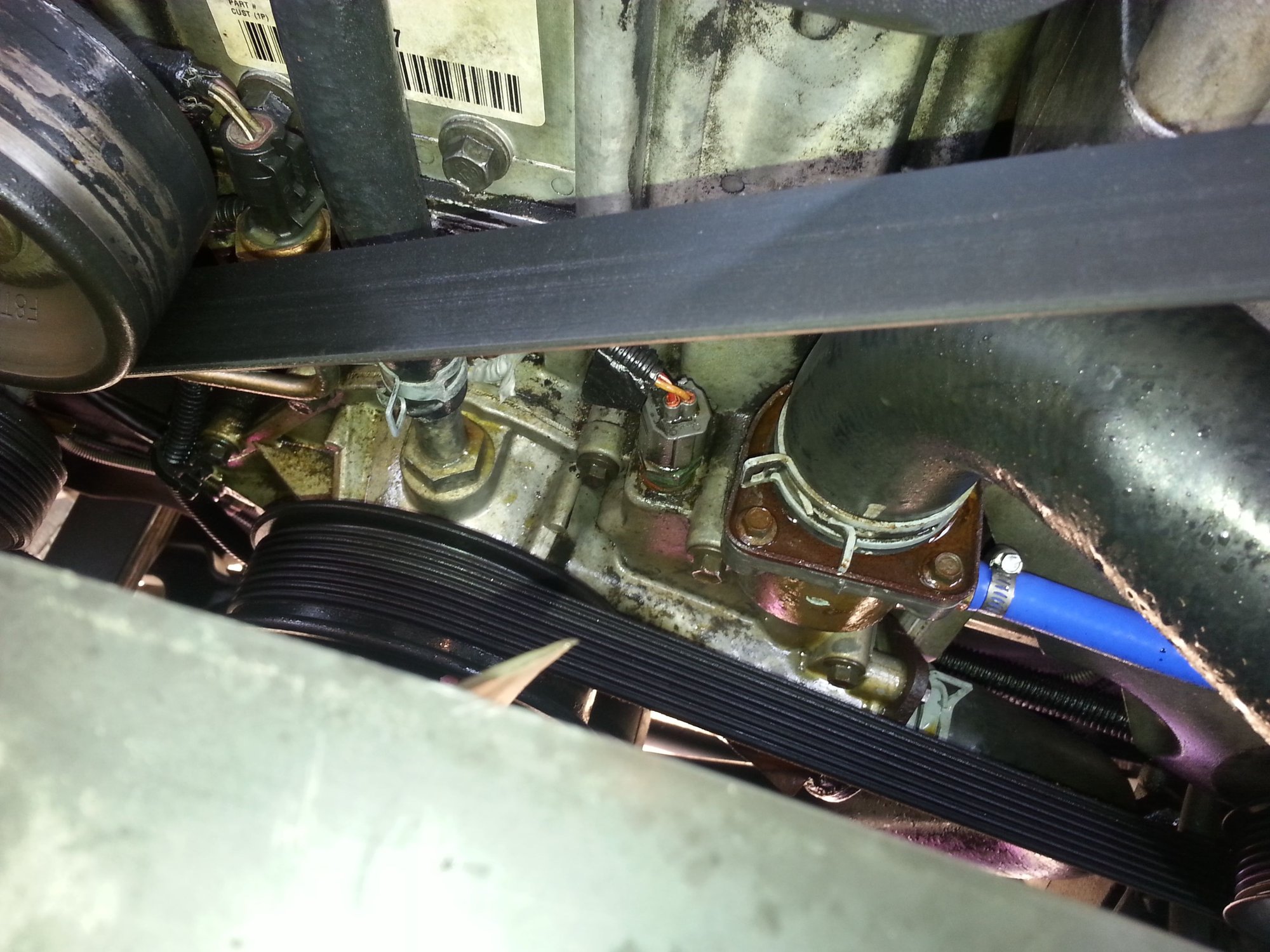

Finally got time to take some pictures this morning. Had a busy busy weekend thus far. I've already ordered a new T-Stat and billet housing. Hopefully they get here this week. With the wetness I felt above the pulley I think the pump maybe on its way out....just couldn't figure a good way to get myself positioned to see it.
Passenger side
Looking up from driver's side
Was trying to find the weep hole....phone is too big....stuck hand up there and its very very wet
Coolant level was full Friday morning heading to work. Its sat since I got home around 1430. Coolant level is now down to where my finger points
View from the top

Release the tension of the serpentine belt and wiggle the water pump pulley. Betcha a PBR the water pump is the problem. The coolant coming out the weep hole underneath gets flung hither and yon, tracking it gets impossible.
You have choices on the pump, either Ford style aluminum or iron International style. (IH iron link is for complete kit, just pump here.) To me the style you choose depends on what coolant you plan on running. Your X came off the lot with Ford Gold, and it looks like the same is in the degas bottle now. Running Ford gold or the top dog $$ ELC variety, you can stick with Ford Al waterpump and skip the coolant filter. If you want to run traditional green an iron pump with built in filter would be good, or the Ford Al with that Dieselsite coolant filter. I ran gold with the coolant filter for the last 4 years, used two filters and found zip nada zilch in the filter media when I cut them open. I removed the coolant filter setup in October. Filtering the coolant is well known to be unnecessary with the ELC, and equally so with the gold, in my experience. Use your google-fu wisely to research your choices.
Definitely a billet thermostat housing and a thermostat with integral rubber gasket. I've seen persuasive arguments both ways on thermostat temp, but I settled on stock in case I need replacement out on the road. Tempted to try a 203* just for kicks for local use.
