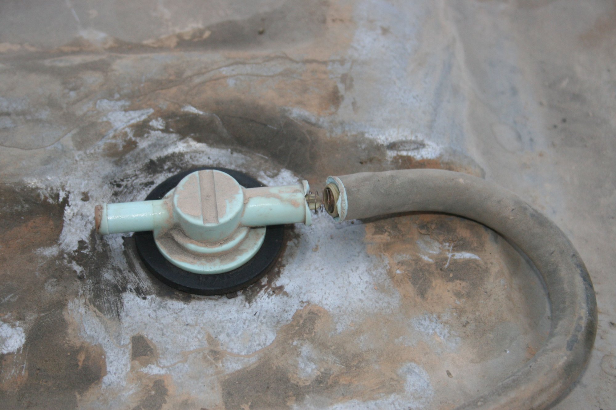

Can anyone tell me what part this is on my rear fuel tank that I accidentally broke and whether it would work to just jb weld it back together? I snapped the hose end off and it apparently has a little spring in it and a little plastic plunger. I think that I have it in the proper orientation as to how it came out but if anyone knows otherwise please let me know thanks.

That is the tank pressure relief valve and vents to a carbon filter canister. You should be able to buy one, but JB weld would likely do the trick. Christopher, don't cheap out on the pumps. Saving a few bucks only to have to repeat the pump replacement is not worth it. Airtes E2064M, Carter P74108. ACDEL 43-104 and walbro TU201. IMHO!

That part is called a roll-over valve.
Fuel Tank Venting
Fuel vapors trapped in the sealed fuel tank are vented through the orificed vapor valve assembly in the top of the tank. The vapors leave the valve assembly through a single vapor line and continue to the carbon canister (located in the engine compartment or along the frame rail) for storage until they are purged to the engine for burning.
