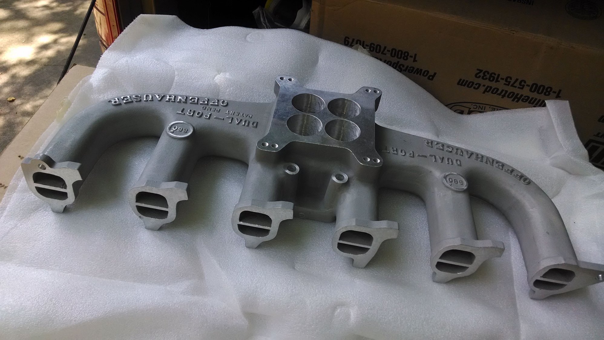

I agree with Fordboy. My understanding of it is that you still have an open plenum if you have the offy C installed.
This is the offy dp, it separates the primary and secondary runners into two separate runners. Hence the dual plane non open plenum verses the open "C".
The 4 hole spacer maintains the separate runners on a dp when a spacer is needed for possible clearance and or heat issues.
On a " C" all the 4 hole spacer does in addition to aiding clearance and helping heat issues is change the total volume of the intake.
