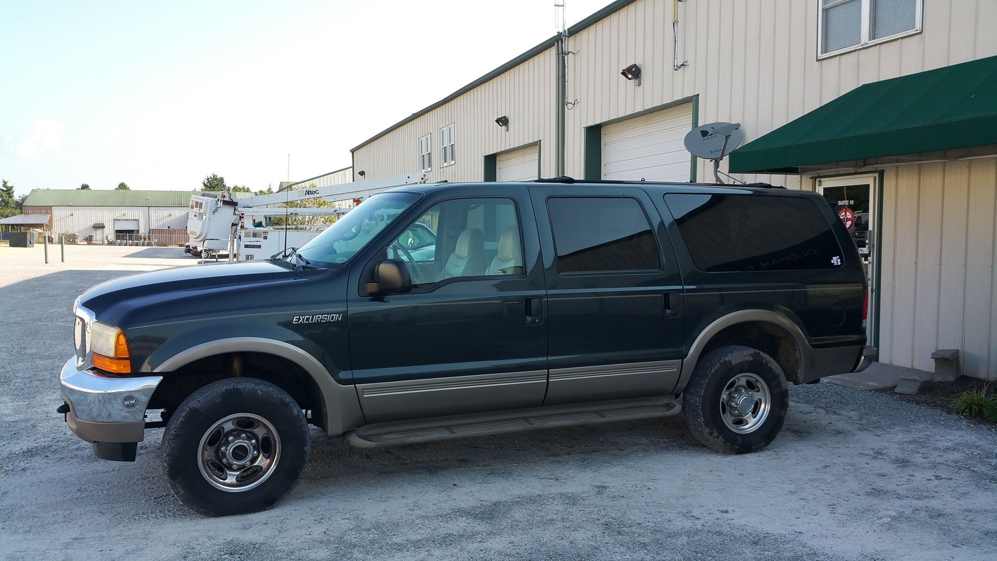

Taken the morning i bought her, before it was mine

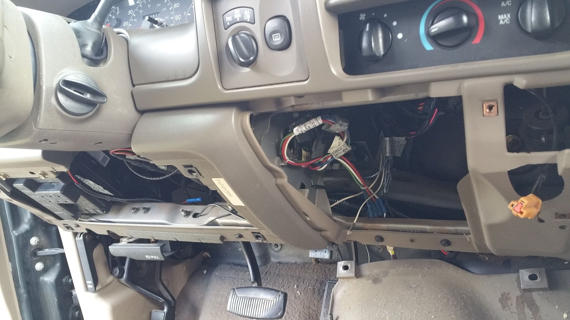

Wiring for the siren hidden in the center console

Today I finished my wiring for all of the accessories that are powered when the park lights come on. I put a relay under the dash, and used the parking light wire at the headlight switch to trigger it. I used one of the customer access circuits to pass it through the fire wall and hooked it up to B+
Relay for all things parking light related
Customer access circuit: I FOUND IT FINALLY!
