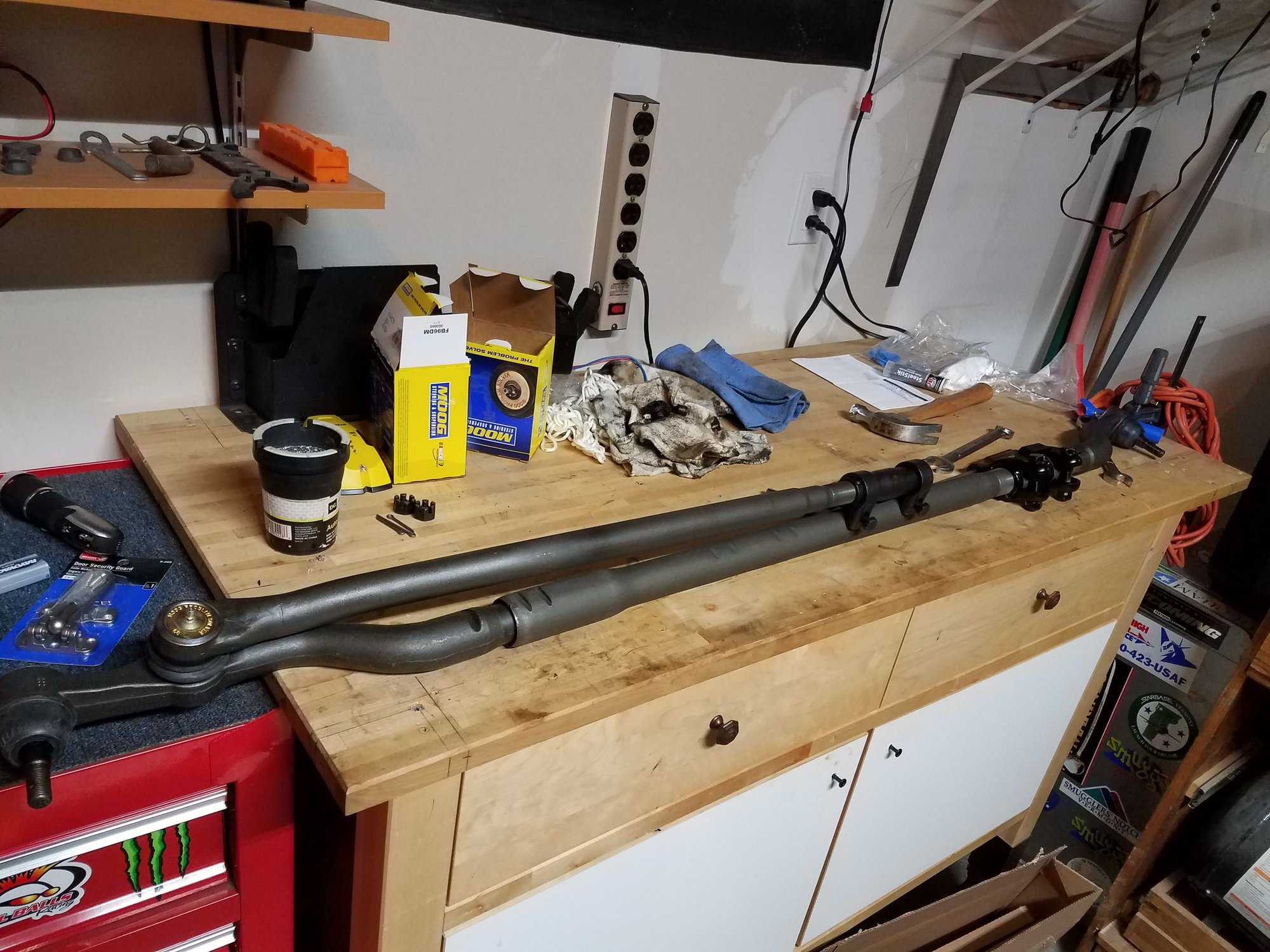

New steering parts came in finally!

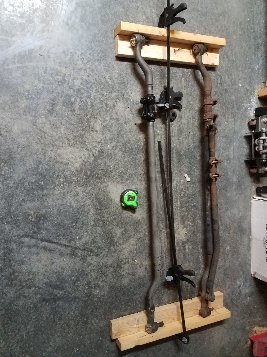

Well i finally got started on my new steering linkage. I'm too cheap for an alignment, and it was fine before, so here is my home made alignment rack!

Looking good!
I used the tape measure from center of tire to center of tire; front and back of tires.
Looking from the driver-side tire to passenger side tire, CW on the center link causes toe out; CCW causes toe in. Same technique to straighten the steering wheel, but use the center link (upper) going to the steering box.

my alignment was good as far as toe was concerned, so instead of fooling with it on the vehicle (the new linkage) i pulled the old out all together, and made the new one match lengthwise.
