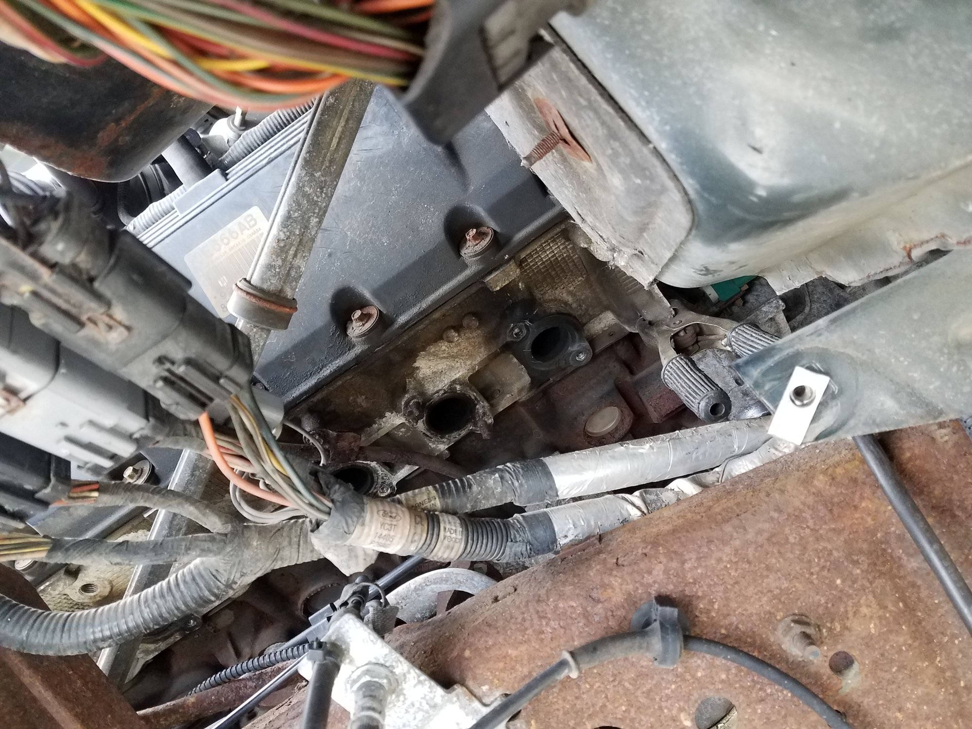

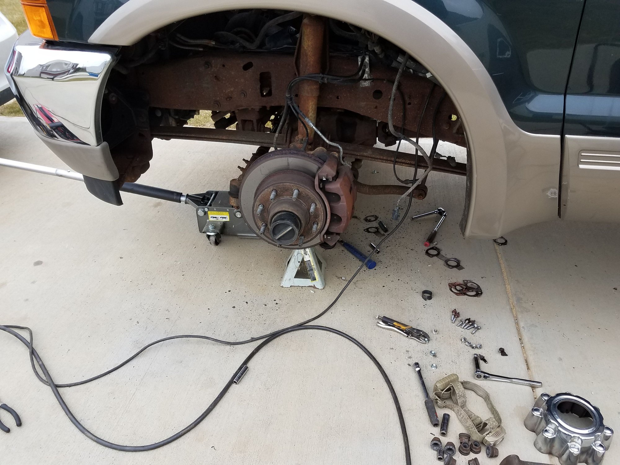

Halfway done with the stud replacement I figured since everyone said that the driver side was the most difficult because of wiring and steering shaft, I'd do it first. there were 4 already broken, 3 I broke taking them out, and 3 came out just fine. I skipped the drilling and easy out attempt to go straight to the big guns and I used the welder to get them all out. worked like a charm, and got them all replaced with the stainless ones Broken studs
10 shiny new studs

Nice work, and yes, the passenger side should be even easier!
Did you leave the shock mount on the frame? I pulled mine off for this job for the extra room.

I left it in place the only things I removed were the wheel and tire (which had a nail in it I plugged) and the inner fender

Dipstick Tube!!!! I just saw it in the photo. Mine snapped off where yours is rusted. Apparently you need the manifold off or to tilt the engine off of the mount to replace it.
