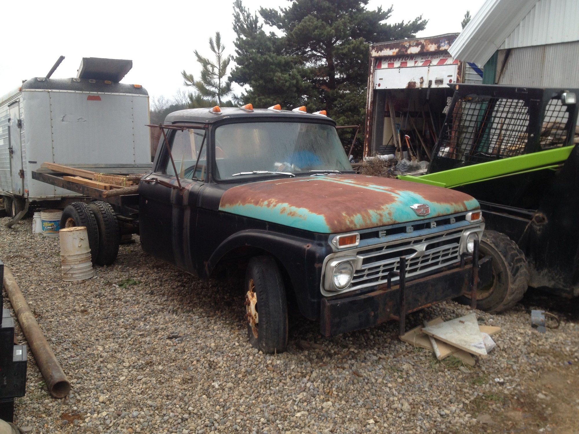

I'm new here and figured I'd try posting a question on a truck I just purchased. These are the only numbers off the door I could make out. F35ck495945. Could someone let me know what I have. . Also could use help posting pics. Thanks

F35 = F350
C = 292 2V
K = Kansas City, MO Assembly Plant
495945 = Assembled January 1964 for 1964 model year.

Thanks for the help. A lot has been swapped I believe cuz it looks like a 66 to me
