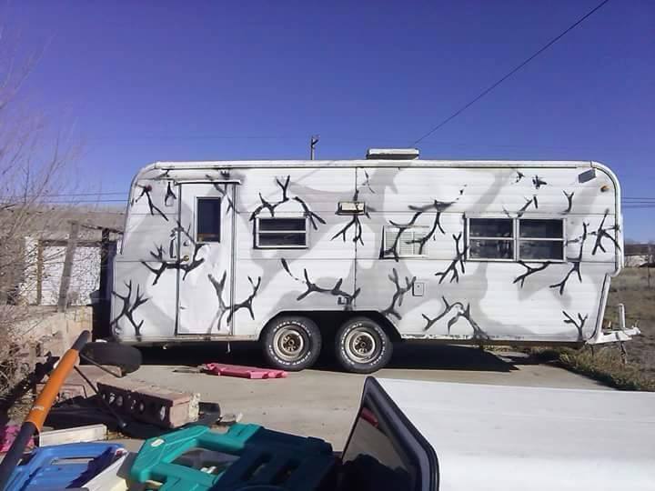

Can I haul this trailer...

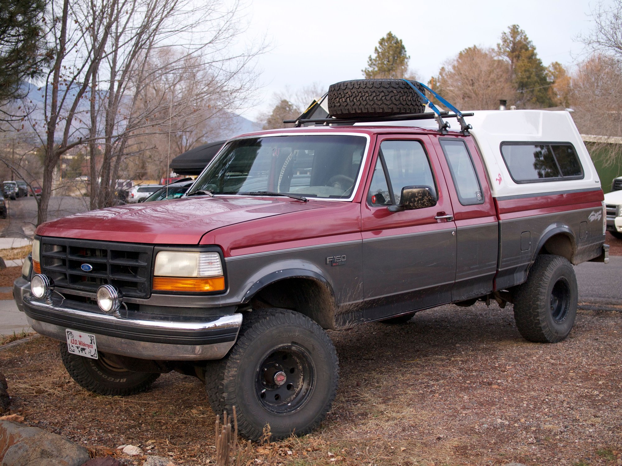

With this truck(1993 f-150, 5.0, v8, 5-speed manual)
I'm not really asking SHOULD but more of a COULD I pull this for a few months before I get a newer truck...

yeah, you can pull that one if you have the right wt distribution hitch and a trailer brake controller.
I'd image that trailer at maybe 5K lbs.

Yeah you can pull that but it won't be a lot of fun, if the truck has anything less than 4.10 gears it'll struggle everywhere all the time, takeoffs will be hard on the clutch and don't plan on going faster than 60mph.. because the truck simply won't get there.

I don't see why not, but look at the trailer weight and with distribution bars you should be fine.

I'd say you can. I'm not normally a WD fan boy (if I can skimp out on one I will, hopefully I don't get scolded too bad for saying that) but with that lift, I definitely would to retain control.

I would not hesitate to pull that camper with that pickup. It looks like maybe an 18' camper? With the 5.0 you won't have a problem with power, unless your in a lot of steep hills. The clutch should hold up well too, just make sure to start out in granny low every time. Don't skip first gear on startup. A weight distributing hitch will help with handling, but probably wouldn't be necessary.
I say hook it up and go for a test run.

That truck came factory with the m5od. If memory serves me correct the transmission is the limiting factor for towing at 3500lbs. With that said, I have towed 7k with an m5od. On the open road you will have no problem. But 1st and reverse are geared very high, this is the reason for the low tow rating. I smoked my clutch in a 06 v6 5 speed(same transmission) backing a pop up in a tight spot on a very steep grade. You have the option of using 4 low, I was 2wd. I pulled a 4500 lbs deck boat all the time with that truck and never had a problem. So, the biggest factor in whether I would tow with that combo is the terrain you would be in. I would also be worried if the truck had 3.08 gears with the oversized tires.
