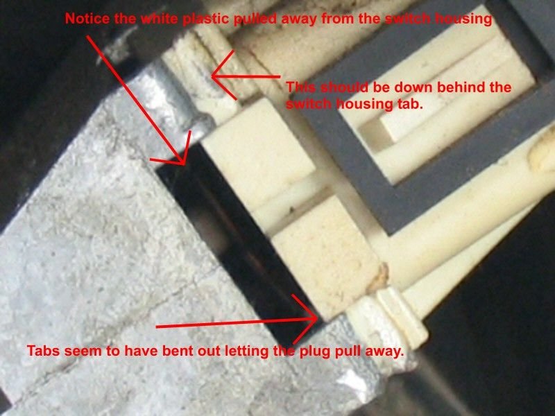

I was having a similar issue, but I had trouble getting the engine to crank (I had to use both hands to twist the key far enough) and every other position was "sloppy". The switch itself is two pieces, one plastic one metal, with the metal side "crimped" around the plastic to hold it together. Mine was coming apart making the switch faulty. I also discovered the mounting holes for it were slotted, allowing for alot of adjustment. I would guess it could be the faulty switch, or the mounting nuts have loosened up enough to push the hole switch forward and is now too far away to contact the start position.
I hope my wording makes sense.
I was able to find a photo of the faulty switch on google.

From what you describe MAYBE you are LUCKY and the actuator rod that connects the key tumbler to the ignition switch is not broken. A big job to replace that. The switch on the bottom of the rod is the ignition switch.
First I would see if the ignition switch is loose and will slide. If not loose I would loosen the bolt(I think) and slide the switch as far toward the steering wheel as possible. Then maybe replace the ignition switch next. You get the idea from there. I'm sure others will chime in.
