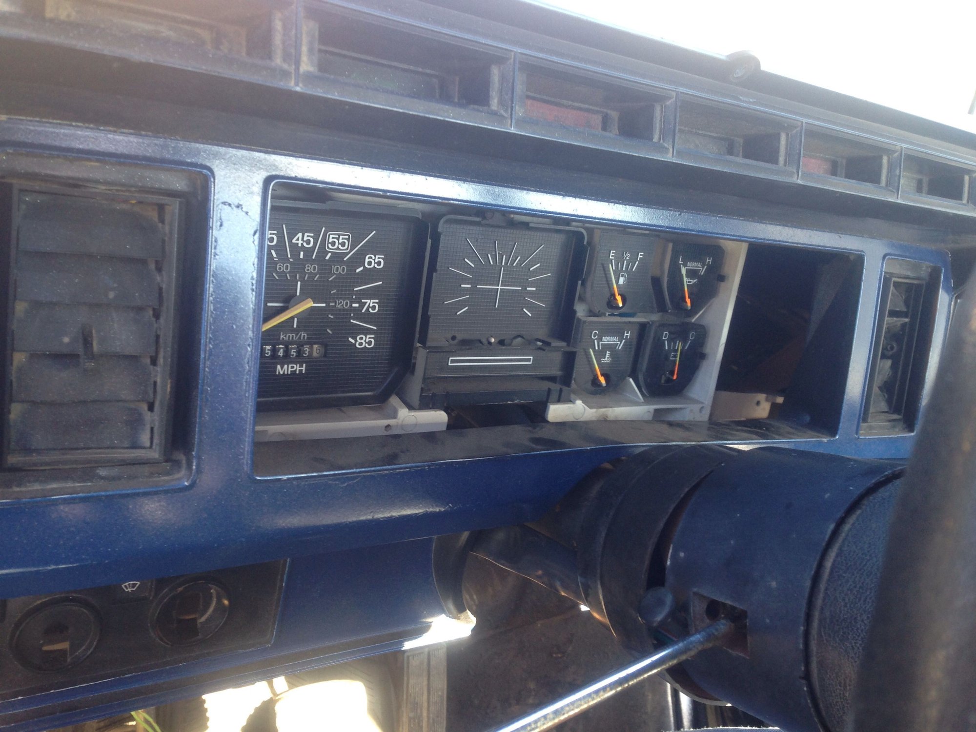

What you want is to create as equal distance as possible from yourself to the speaker as possible. Hard to do in a vehicle, I know. I have an 85, but since my dash is from an 86 or 87, it has vent holes in it that don't go with my heating system, the plan I drew out for mine is going to use those as speaker and tweeter holes, I'll put a picture up showing where they are located on my dash, you could probably cut yourself some holes and do it like mine, plus that hole your talking about in the center is where I'm going to put a subwoofer, it's literally the perfect spot because there the sound waves bounce off the window and it creates a really nice effect. Take the speakers out of the door, speaker location was an after thought those years, pick up 2 speakers, 2 tweeters, 1 of each on each side and you'll have a great sound!

That's ok, I can answer that with information that'll also help the op! Another decent location is in the kick panels, under the dash on the side, pop the panels out, cut out a hole and you have a place to put them. I just don't like the sound coming from underneath, I'd rather it come from more ear level, but if it's impractical for you guys to do that, the kick panels are probably the next best way to go! I'm getting ready to out and start doing some work on the truck, expect pictures in the next hour or so!

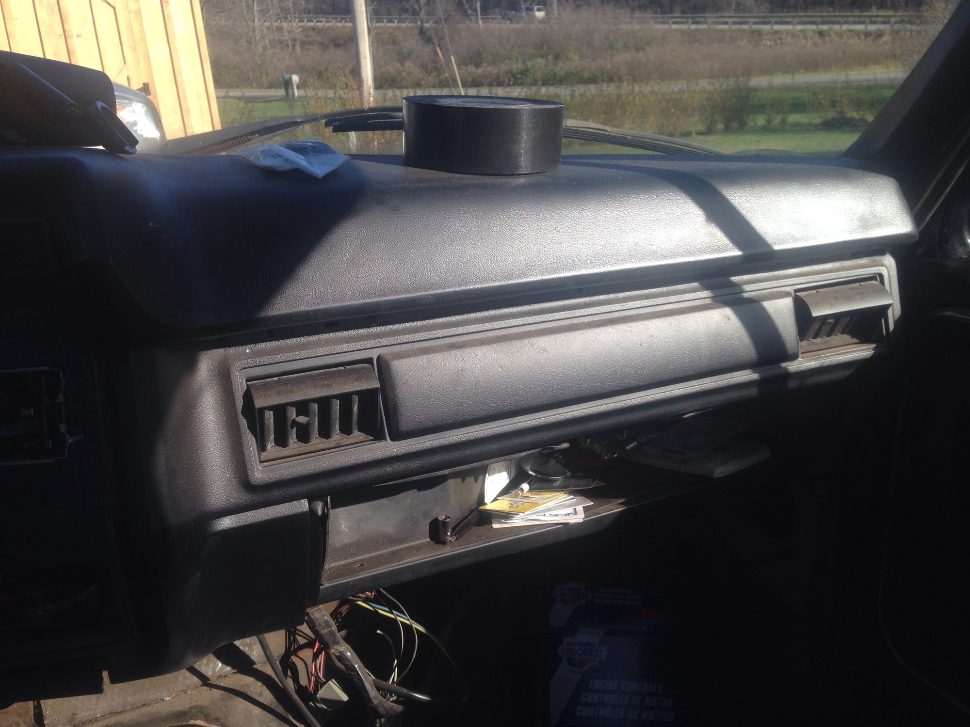

Yeah, 6 inch speaker won't fit, if you wanted it on the dash, you would have to cut a hole in the dash pad and put them up top on each side, I've seen that done before too and it does look and sound cool, it's just hard to cut the hole, and if you screw up it cold cost ya lol
