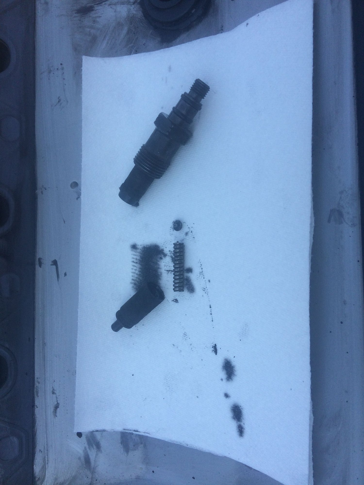

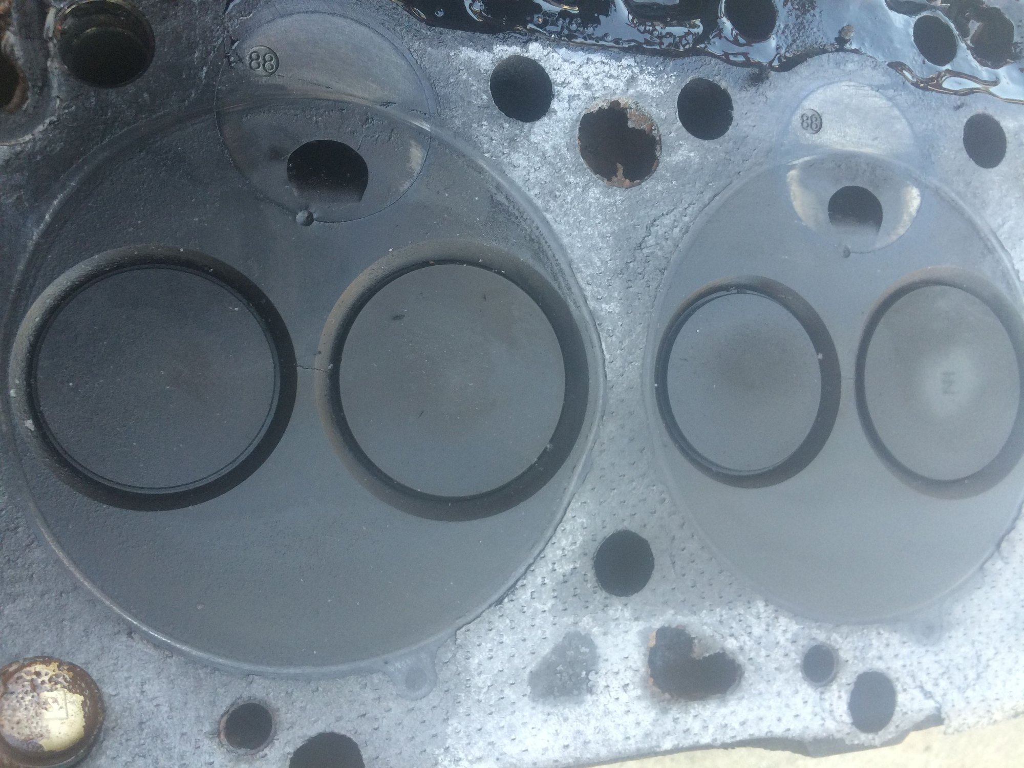

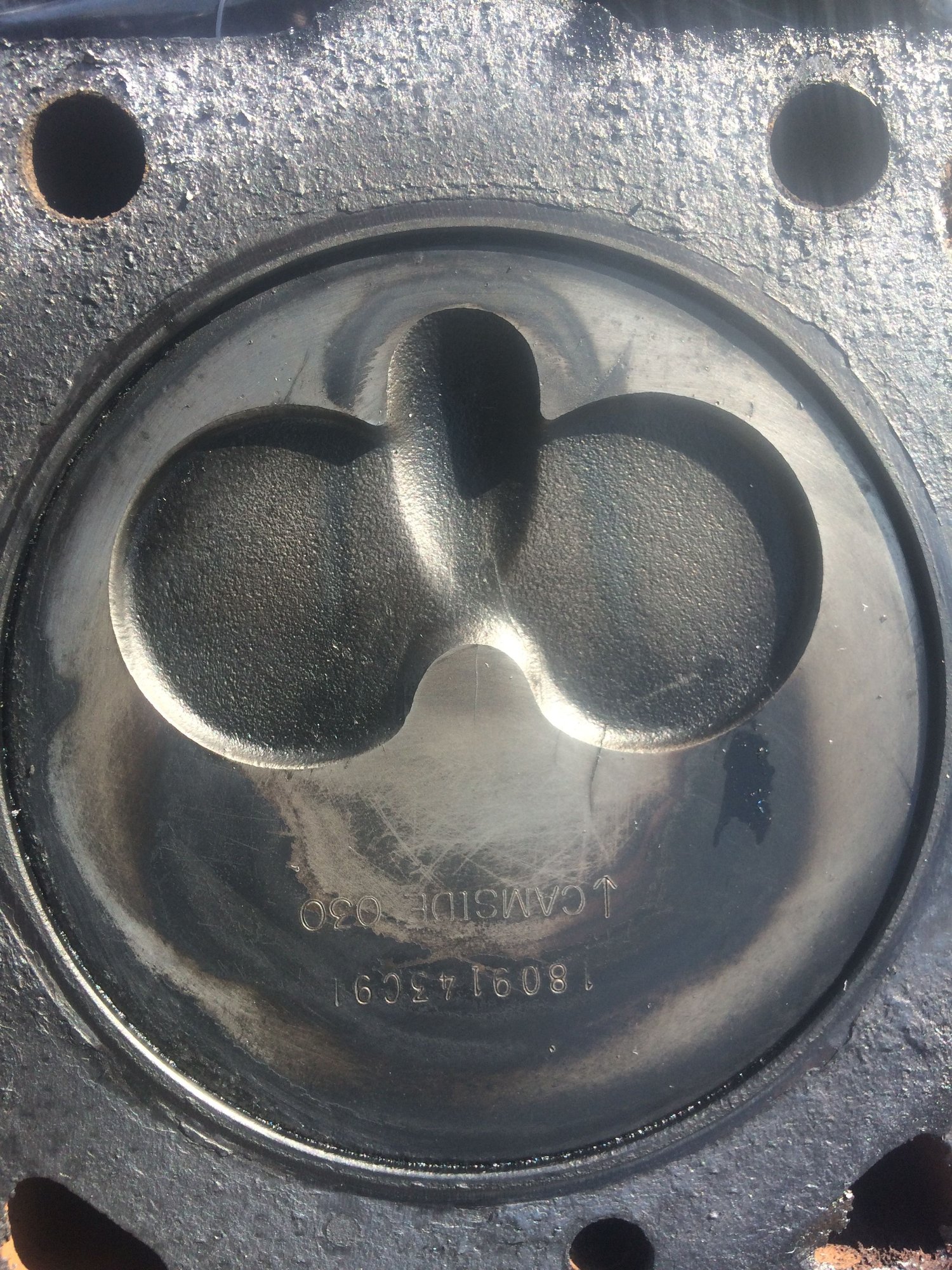

wanna know what happens to an over fueled engine?
look at pictures closely.
IMO, a pyrometer is a must on any diesel.
i cracked every single piston, and the driverside head is cracked inbetween every valve.
temps got up to 1250, sometimes peaking to 1300.
i tried to drive by pyro, but ended up cooking it.

Originally Posted by IDIoit
turn your pump down!
Was this N/A or turbo? Where was your pyro located? Were those sustained temps(minutes) or short(a few seconds)?
Thanks for the info, I love the pictures and having numbers to go with the carnage.
For the OP, turn your pump down! :P
And install a pyrometer!!

this was with a worn out 093 turbo.
still produced 10 psi.
and innercooled.
pyro located between #6&8 on exhaust manifold.
105 cc pump
when i saw temps reach 1200 i tried to stay out of it.
temps were only for a short amount of time.
