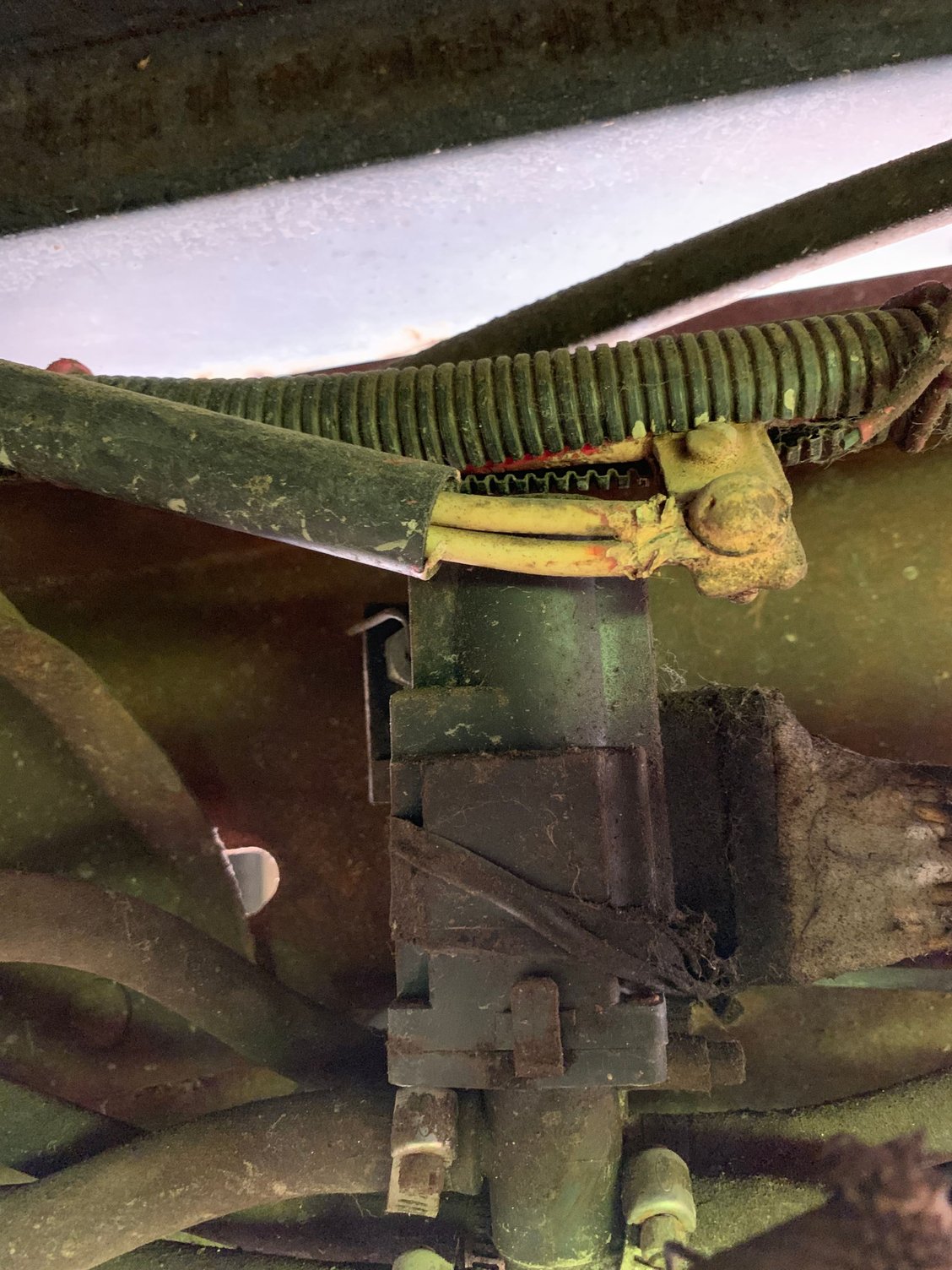

Is this the fuel pump?
Old May 15, 2019 | 03:49 PM
Yuriy Fomin's Avatar
Yuriy Fomin
Joined: May 2019
Posts: 8
Hello. I have an '84 RV e350 7.5 litter engine that is not pushing gas to the carburetor. I changed the fuel filter to a clear one and it only fills when I cracks the engine initially. Then it does not fill up when I let it idle. And it dies when I push the gas. I'm thinking the fuel pump is bad. Can anyone confirm if this is the fuel pump?

I'm not familiar with that year, but that doesn't look like any fuel pump I've ever seen. Generally, on later model vehicles (with fuel injection), the fuel pump is inside the fuel tank. This is to keep it cool, as fuel injection requires high pressure, and those pumps work hard.
On earlier, carbureted vehicles, the fuel pump is on the side of the engine block, with an arm that goes into the engine block and engages a jackshaft which has a lobe on it to operate the arm.
These are generalizations, but I suggest you just start following the fuel lines to see where they go.

I followed the fuel lines and this is where they led me. I'm guessing the actual fuel pump is above the fuel tank. Thanks for your input. Anything helps because I don't know much and the manual does not show specifics in regards to the fuel pump.

That looks like a tank switch to me. Does it have dual fuel tanks ? On a 460, the fuel pump will be mounted on the timing cover on the driver's side front of the engine. It might have an auxillary pump on the frame rail between the tank and engine pump.

OP has a 1984 E350 460, so it has a 4V not EFI .. The fuel pump should be mounted on the timing cover (see 9350 in pic), not in a fuel tank.
E250/350 460 didn't have an electric fuel pump until 1986.
