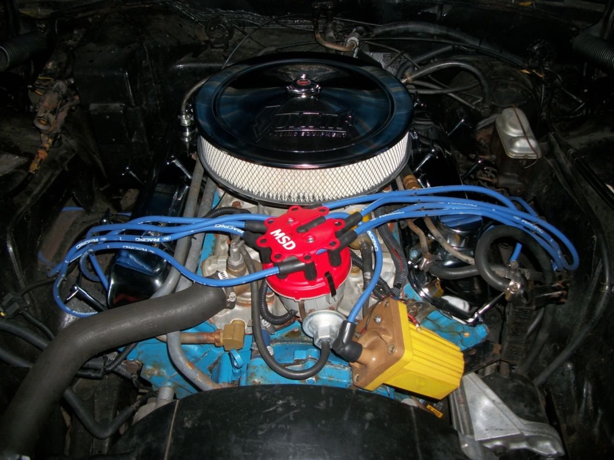

well it's dark out now but the flash picked her up good enough for now for ya.
she's a fresh reman and running smooth as silk.

daytime pic.hooked up my ballast resistor for coil and dual return throttle springs.she starts issue free through the resistor and runs great.
