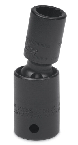

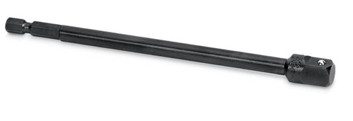

Two things: Fender well and 13mm flex socket. You can get at those bottom buggers in the rear (closer to the firewall) quite easily through the fender well with a 13mm ratcheting combination wrench. I use a 13mm flex socket on my Milwaukee driver drill with crazy-long extensions from the top. I can get every bolt on the VC with the driver, but I have to switch to a deep socket with a universal on those stud bolts.

Rich, I cannot read the manufacturer of the socket from the picture. Could you help me a bit? Is it SnapOn? I have a set of the floppy headed ones. This may work better.

Snap-On has them - I bought Armstrong. They don't flop around (yet), so you can "aim" them when approaching the bolt. They are specifically designed for the battery-powered impact drivers that everybody buys now. Don't forget the impact extension set:
