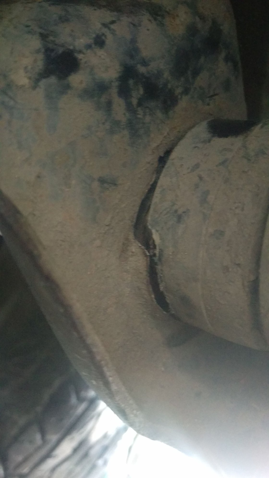

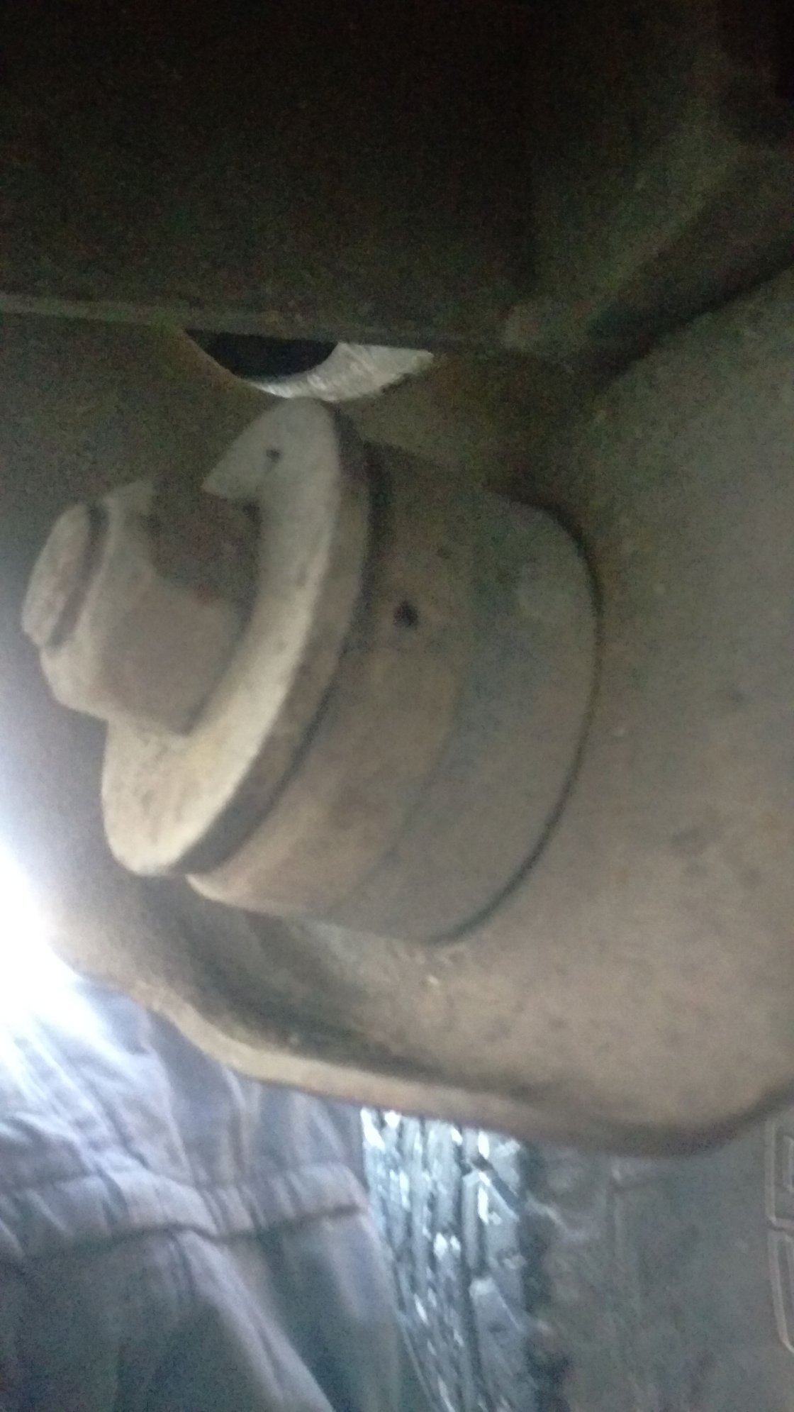

SOLVED-ELIMINATE THE RADIUS ARMS/BRACKETS/BUSHINGS FIRST!!!
Figured out it was my radius arm bracket/bushing. I'll attach a picture of what it looked like. I know this is it because I put a 28mm socket on with a breaker bar and wheels on the ground and the radius arm moved up n down about 2" each way 😨
Driver side 👍👌
Passenger side 👎😨💀 <br/>When i took off the nut (twisted off with the bolt ...so i have that to replace now too 😒 ) part of the piece thats closest to the bracket where the gap is, about a tgird of a circle of a piece, fell onto the ground.
