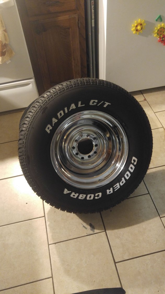

got my first set
Here we go. Only bought 2 so far. Taking my time. But this will solved the 1 bent rim and allow me to use the other old wheel as spare. Plan to order my front wheel set up within the next 2 weeks or so....maybe longer as it is Christmas time. Got the smoothie caps coming in the mail now.

Nice, I like the smoothie type wheels. I think early cars and trucks look better with original types. My wheels are black powder coat because I hate cleaning chrome LOL

Tires and rims... in the Kitchen, eh? She's off visitin' her sister or sumthin'?

Early Christmas present fRom my girl. Got home late last night and was super stoked to come home to them waiting for me....even though they were in the kitchen.hahaha
