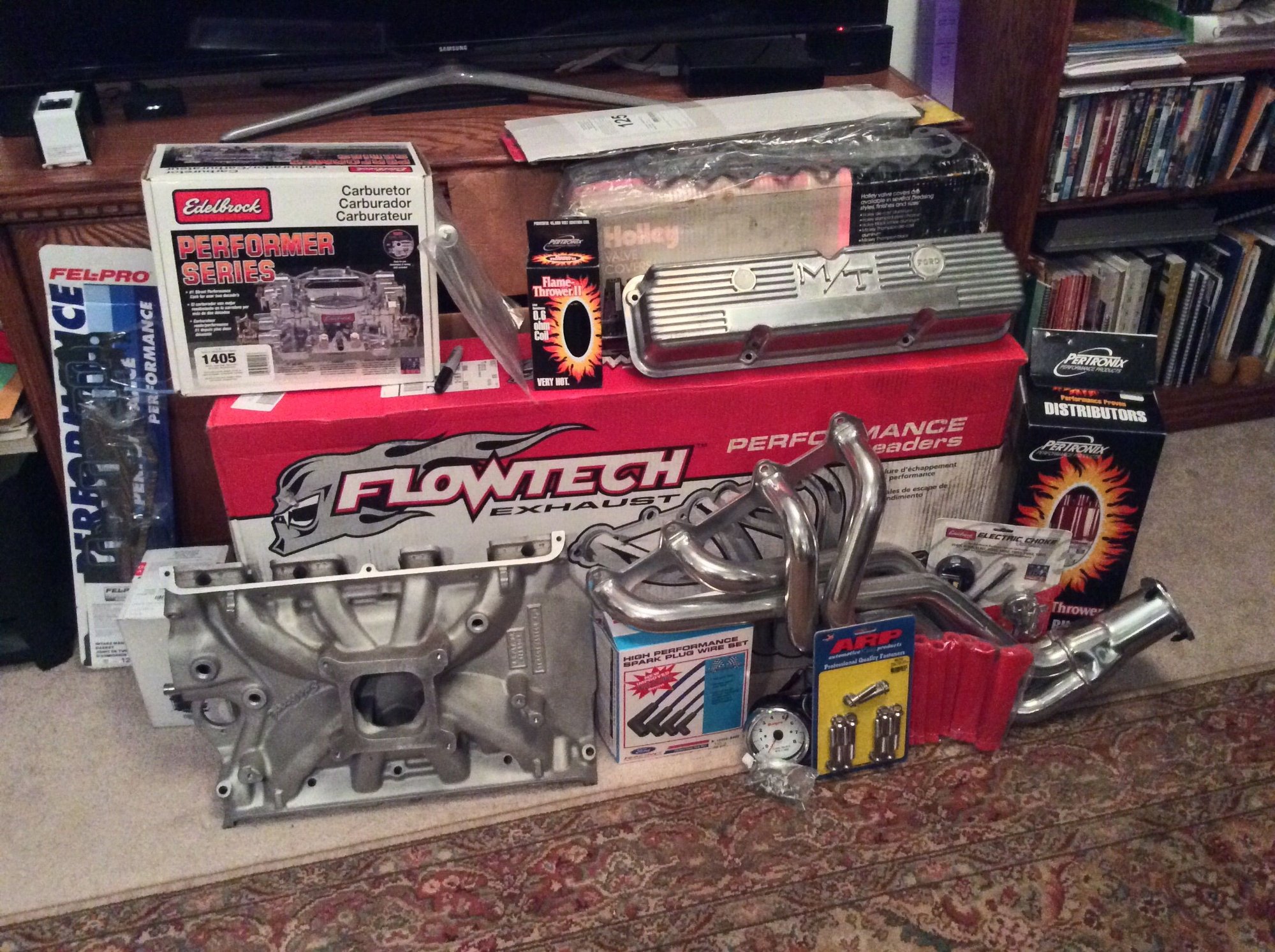

WELL, that is not good, I was planning to put manifold , carb, distributor, coil and headers. Guess I'm going to do a cam, and timing chain as well.

Will this work have a Performer cam on the way, If I get 2 mpg more I'd be happy
