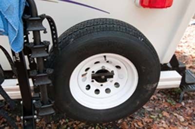

I recently went from this
Tire on rear bumper

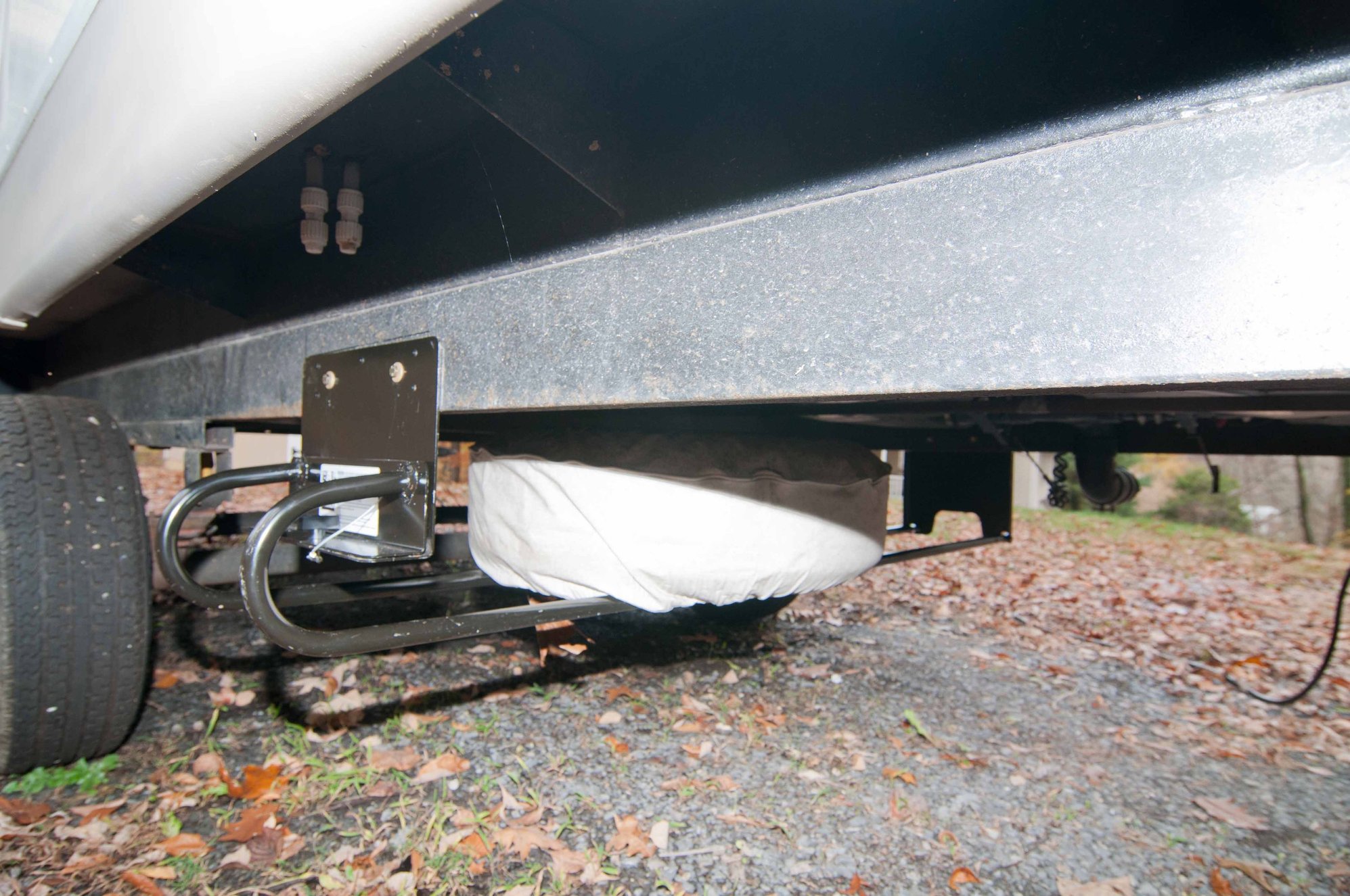

To this
Spare under fifth wheel ready to slide up into place.
The Hide-A-Spare kit is an easy install and, if you have two people, which I did not, it should take less than 30 minutes.
Since it does not come with mounting hardware, other than for the spare tire, I used grade 8 5/16" bolts from Tractor Supply. I also changed the bolts that mount the tire from 5" that comes with the device to 6" to have more purchase for the nut.
Like much of what you buy for RVs, the corner cutting on the Hide-A-Spare is obvious, in my opinion. The tubing is not particularly heavy and sliding the spare up into the rack takes some effort as it means sliding metal into metal. It would have been nice if the manufacturer has used teflon bushing or something similar to make the sliding in and then lifting up easier.
Overall, however, it all seems to work and hopefully I will not have to get to my spare very often.

Maybe just the picture but it appears like the rolling tire might hit the carrier if the suspension flexes up while moving?
I take it there must be adequate clearance...just doesn't look so.
Also, is it wide enough to to hold 2 tires if possible?

The trailer tire is 20" from the closest point on the bracket. There is room for two tires, but you would have to weld on a mount for the tire to the support like there is for the first tire. Some folks are putting their blue tank under there with the tire. I tried doing that and it fits, but I have not worked out a way to secure it that satisfies me yet.
The Hide-A-Spare is limited to 100# according to the manufacturer.

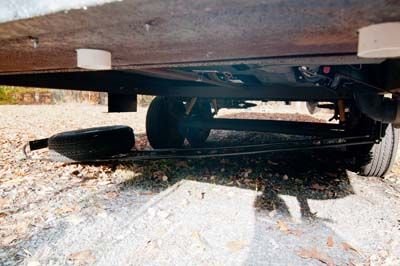

How do you check the air pressure on the tire? Creeper and a gauge?

that would be the way. or just crawl under there.
I suppose the smart way would be to position the valve as close as possible to the outside of the trailer.

Just unhook the rack, drop it down and slide the tire out. It is not that hard to do. Maybe would take a minute or two. It takes longer to unscrew the lock **** then it does to slide the bracket out. This is not a big deal. Take a look at Youtube to see how the Hide-A-Spare works. There is never any need to crawl underneath to get to the tire. The bracket holding the tire releases with a ****, then drops down, and slides out. I would lube the bracket a couple of times a year to make sure it doesn't stick.
