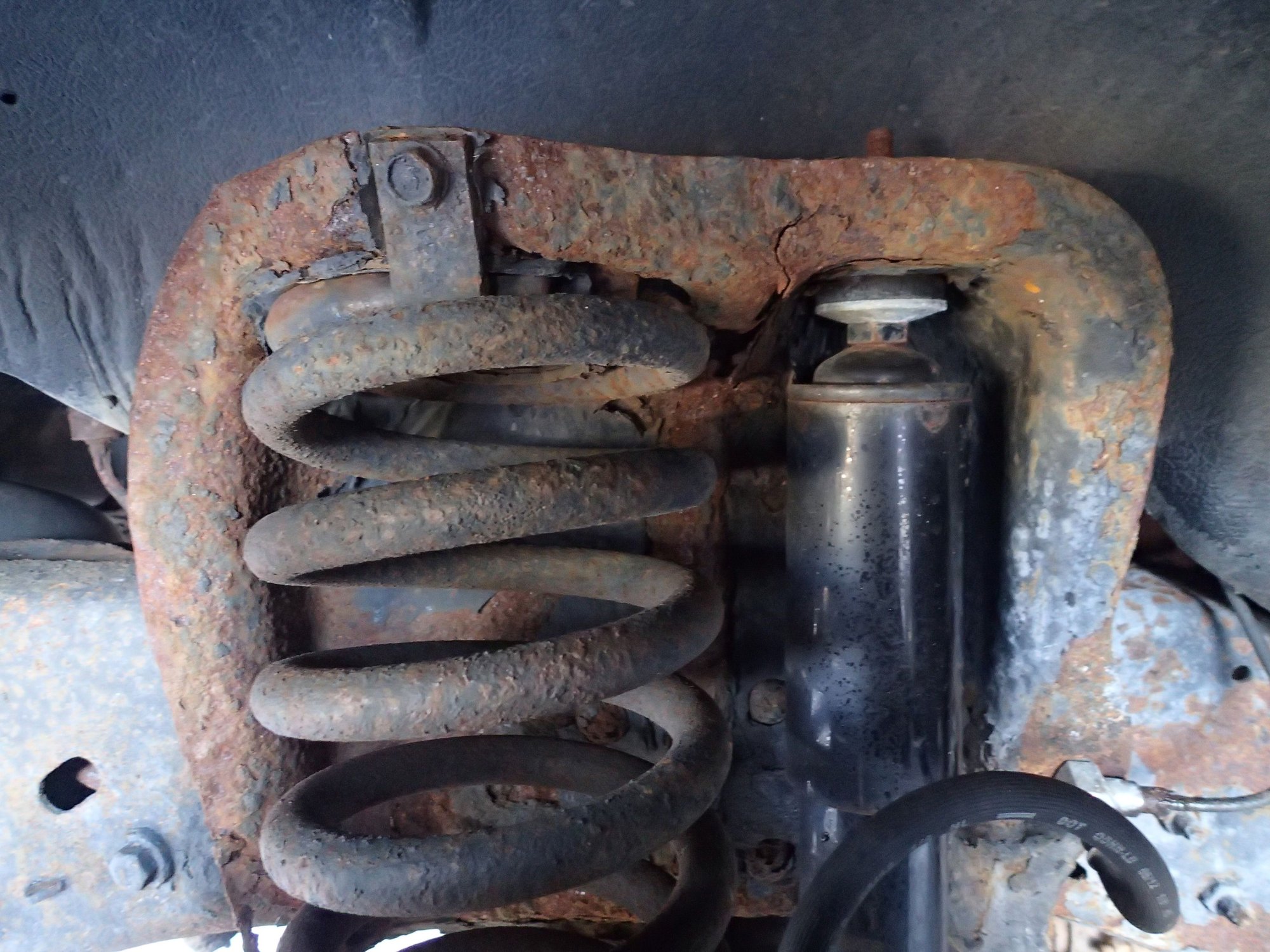

Front left shock tower. All the time I was looking at the front right wheel area.

Damn son. That may cause a little wander

Ouch! That whole tower is paper thin.
If I were you, I'd start inspecting other areas of my truck for rust as well. Front/rear hangers,

The thing is that break doesn't really look new. I would keep looking.
Also check the radius arm bushings. I had an Explorer that those were shot in, it made strange pops and thumps while turning. The transmission quit shifting into overdrive, then the dang thing caught fire after I used it to move a welder in the lot before I got around to fixing it.

Yup. She is a bit rusty under there. Here is a picture from last year. What a year can do huh? My goof was to keep checking the passenger side for the problem. Anyhow, just need for my truck to get me through a couple more years until my daughter graduates from college.
