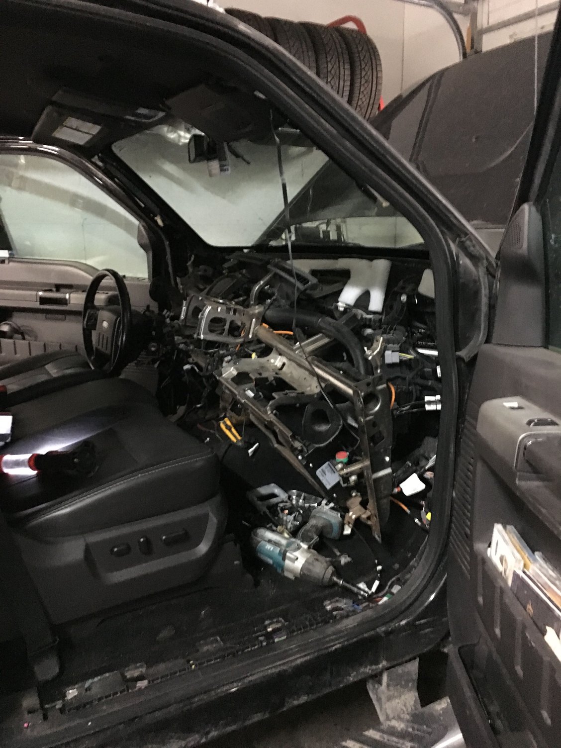

Hi Folks, Feeling a little defeated right now and looking for some support to help me get through this. Here's the issue - my defrost is isn't working and as per TSB 13-2-9, the heater plenum and blower unit need to be completely replaced. I'm probably the first numbskull to try this on my own so figured maybe we can make a bit of how-to out of this thread. Anyway, what I have done so far is remove the dash and unbolt the dash bracing. I'm trying to remove as little items as possible so that I don't have to remove quite as much wiring. Anyway, I can now see most of the heater plenum and removed the top bolt and nut over by the defrost unit. But the damn plenum still won't budge and I can't see any other nuts or bolts holding it in. Keep in mind I haven't removed the coolant hoses as I wasn't sure if I would have to slap it halfway back together to take it somewhere so they could be holding it down somewhat but I would think it would at least move a bit. Is there a trick to this or something? Anyway, please please please someone help me figure this out!? Thanks! JC

This is where I got to so far. Ugh.

WOW that don't look good
I believe you need to access some of the bolts from the outside by removing the RH fender splash shield.
Good luck!

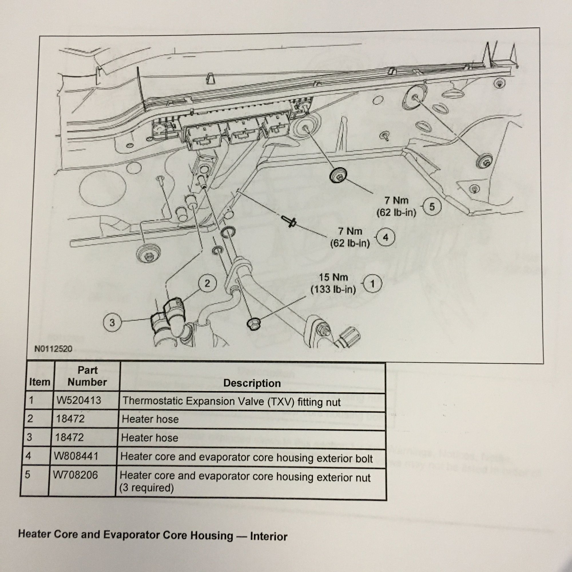

Yup, you're right. Some time consuming searching turned up this:
