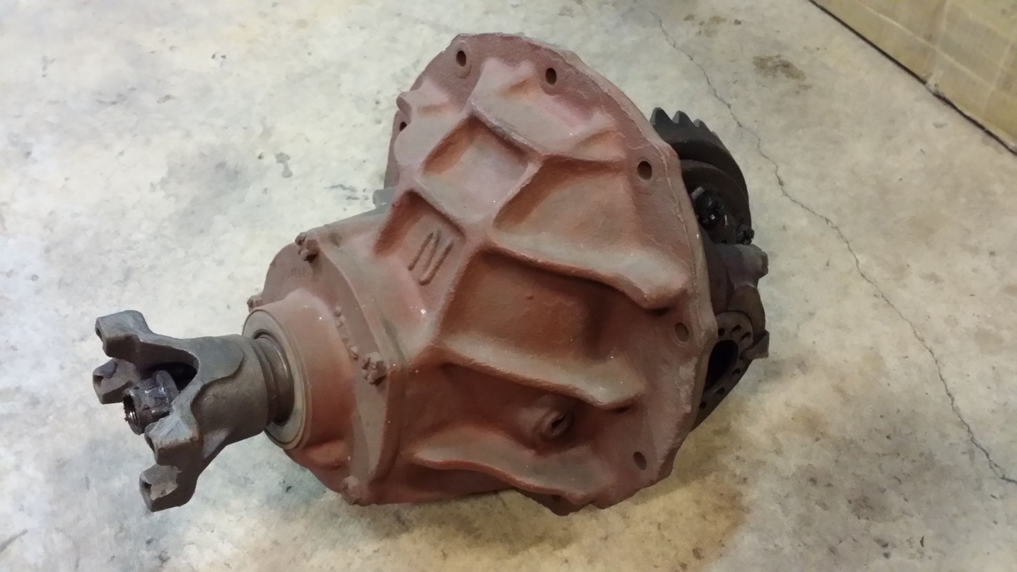

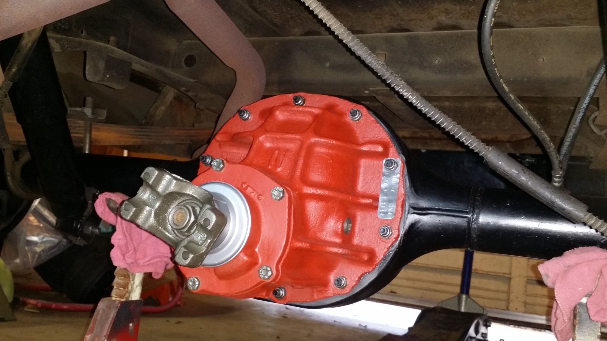

The problem with the gray iron 3rd member failures in the Big 427 powered Galaxies was resolved with the case revision to the nodular iron 3rd members. C2AW-A or C4AW-B case. N-cases prior to 1970 will not have the large "N" on the face of the 3rd member.
I put a factory '75 D0OW-B 9-inch N-case in my truck. --Daytona pinion support, 31-spline 4-pinion Traction-Lok differential with 3.50 gears.
After I cleaned it up.
My '69 C7AW-E single vertical rib 9-inch 3rd member the N-case replaced.
