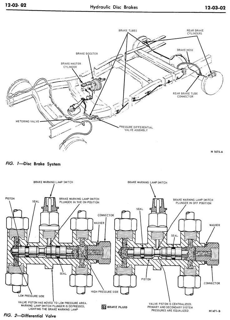

Seems like since you tried the push or pull the pin on the end trick with no luck. And just could not by pass the light buy jumping the switch plug?? (NOT the preferred technique).
Advanced search there is a thread that cover an in depth pro valve rebuild, I have no luck finding it....but I do remember it.
And maybe these pics and info will help? But probably not since this is not really what you have.

Its similar to the pic that 77&79F250 posted, although mine has 5 ports not the 4 his shows(also 77&79F250s pic and the posted diagram next to the pic do not match)

I never said the pic of the actual one did match the diagrams. I was posting the diagrams hoping they might help show what might be inside yours, that is all.
Sounds like you have a handle on it now, congrats.
