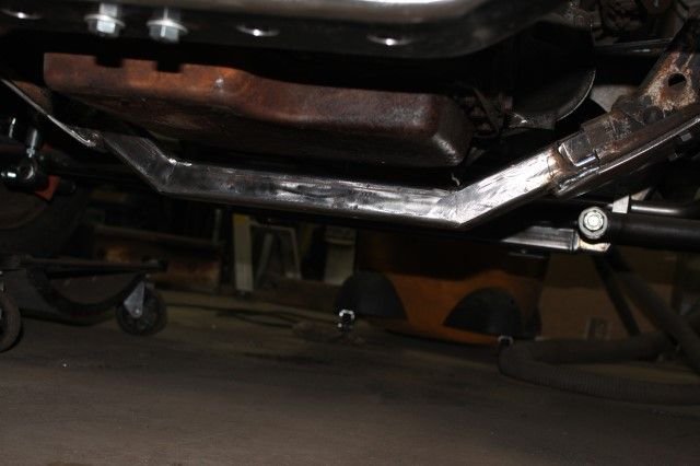

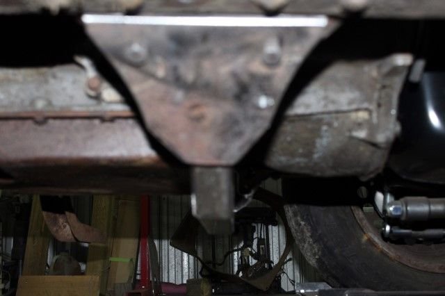

Not knowing how the 47's are set up but on my 56 I cut the cross member out leaving enough to bolt back in a modified version of the member in case of transmission removal .

The original transmission cross member that holds the trans also holds the brake and clutch pedals. So another problem is created. Possibly a brake pedal could be mounted in the cab with the master cylinder on the firewall.
