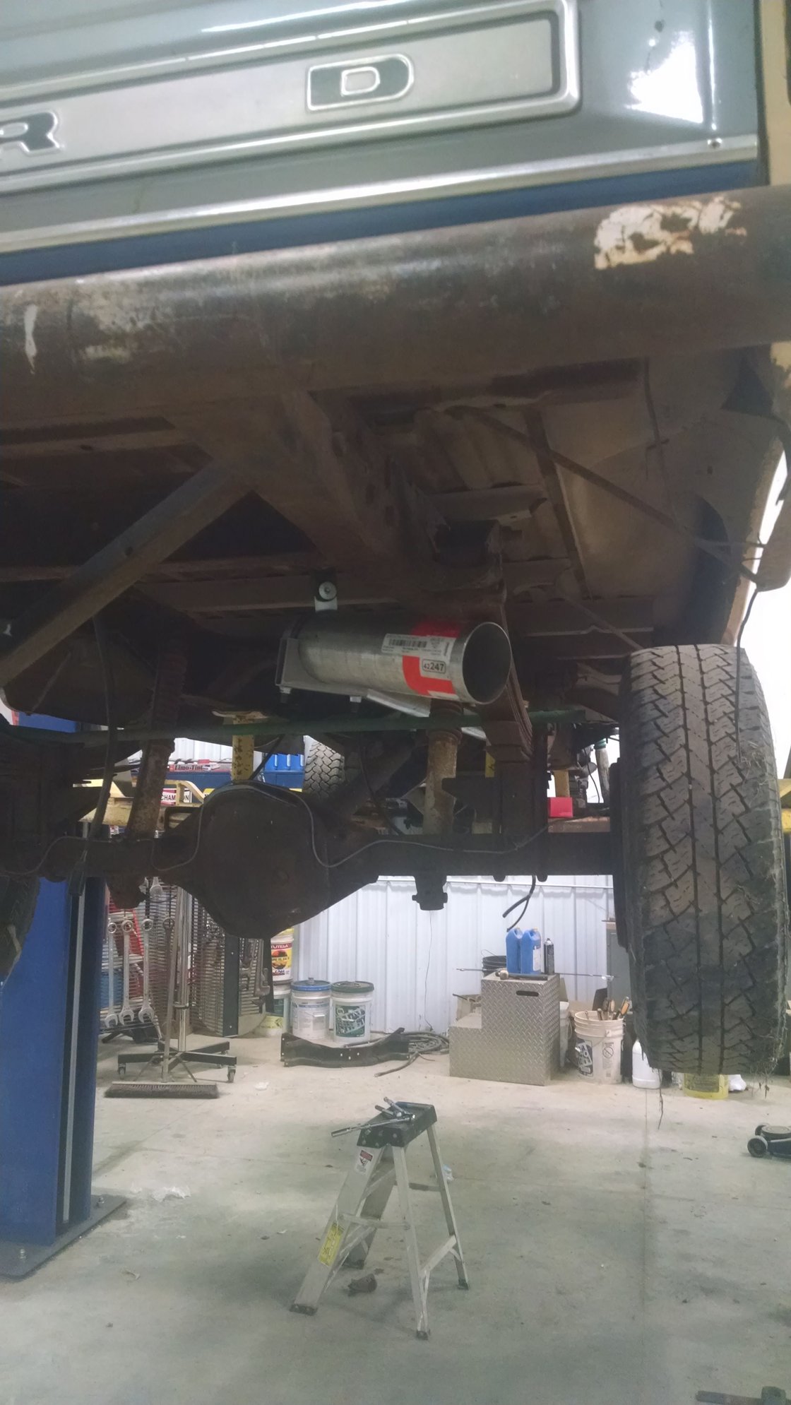

I went to napa an picked up a ten foot stick of 4 inch exhaust pipe. Along with some elbows and hangers.
The next three pictures are of the exhaust when it was finished. It is fully welded and goes from 3inch at the downpipe to 4inch the rest of the way.
